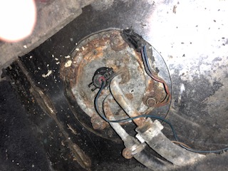

I’m pretty sure I’ve found it. I’ll attach a pick if I can. Wiring loos very odd though. One wire going to the centre and what looks like a reciprocal connector laid to one side with two wires connected to it. Something doesn’t smell right here. Is this how it’s meant to be?
