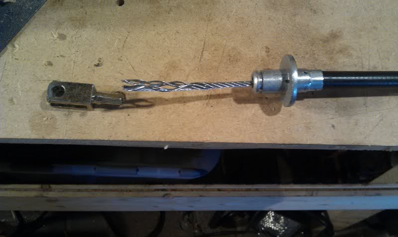

Went for a bit of a drive round Nottingham and derby, was all going well until after about 65miles the clutch cable snapped at thevpedal end. So we limped home in 2nd gear and now we have to wait til Tuesday for gbs to open again so we can get another cable.

Don't think they will sell what we need as the pedals for the zero are not standard sierra pedals so not sure if it will have the right connection to the pedal on the cable.

I bet you did what i did, you need to notch the pedal out for the clevis to fall into otherwise it bends up stressing the cable and SNAP! i have one here spare if you want slightly melted outer but good enough to get you going till gbs open

Hi,
we did not notch the pedal out for the clevis to fall into as you say.
If your cable has the same connections as the picture below (obviously not broken
Many thanks

Many thanks Dan for the cable. Car is now back on the road and running again. Been out all afternoon enjoying it!!!
Again thanks for the help and advice.
