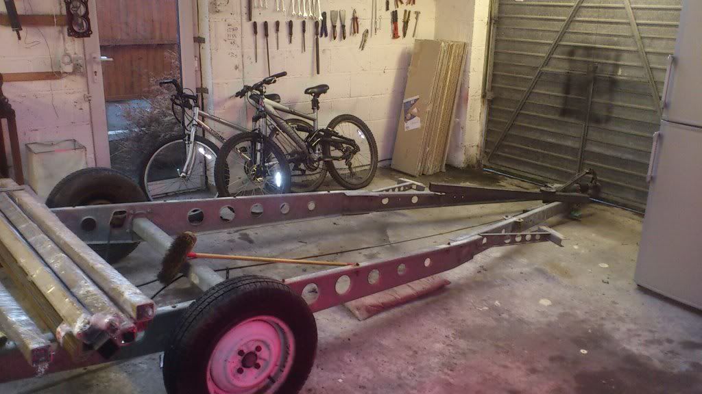

Below is a picture of what I'm starting with. The next time I get to spend any time on it will be on Monday night, and I should have more to photo!!!
Posted Image
Posted Image

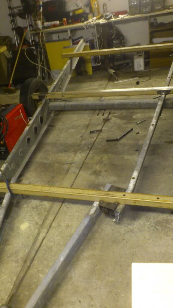

Posted Image
Tow a-frame now shorted by 18" bolted and welded back onto the chassis (addition support to be added). The main cross supports are now positioned and tack welded onto the chassis.

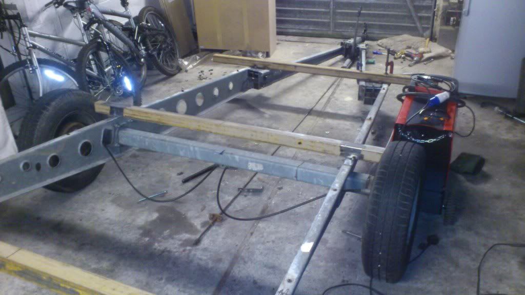

Posted Image
Posted Image
