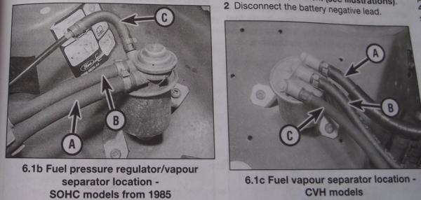

Ye I got the fuel lines sorted, but on the fuel pump there is also a smaller pipe, I'm putting a pipe off the crankcase to a catch tank
I haven't seen a sierra mechanical pump with three pipes, sorry. There was an ally regulator/vapour separator fitted to carb sierras which had three pipes. They are normally binned and they're not bolted to the block like the pump is.
Nigel
The pump Is bolted to the block just behind the base of the distributor.
The vapour separator is bolted to the inner wing and not the block in sierras and looks like the pic below.
Picture copied from Haynes manual.
Nigel
Guest danny_samb
Yes, there is a fuel pipe going into the bottom, 1 coming out the top then on the side there is a little pipe about 6mm diameter
Guest danny_samb
It is definately bolted to the block, just been reading that it's a pressure regulator to push fuel back to the tank, as I'm using twin 45's there won't be a return will they, I have a pipe for a return do can I connect that pipe to my return pipe, or buy a pinto fuel pump
