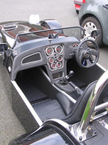

I've done a similar thing with my exmo, except I made a leather dash (onto MDF) instead of carbon plastic (the carbon plastic will look ace!).
I've got a cluster of 5 gauges in the centre of the dash, and two larger gauges either side of the steering wheel, along with 6 warning lights and a letter-box hole which was used to house a sterio in front of the passenger. Basically I cut away the metal dash wherever it was needed and I've never had any problems.
I would suggest to cut what is needed to be removed (don't just cut it all away for the sake of it) and never cut right up to the bodywork, leave at least a 50mm metal dash boarder. Finally, if you end up cutting out any square shaped holes, you must radius the corners of the holes (at least 5mm radius) to prevent any fatigue crack from starting.
I would estimate that I cut about 20% (area) out of my metal dash.

Any possibility of a couple of pictures of your dash? Just so I get an idea of what they look like with dash to the right anyway?

Very nice ! If you can do that with no adverse effects then my project is no problem. A lot of the warning lights / switches as I said are going in the existing slots and the 2 large clocks in the existing holes also. Fog light switch (illuminated combined warning lamp type) is going in it's original poisition, r/hand side between steering wheel and "door", the radio aperture is staying as is, just hope I never need to retune when on the go as that is over to the left.

Hi Brian,
The leather dash was really easy. Once I'd cut the wood to the desired shape / size, I sprayed it with contact adhesive and stuck some 4mm thick foam onto it. Once the glue was dry, I the trimmed the foam to the wood shape and then stretched the leather over and stapled it in place on the rear of the wood.

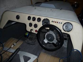

And finally the dash pic below which I wish was mine belongs to one of the locost boys. I hope he doesn't mind me showing it to illustrate what can be done with skill, care and flair. Its probably the best seven dash I have seen!
Nigel
