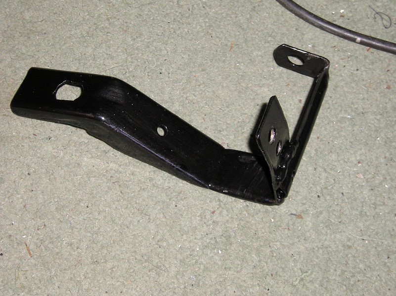

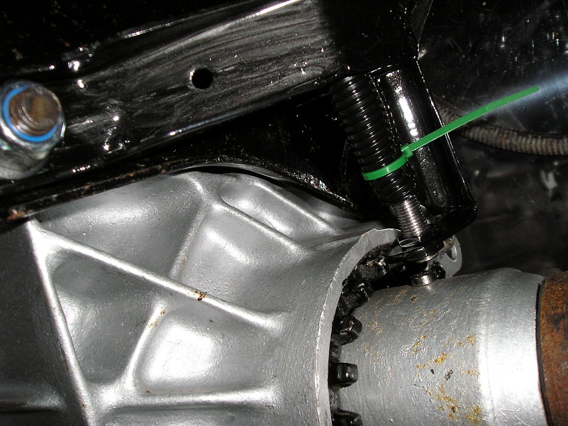

The bracket was fitted to the diff. Don't think mine was stainless but (from memory) it was approx 4mm plate. I went through several different designs (and if I'm honest, my first attempt was an absolute pig's ear) .
On the S7 I have another electric speedo (not ETB) and i used magnets. By then I was trying out welding so i butchered and old ford bracket - see pics - and connected it to the diff (with magnets on the driveshafts)
