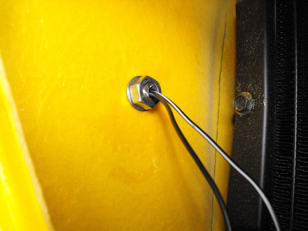

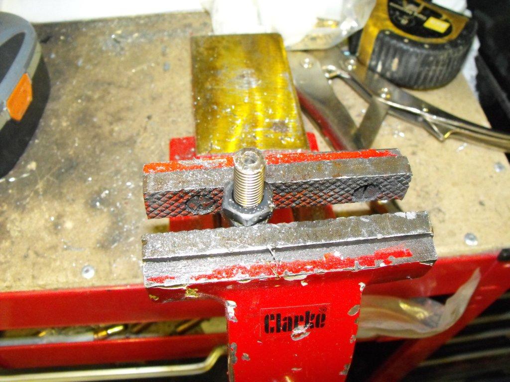

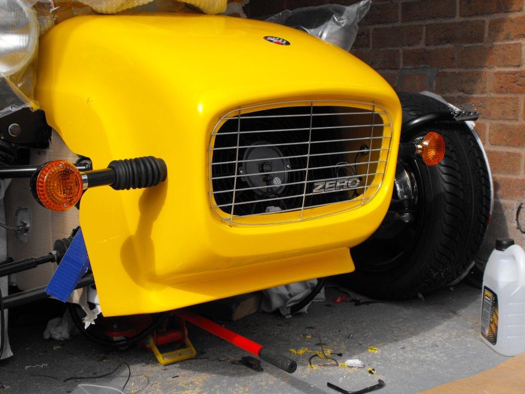

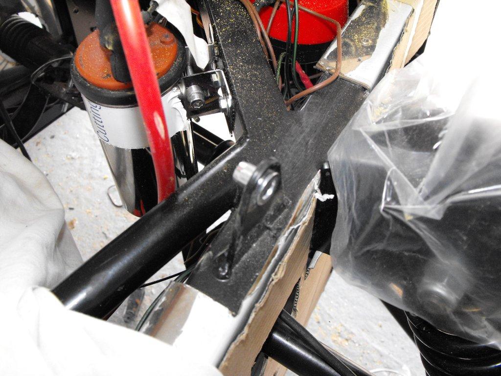

At this stage I decided to fit the nose cone indicators using the GBS supplied lights and spacer.
I did not want wire everywhere, so I bought some threaded bar and drilled through the centre to feed the wires through, looks much better.
post-4145-0-47646200-1399810911_thumb.jpg post-4145-0-61833600-1399810933_thumb.jpg
Used some gaiters from a car-boot to cover the brackets and wires. I fitted the grill by drilling four small holes and secure it using the metal insiders of a terminal block.
I really do not like these lights - first job after IVA, replace front indicators.
Suggest fitting some large s/steel penny washers each side of nose-cone mounting if these are to remain on car whilst looking for better replacements.
They will be replaced on Saturday I will also be fitting the screen and wipers.

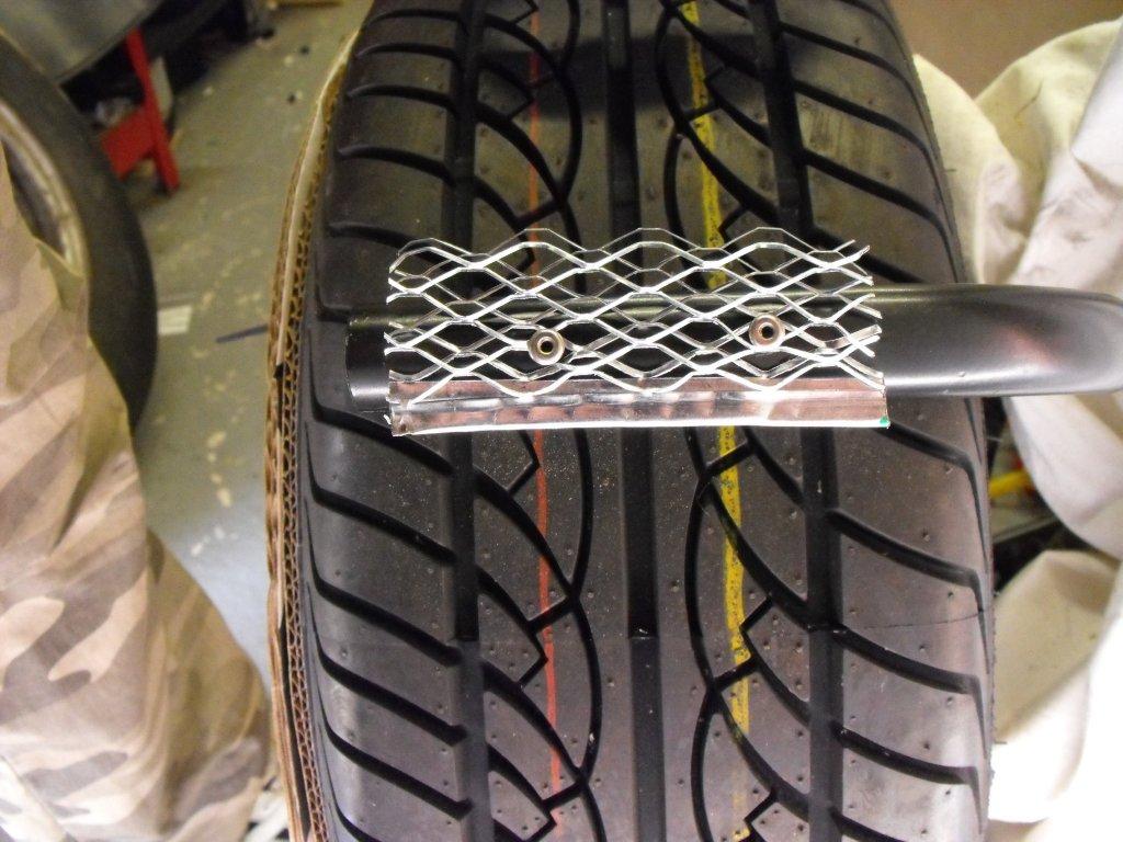

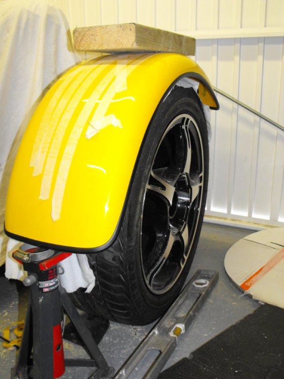

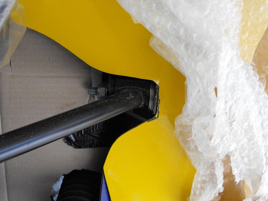

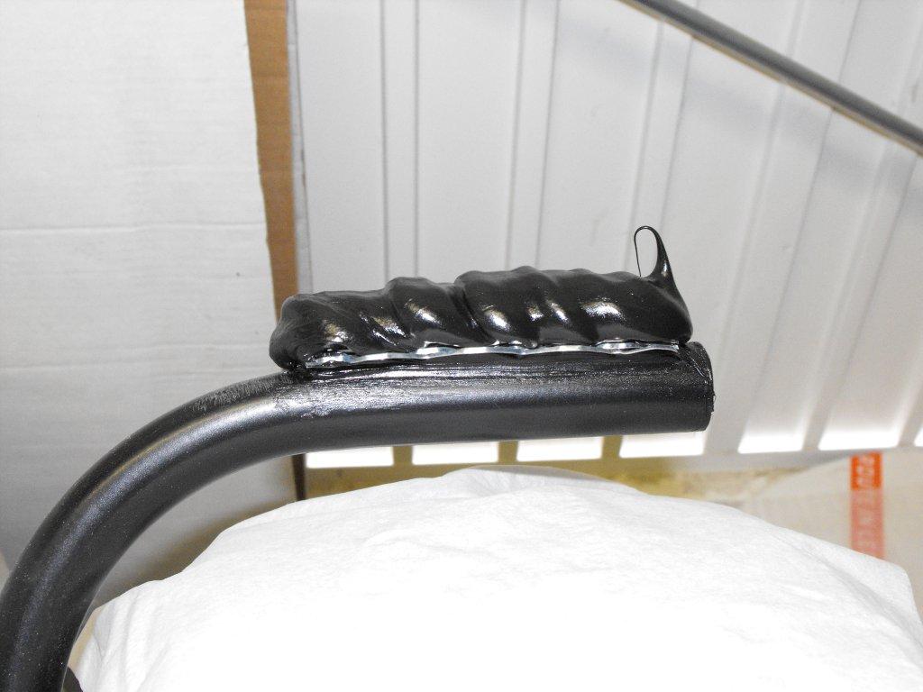

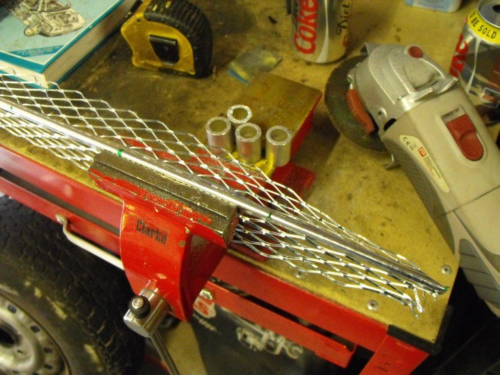

Front wheel arches, nicked the idea from Nick (shaft) and used some galvanized plaster edging stuff and silkaflex adhesive. First I cut a piece down to fit inside the wheel arch and used 4mm stainless steel rivets.
post-4145-0-15882600-1399927376_thumb.jpg post-4145-0-61880100-1399927393_thumb.jpg
I then added a huge amount of silkaflex and placed the wheel arch onto the supports, the axle stand was set at the right height for IVA.
post-4145-0-68962600-1399927527_thumb.jpg post-4145-0-69867600-1399927545_thumb.jpg
Once in the right place I started to spread the excess silkaflex under the arch and mounts. Only time will tell if this is going to stay on.
If you abraded the inside of the arches and degreased thoroughly Mark, they'll be going nowhere mate. :)
Thanks for the recognition by the way. :drinks:
Sikaflex I swear by; it'll stick anything to anything (within reason) :)
Cleaned and course sand paper, then cleaned again.

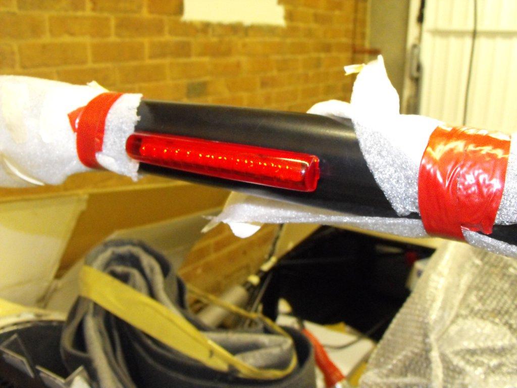

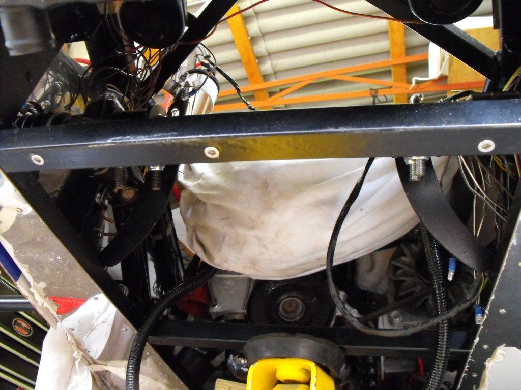

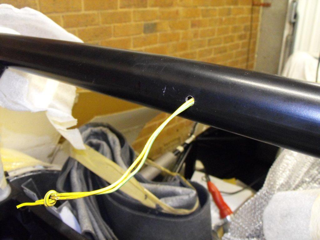

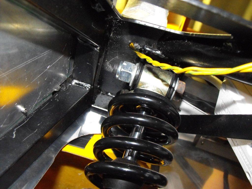

I followed a kit car to Newark once and thought that the brake lights were too low on the rear arches. Other cars did not see them brake, especially the Chelsea tractor brigade so I decided to fit a high level brake light. Nothing to difficult a simple 5 LED light wired into the brake circuit.
Fitted through the roll bar from the under the suspension top mount.
post-4145-0-27323000-1400008569_thumb.jpg post-4145-0-22899300-1400008585_thumb.jpg
The finished light.

OK. I give in. How did you manage to thread the wires through and get them out of such a small hole?
Vacuum cleaner --- idea borrowed from IKB ??
out of the box thread them into the hole ???
Same size hole each end Ian --- how to join in middle -- magnetic electric??
It was very easy, I used a piece of copper wire (earth wire) fed it into the bottom of the roll bar and then used another piece of wire to fish the cable out. Once it was through i taped the correct cable and pulled through, simples.
I thought it would be much harder, but no issues.
