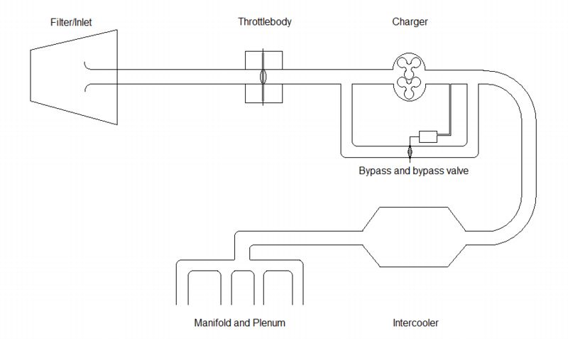

Without knowing the design of your system it's difficult to say. Position of components, position of bypass and where the bypass vacuum comes from. Can you draw up something like the pic below (fairly standard Rootes setup) to give an idea of yours.

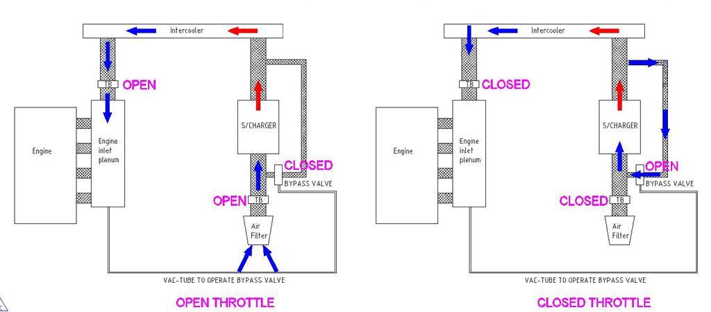

Nigel, set up is as per this diagram being the bypass is located on the supercharger intake and the vacccum feed for the BPV come from the engine plenum.
The only difference with Dan's set up is that the BPV recirculates the air before the intercooler and not after the intercooler as shown;

The two throttlebodies have surprised me. Haven't seen that before. Will have to have a think about the effect of the TB closest to the plenum.
Let me ramble a bit! I suspected the difficulty in light throttle was taking the vacuum for the BPV from the plenum which would tend to have more rapid variation into negative pressure due to low local volume and being close to the bit doing the sucking. The effect of having just the first inlet TB is to slow down pressure changes (including in the plenum) downstream of the supercharger giving a slower response time to throttle change, both on and off power. A loss in snap throttle and low revs pressure build which hits performance slightly. But perhaps gives a smoother drive?
Is the second TB to mitigate the slower pressure build allowing a partially pressurised system up to the second TB even when off the throttle. I don't think Rootes type chargers need that as their output is good even at low revs. I definitely think the problem of sensitive throttle at cruise 70 is due to the second TB making the plenum a small rapid changing pressure space. With a single TB I would put the vacuum takeoff for the BPV just after the supercharger. With your setup I don't know where to put it.
Experimentally, I wonder what would happen if the second TB was locked open and Dan just ran on TB number one?

Had some very interesting reads on Miata dualTB.
Seems to be a solution for problems encountered by those who have a single intake TB setup like in my first diagram. The problems are mostly to do with getting a stable idle, avoiding snap close throttle stall and a stumble on snap opening of throttle. Not clear if the snap opening stumble is a lean stumble or just boost lag. The idea of dual TB seems to be to maintain some boost in the whole system except for the manifold even when the throttle is closed.
DTB have definite pros and cons., the cons having further potential solutions. All gets a bit more complicated. Most critical area seems to be the TB cable link and relationship between the TBs. Advice is to set the intake TB butterfly so it cannot close completely but the manifold TB so it can close completely. This relationship seems critical and takes some experiment to get the settings right.
Vacuum drawn from the plenum leads to rapid operation of the BPV and some have a restrictor in this vacuum line to slightly slow it down. However that can lead to too slow an operation of the BPV on snap throttle closure, high boost pressure between the charger and the second TB, high load on the charger and belt squeal and thus have to take the vacuum restrictor out. Solve one problem area and introduce a problem elsewhere. Some also talk of fitting an idle bypass valve round the manifold TB to improve idle.
No doubt those who have DTB fitted and problem free sing its praises. There are lots finding it difficult to set up. As I said the mechanical link and relationship between the two TBs seems to be absolutely critical.
