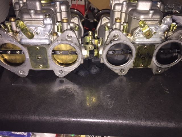

Check carbs with Weber fault guide with no success. Decided to take them off to strip and order inspect, I cannot see anything obvious.
There's a small lip between manifold and head but cannot see how this would stop the car from starting. Already sold old 40s so cannot test again.
Accelerator pump working so cylinders must be getting fuel. Now out out my knowledge and skill set, going to send carbs back under warranty and look out for cheap carbs to test everything else ( maybe bike carbs).
One thing to note there was excessive carbon on back off butterflies only cylinders 3&4, could this be something?

The back sides of those butterfly valves do look very wet. Have you tried starting with the throttle part open/fully open?
Also you set the throttle rpm on the master carb, and then balance the linkage on the connected one. Don't mean to teach you to suck eggs but it may be a simple set up issue.

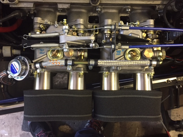

A few more pics of your set up would help
Going to set up with feeler gauge then refit, I will upload more pictures. Set up has not changed much from the last set of 40s except with the addition of a pressure regulator.
I have a Facet inline filter (new), Facet posi-flow pump rated at 1.5-4psi near tank, Inline filter, Sytec pressure regulator, set at 2.5psi (Eurocarbs suggestion) then carbs. For spark I am using Ford Edis, Megajolt and VVT pro (disconnected MJ and VVT, car should run on EDIS limp home, checked with Trigger wheels), and new Ford genuine spark plugs. I will take more photos and video when i fit them again.

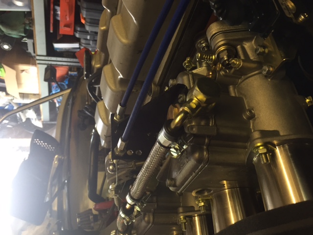

More pictures of my set up, going to boost battery tomorrow and start swapping HT leads.
