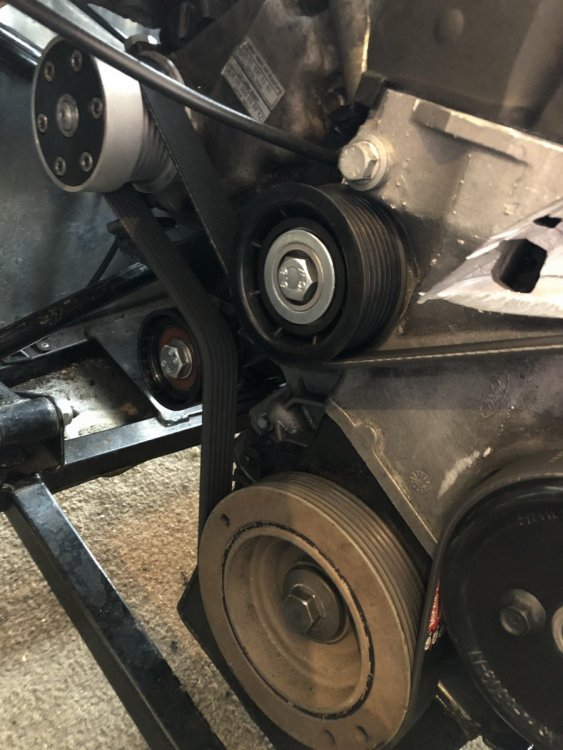

No, I’m using the alternator and top idler pulley to adjust tension - although that’s on the opposite side of the engine to the charger.
Rich from Red Seven messaged me last night and he thinks it could be belt slip so belt tensioner could be a good shout.  It just sounds really loud for a belt and I also don’t understand why it’s only doing it when connected to plenum.
Auto tensioner is a must. You'll struggle to get the belt tight enough without one and even if you did, if there's run out on any of the pulleys, the belt will squeal. In addition, a tensioner adds some damping effect between the charger and the engine to allow small variations in their speed.
It's due to the inertia of the charger. Even disconnected there's a rotating mass that needs to be sped up and slowed down according to the engine speed. The drive between the two is just friction and if the belt tension isn't sufficient, it will slip on the pulleys.
Big chargers on V8's often run a toothed belt because a multi vee won't transmit the power. In this case the drive is direct as the belt can't slip but it's essential to have some slack in the belt to take up shock loading. Usually this means being able to twist the belt 90 degrees at the centre of its longest length.
Edited by richyb66
Info added
  • Thanks 1
Thanks for your help, gives me confidence that it’s belt slip and explains what’s happening.
