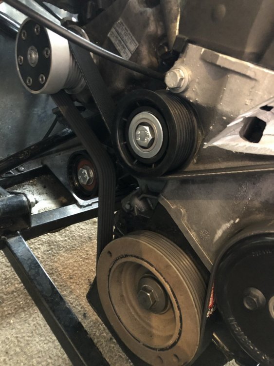

Hi,
I’ve been working on a supercharger project for my Zero.  It’s running on a Blacktop and I’ve spent ages researching, learning and now I’m stuck.
I made the bracket for the supercharger myself (with inspiration from posts on here so I really can’t take all the credit).  I also fabricated the inlet and outlet.
I am running an Eaton M62, it has a bypass valve and I have a throttle pre supercharger and the standard throttle in the GBS plenum post supercharger.
If I leave the outlet between the intercooler and plenum disconnected I have no issue; but clearly the supercharger isn’t providing boost.  I get no belt squeal and it sounds what I would say “normal”.
If I connect the supercharger to the plenum I get a very (and I mean very) loud mechanical squeal.  First I thought it was the belt or a pulley but I don’t understand how because disconnected from the plenum it works fine.
Any ideas? Just to clarify it’s a loud, really loud squeal.
Videos attached.  I am hoping it’s something daft.  I’ve already replaced the oil in the charger.  If the charger is broken that’s also fine but I want to be sure before I buy a new one.

No, I’m using the alternator and top idler pulley to adjust tension - although that’s on the opposite side of the engine to the charger.
Rich from Red Seven messaged me last night and he thinks it could be belt slip so belt tensioner could be a good shout.  It just sounds really loud for a belt and I also don’t understand why it’s only doing it when connected to plenum.
Auto tensioner is a must. You'll struggle to get the belt tight enough without one and even if you did, if there's run out on any of the pulleys, the belt will squeal. In addition, a tensioner adds some damping effect between the charger and the engine to allow small variations in their speed.
Consider one on a sprung arm if there's space. Compared to one built in to the pulley hub, you get a much greater range of movement meaning the belt length is less critical. Also the arms normally has a 1/2" square drive recess to move them making belt changes a doddle.
P38 Range Rover V8 is a good example
https://www.ebay.co.uk/itm/Range-Rover-P38-4-0L-4-6L-V8-Fan-Belt-Tensioner-Bearmach-Part-ERR6439/282617835102?fits=Plat_Gen%3AMK+II&epid=1134522428&hash=item41cd55ee5e:g:RawAAOSwrklU52jA
Mounting is via a single bolt and a cast lug on the back to prevent rotation against the belt tension.
Edited by richyb66
It's due to the inertia of the charger. Even disconnected there's a rotating mass that needs to be sped up and slowed down according to the engine speed. The drive between the two is just friction and if the belt tension isn't sufficient, it will slip on the pulleys.
Big chargers on V8's often run a toothed belt because a multi vee won't transmit the power. In this case the drive is direct as the belt can't slip but it's essential to have some slack in the belt to take up shock loading. Usually this means being able to twist the belt 90 degrees at the centre of its longest length.
Edited by richyb66
Info added
Thanks for your help, gives me confidence that it’s belt slip and explains what’s happening.
