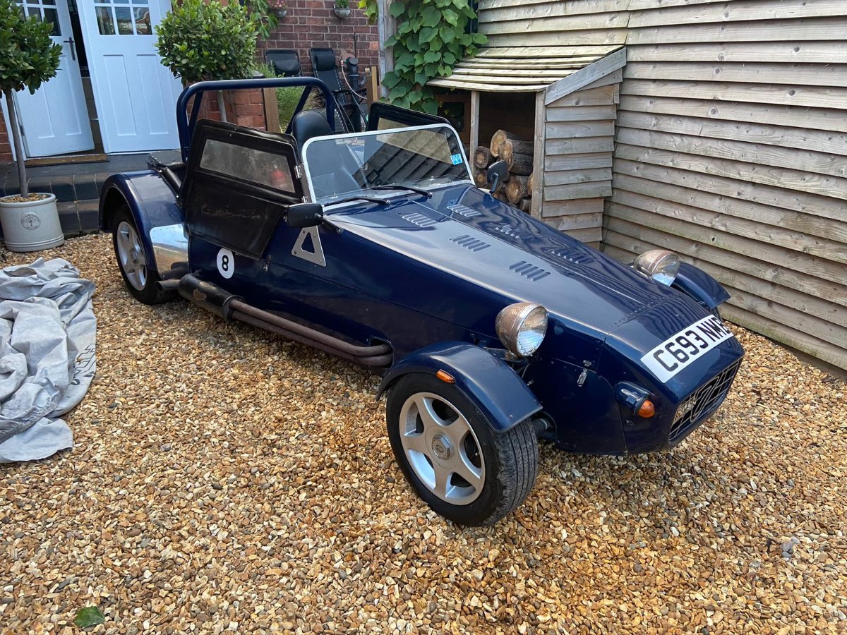

I wanted to show right from the start, so hopefully you guys can point out where I've been stupid and hope I don't prove wrong the old 'there's no such thing as a stupid question' saying
I'm no mechanic or have completed anything like this, have just had a massive love for these since a young age with my dad's Robin hood. So.. Here goes nothin'

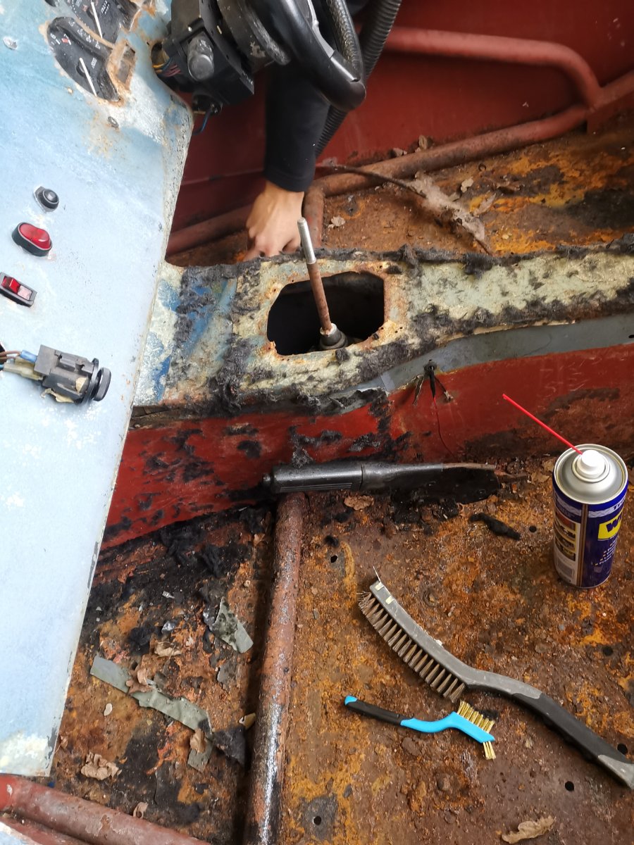

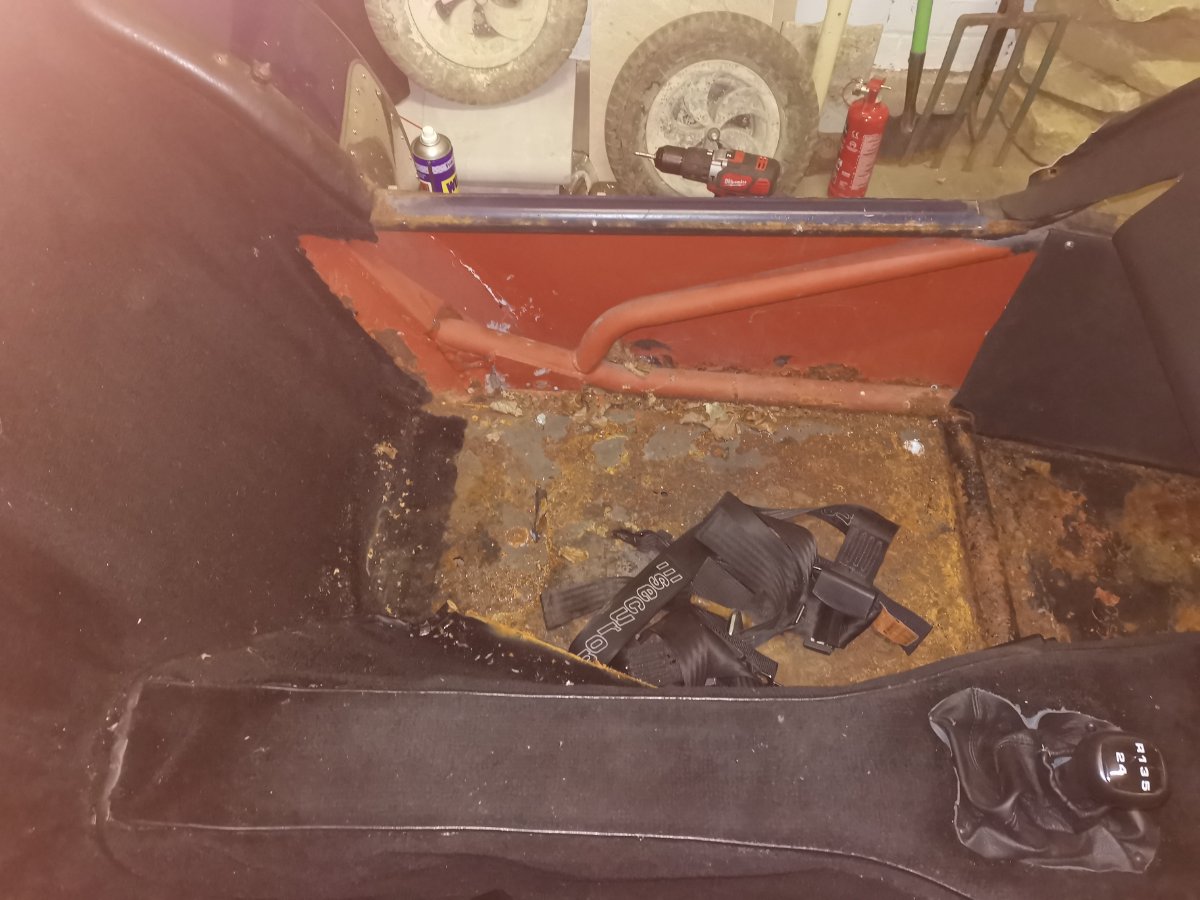

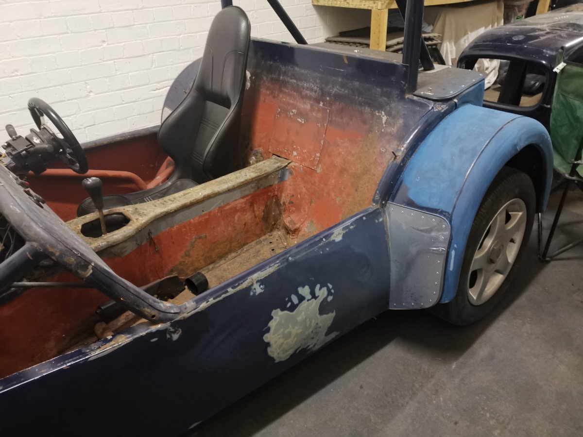

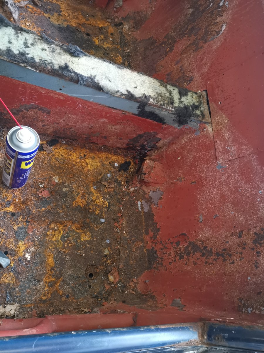

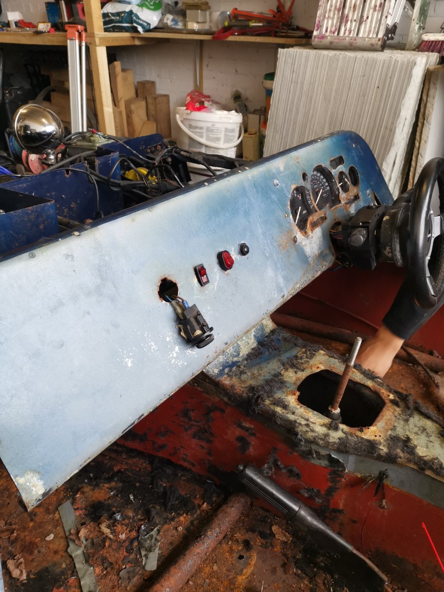

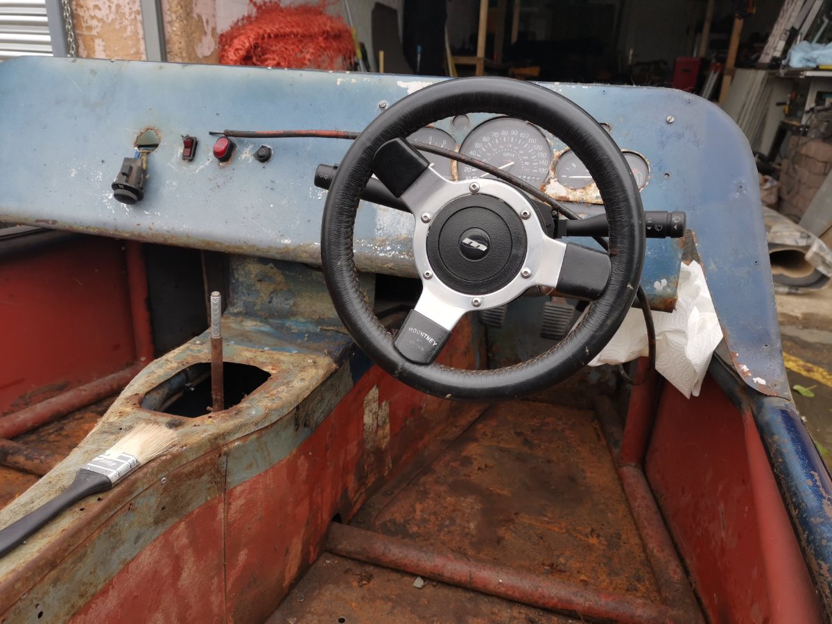

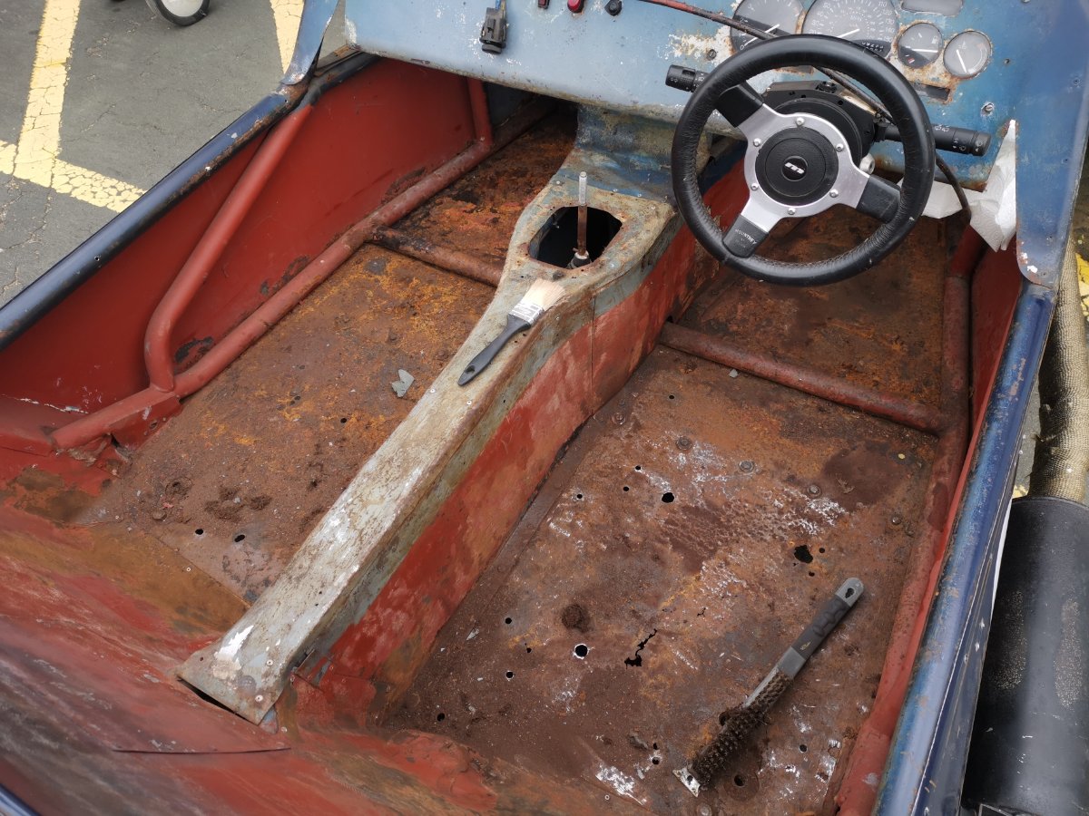

It does feel like a good base, just a bit more rust under the seat panels than had hoped for, cleaning it all back so can then start cutting out and replenishing

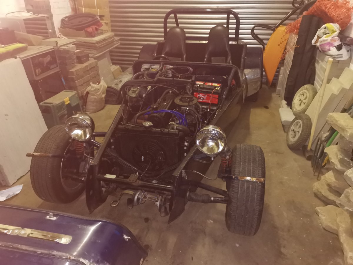

Small update on progress
I have Bob Archer from mobiletuning norfolk coming tomorrow to do a full test on the engine and equipment as it has a unknown race cam and various upgrades completed by iJem engines, we can then see what we're getting from the girl and plan next course.
The speedo cable is lovingly looking at me in the face rather than doing its job! Upon reading up I will cut a good hole into the tunnel.. Will this likely be able to fix back into the connector or would I need to get a new one ready for it?

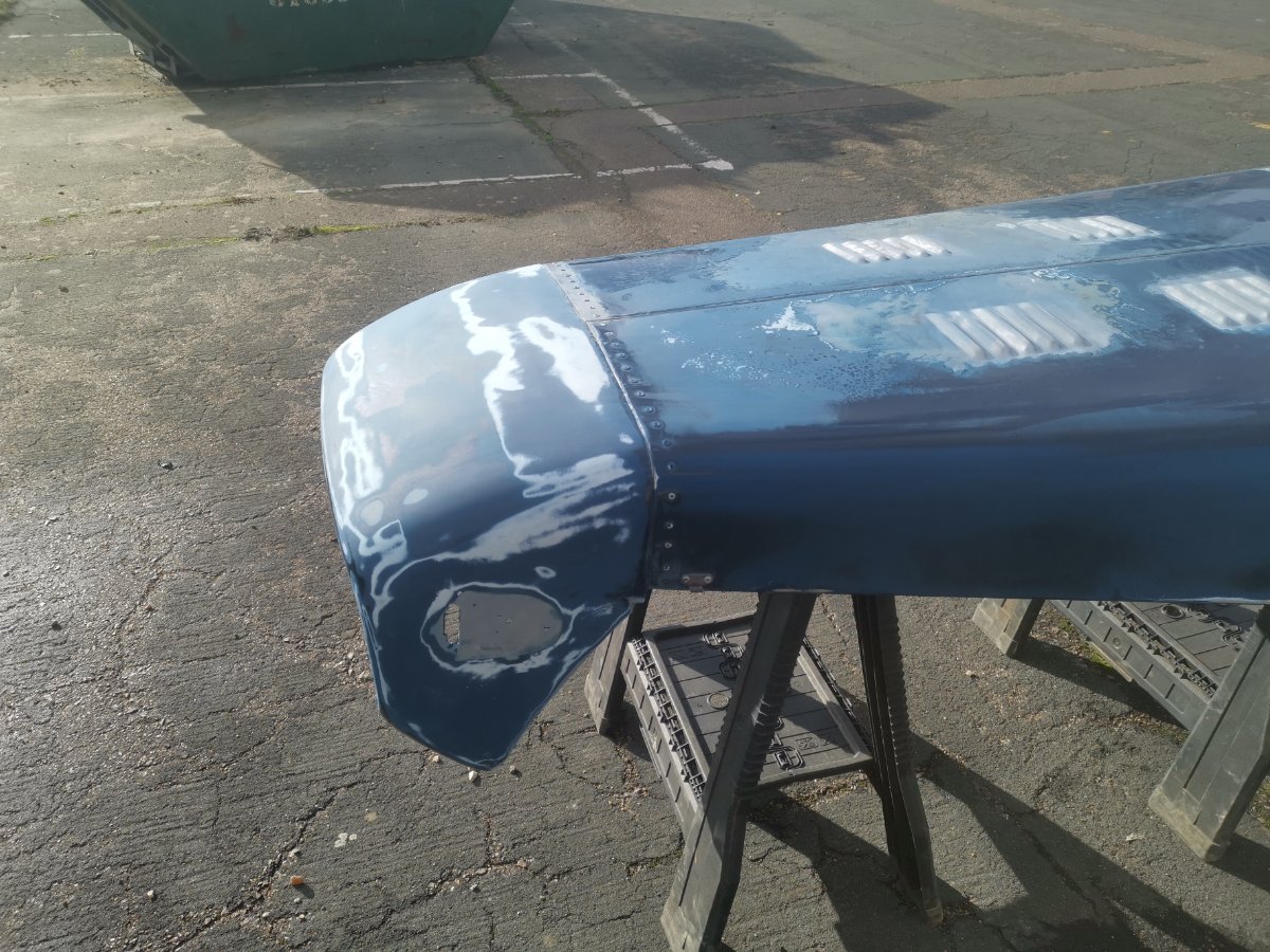

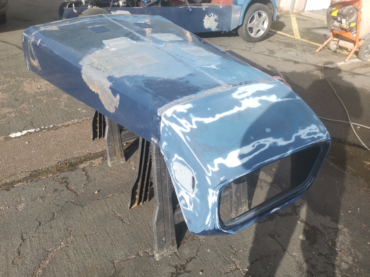

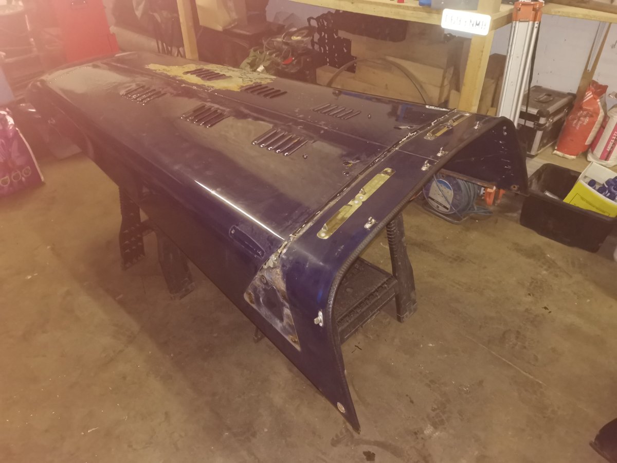

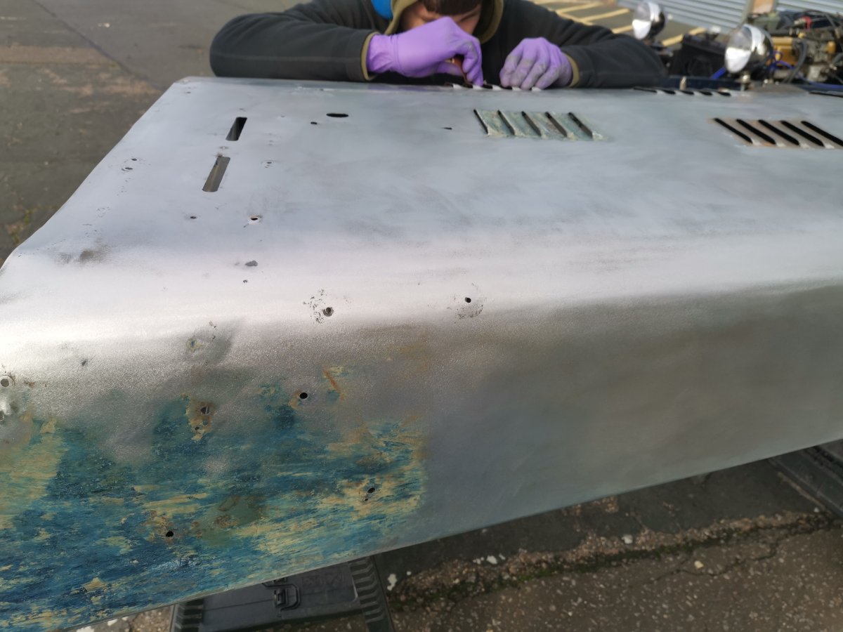

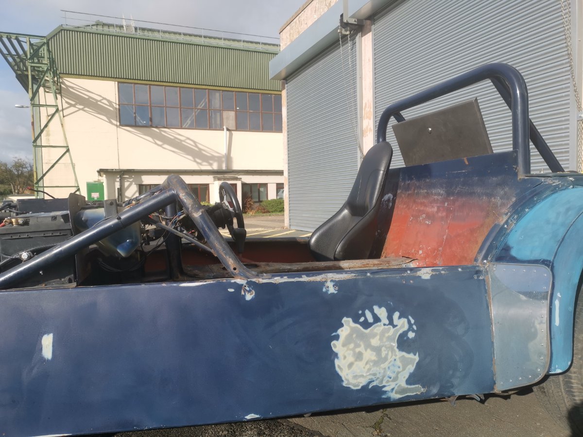

I've also started stripping back all the body work so that I can get it ready to wrap
  • 4 weeks later...

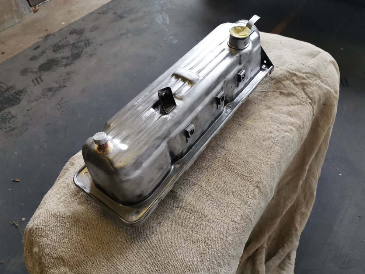

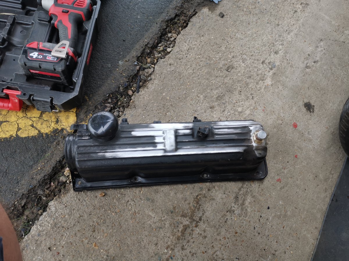

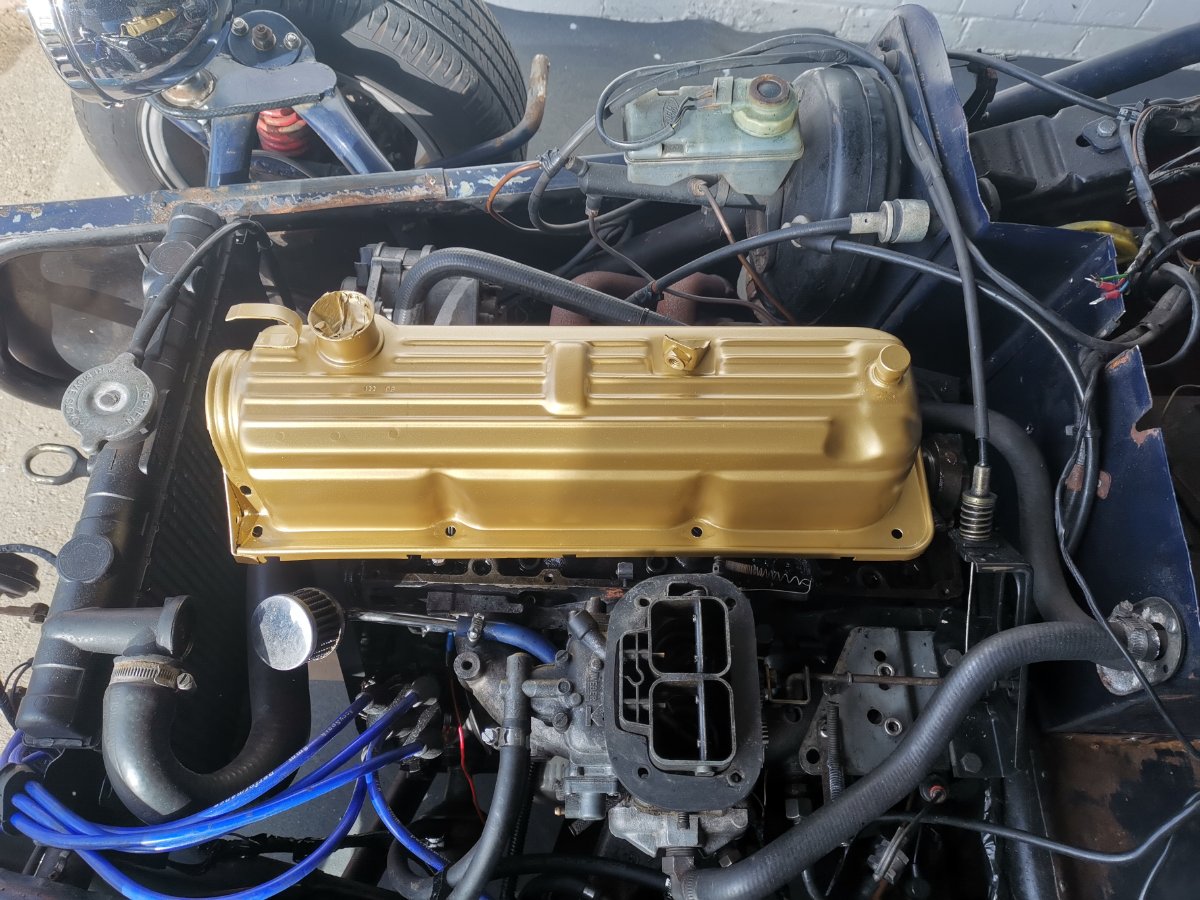

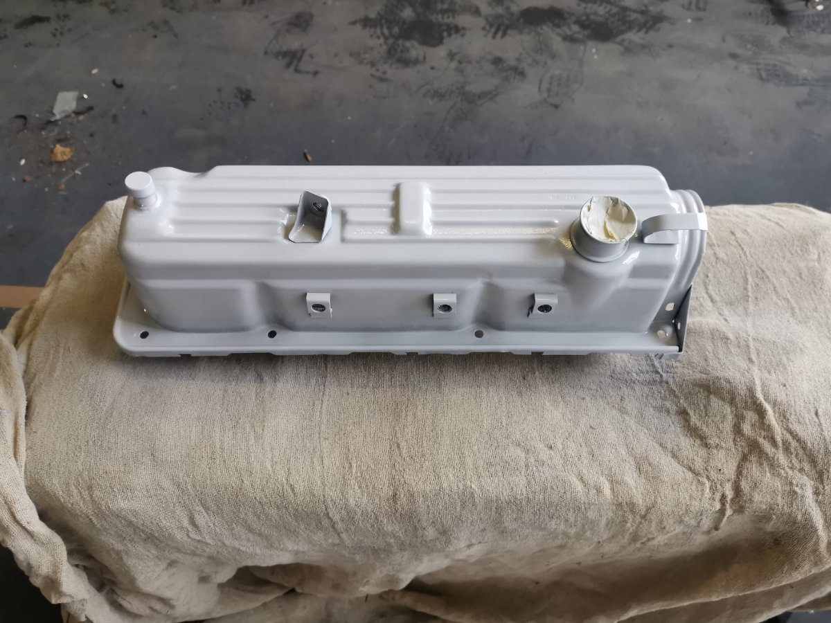

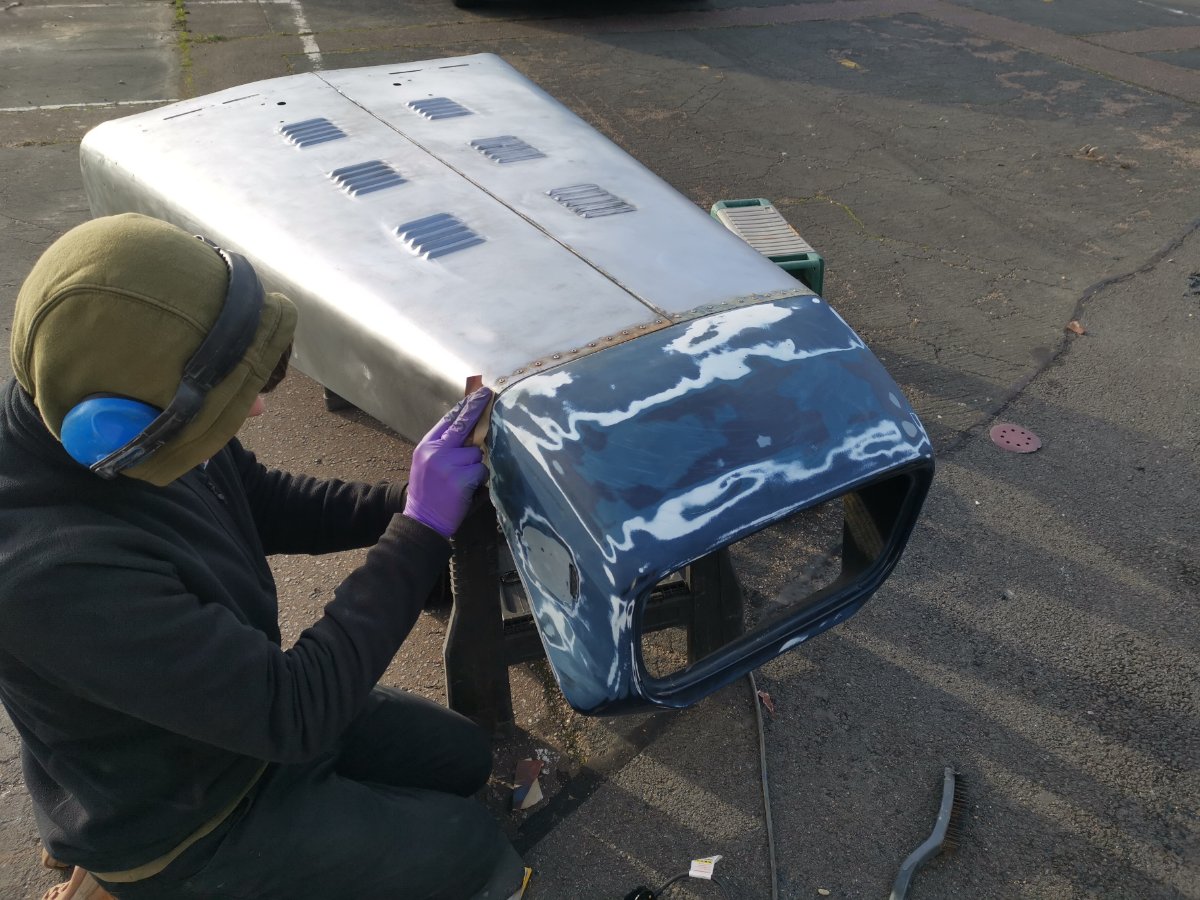

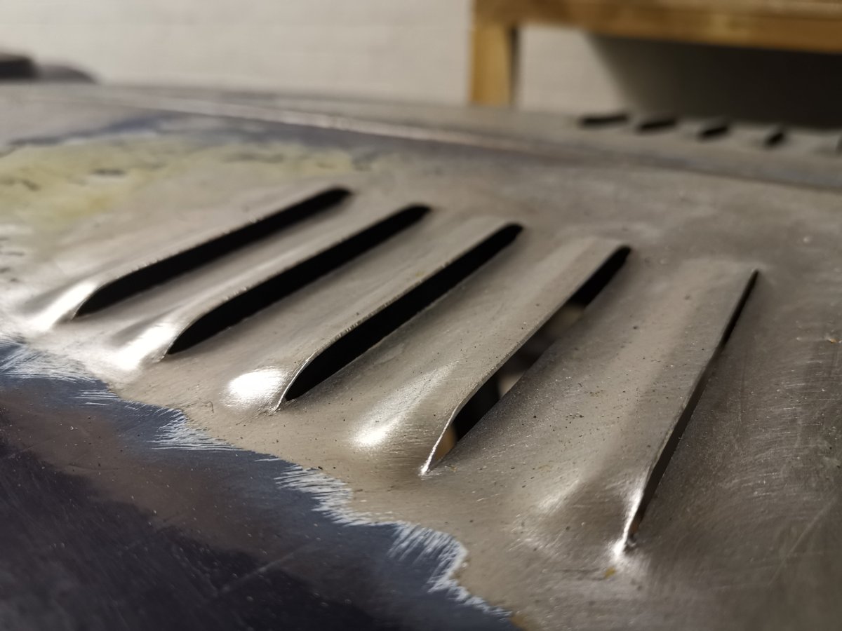

Small tarting up of the rocker cover completed, managed to get thriugh all the layers on the bonnet and primed, rest of the car finished within the week ready for its new look.

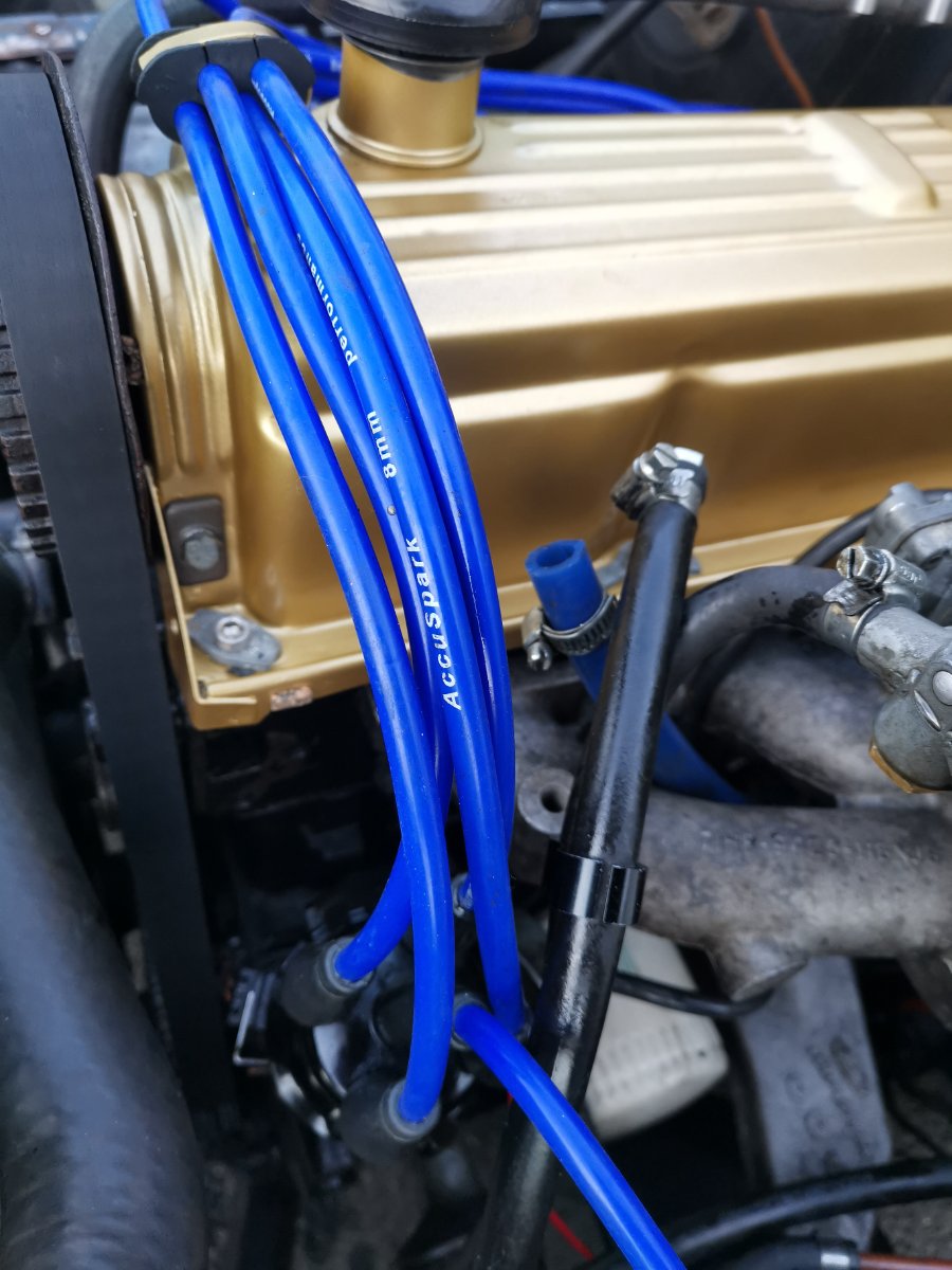

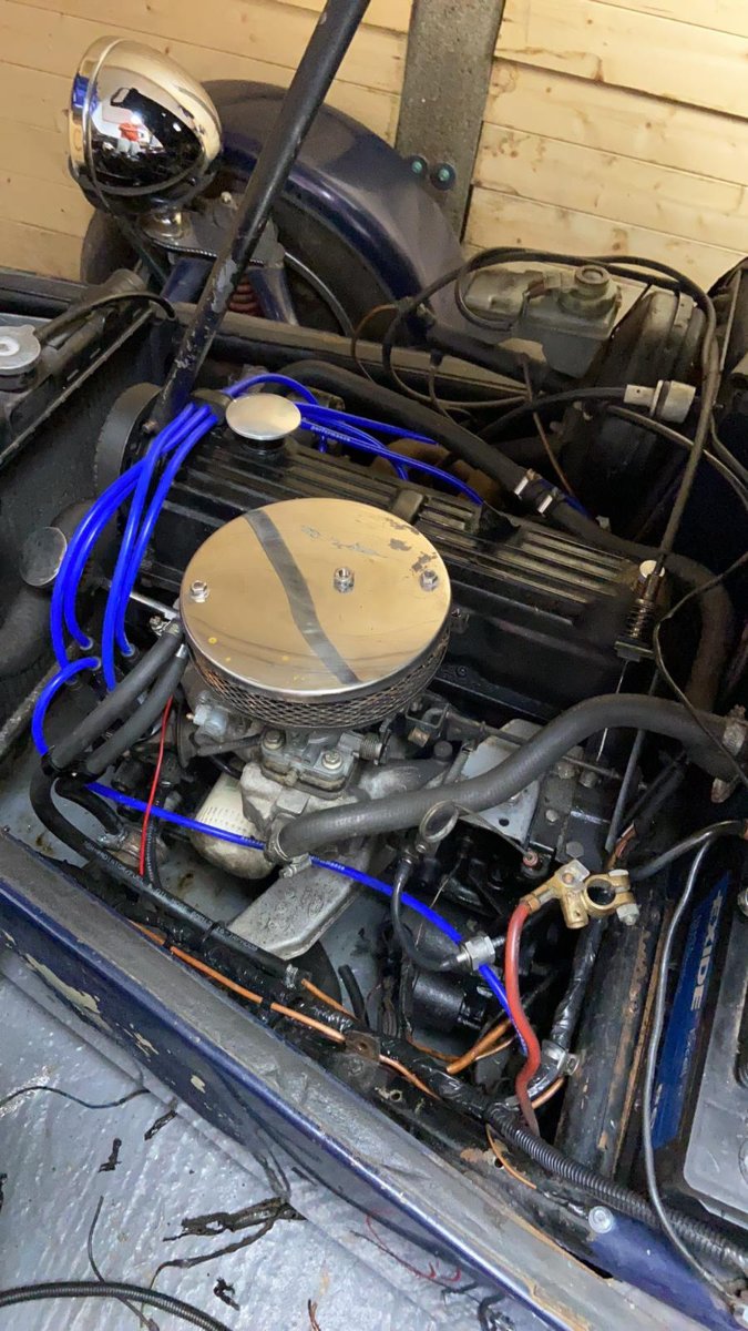

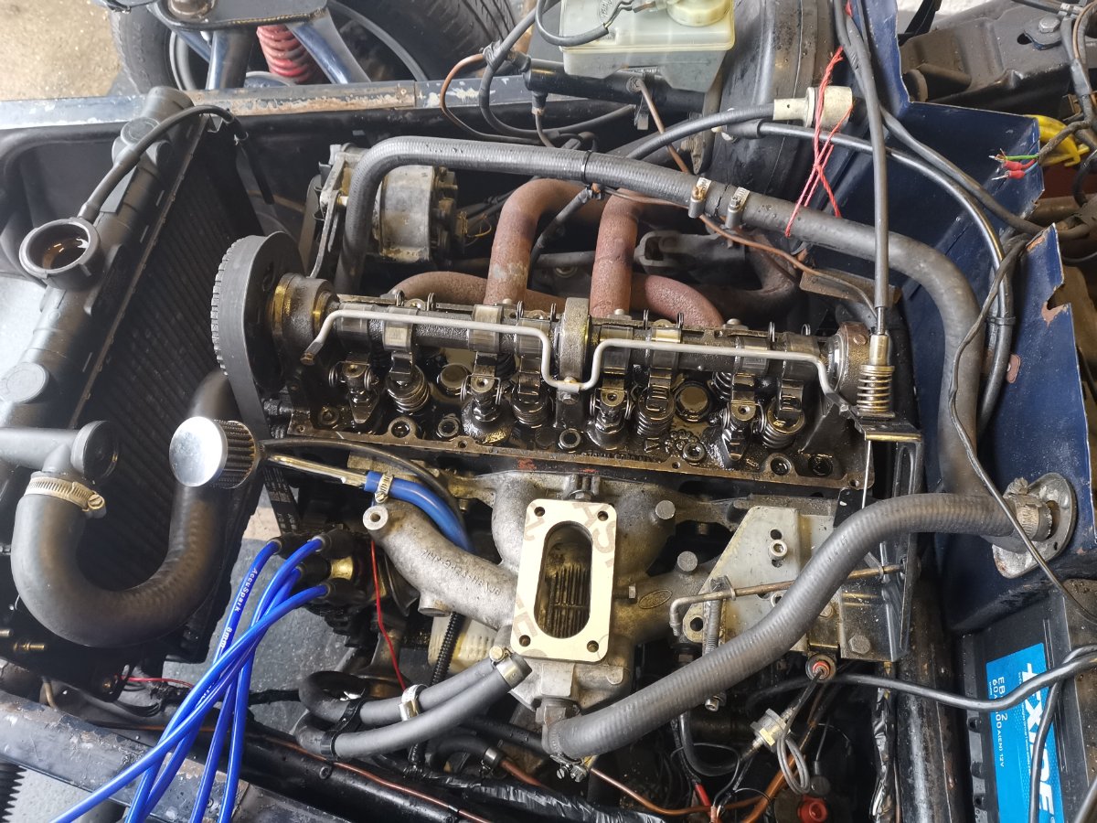

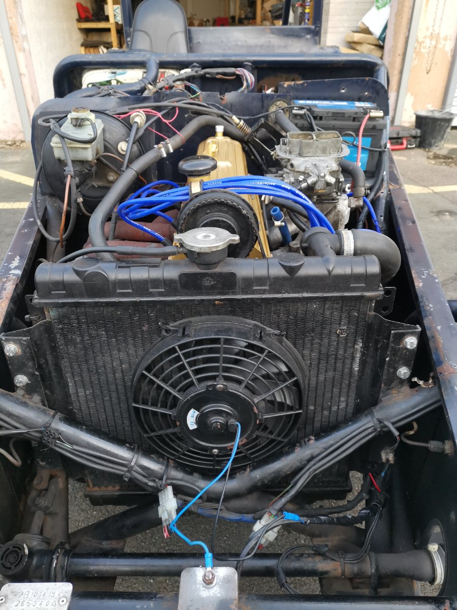

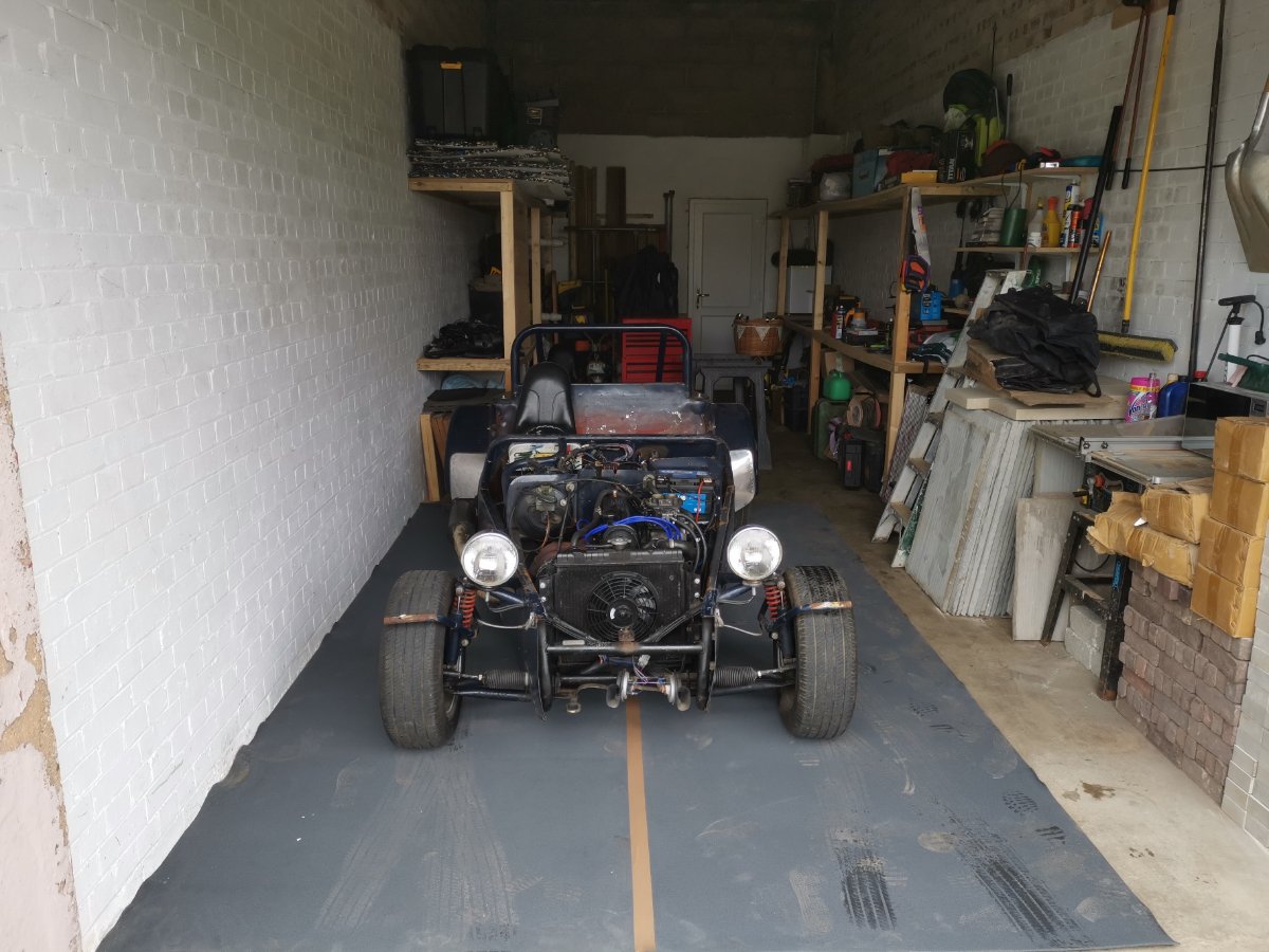

I have been fettling with the set up today and engine is running as sweet as a nut now, valve clearances were not great so all adjusted and is incredibly quiet especially with such a high lift cam.
The electric fan that was added is a suck and fitted on the front of the radiator... Which I believe is close to useless?? Especially whilst in motion... So I have temporarily reversed polarity so for set up and checking it's working OK, can anyone confirm that's OK?

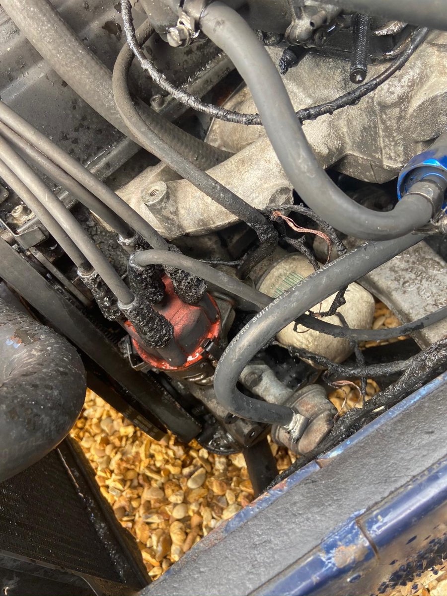

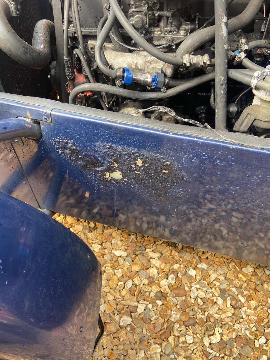

On a test run it was spitting out oil from the crankcase breather filter,the engine oil is at half measurement so the most common cause would be gunked up as I believe its not too full of oil, So replace and will be OK? Or could there be another issue that could cause this?
Fan shouldn't be suck while on the front of the rad. If it is, just reverse the wires so it blows. Mine is like that and works fine. On the move, above 30mph or so, no fan is any use - they're just for when stationery/slow speed when there isn't enough airflow.
