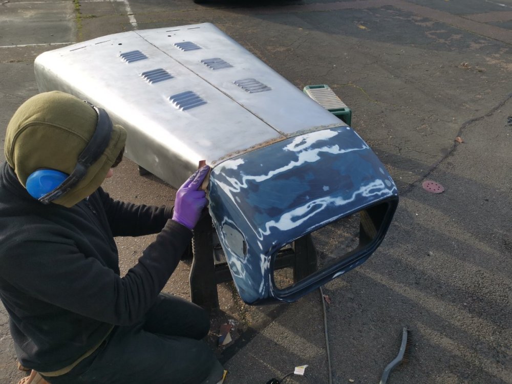

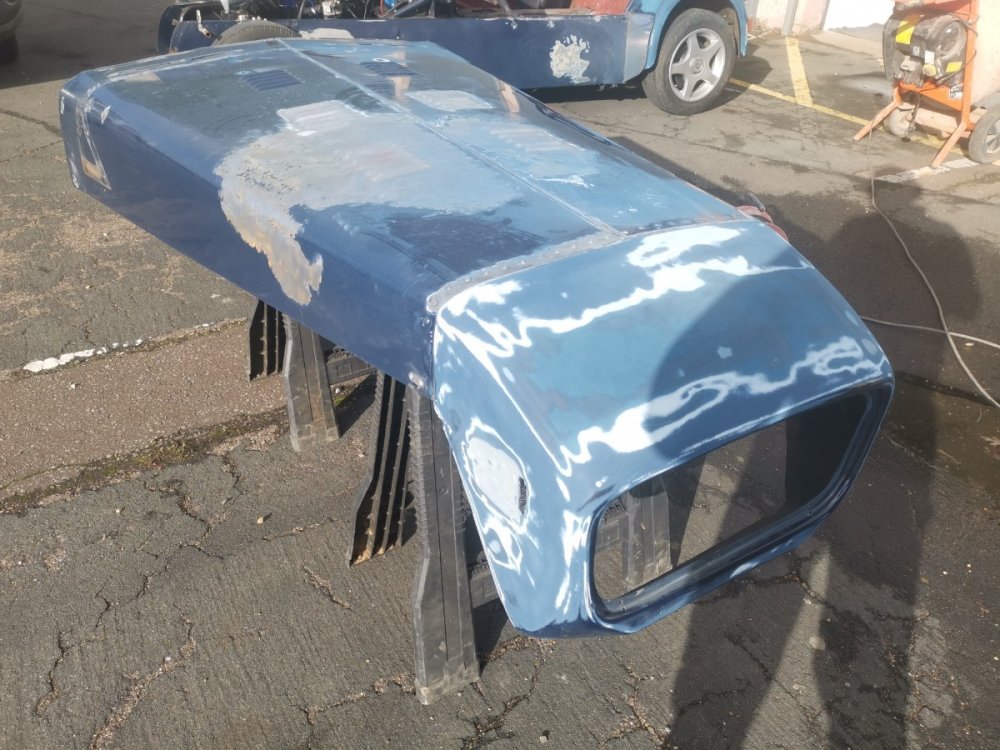

    Then mastering 10 years of practice put into 2 days I went for the body work

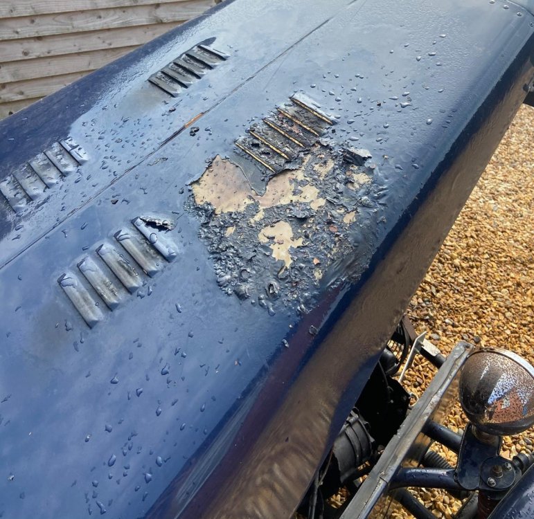

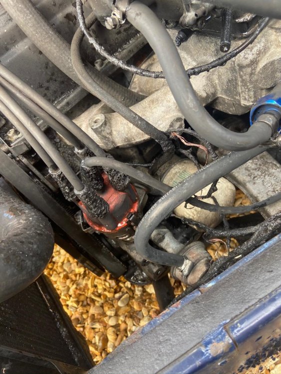

So the previous owner had it stored for 10 years, they then brought it out clean up and get ready for Mot and were hit with a nice warm fire

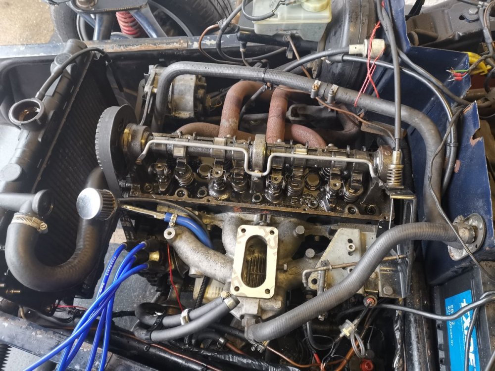

The engine has had a full rebuild Ported and polished to 2.1, big valve head and twin choke 38 weber

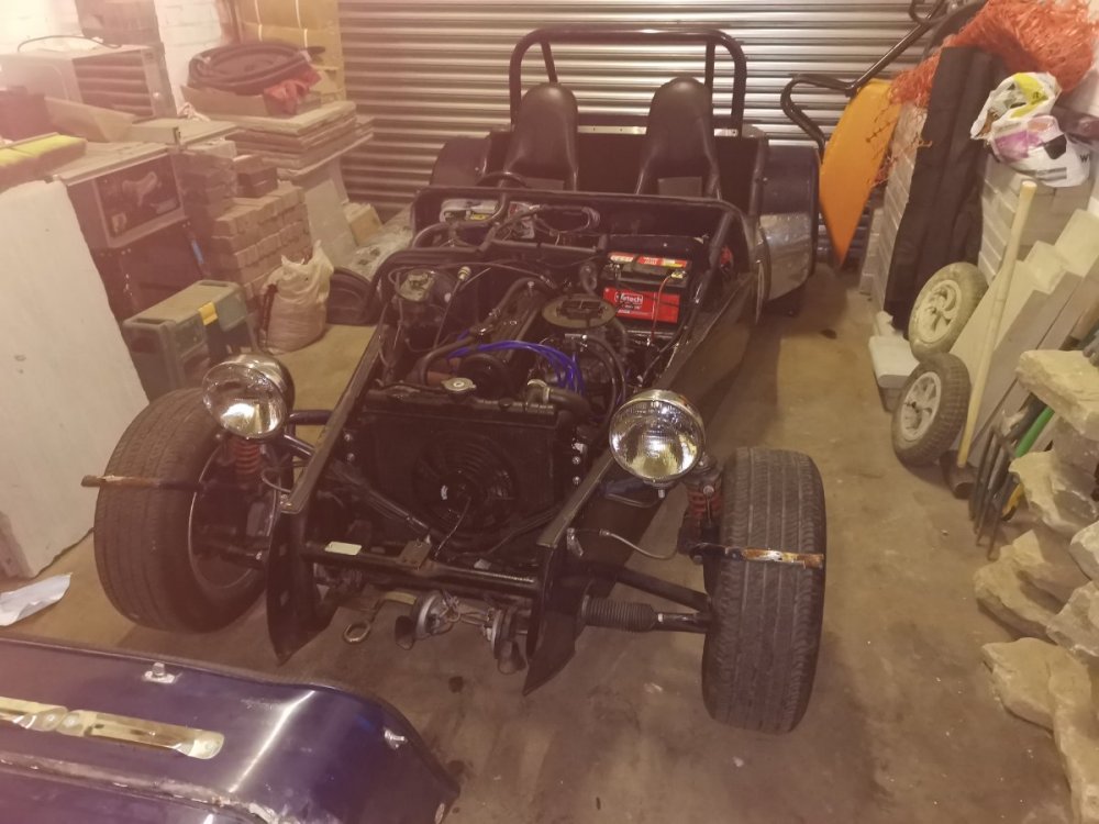

And now a complete strip down has started so that I can check over everything ready for the winter re build

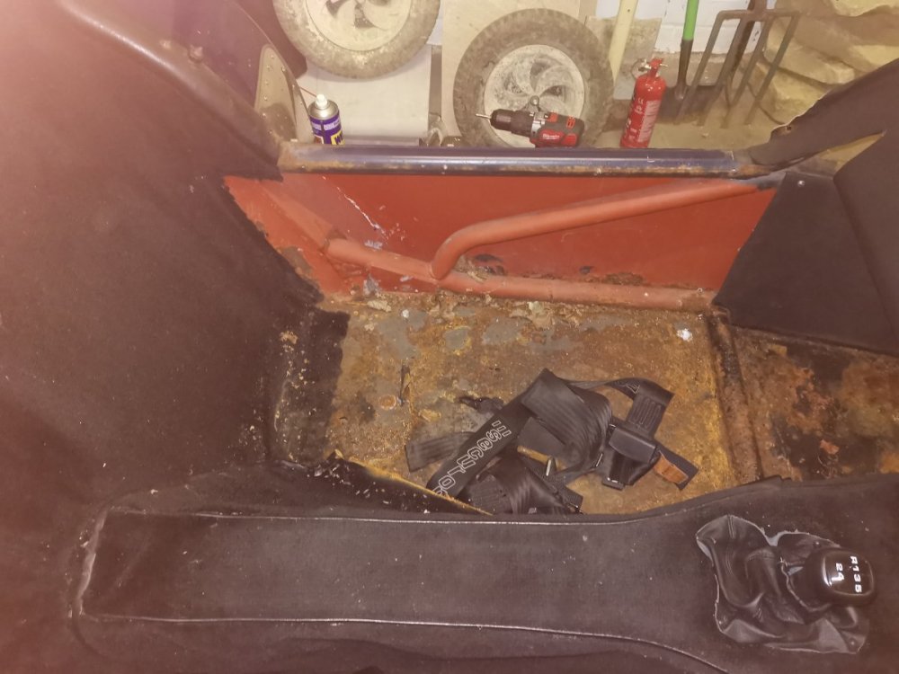

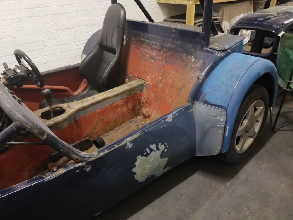

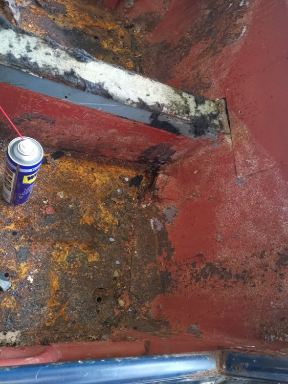

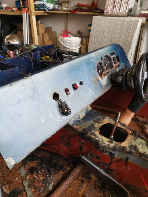

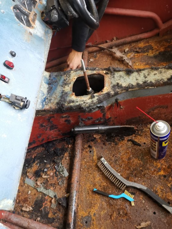

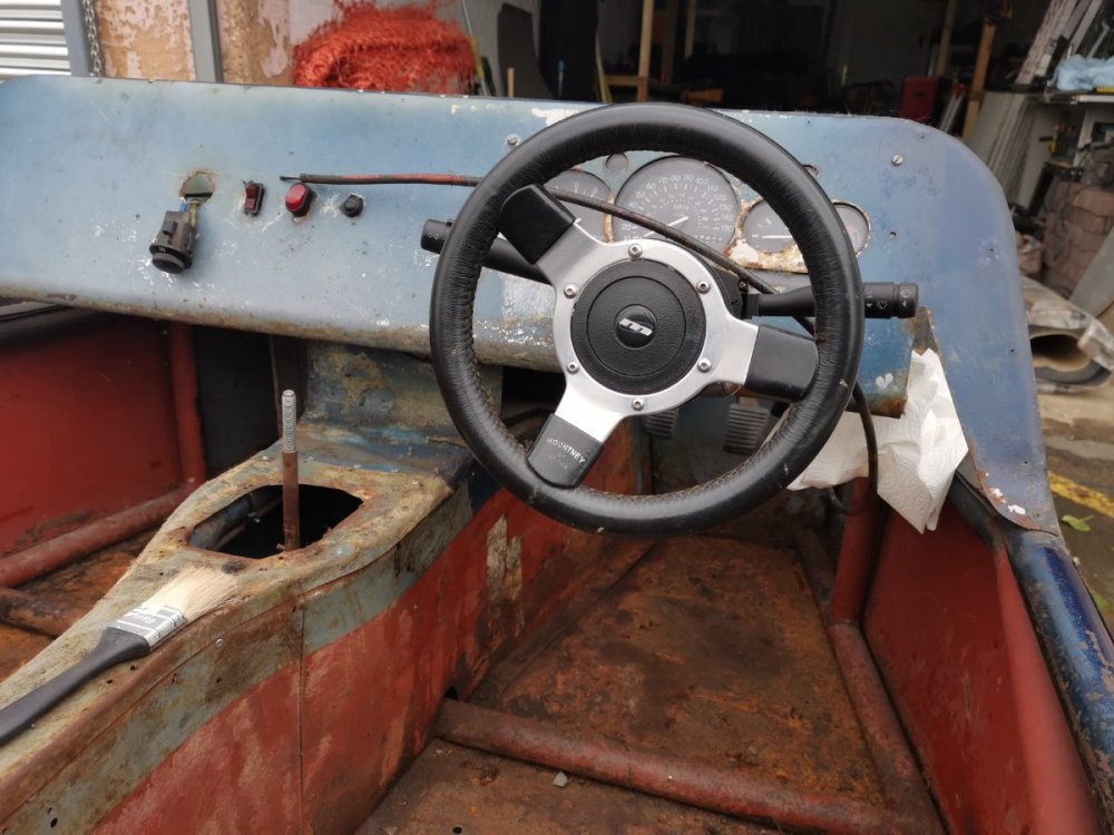

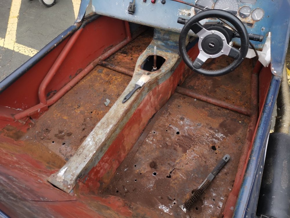

It does feel like a good base, just a bit more rust under the seat panels than had hoped for, cleaning it all back so can then start cutting out and replenishing

The speedo cable is lovingly looking at me in the face rather than doing its job! Upon reading up I will cut a good hole into the tunnel.. Will this likely be able to fix back into the connector or would I need to get a new one ready for it?

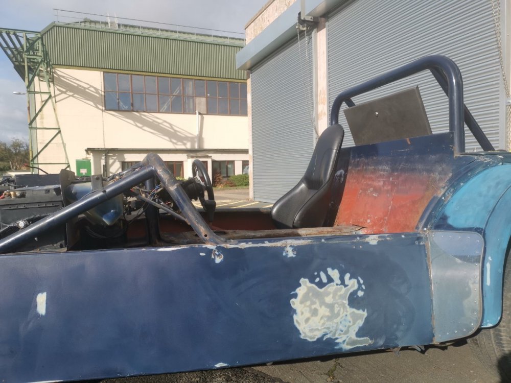

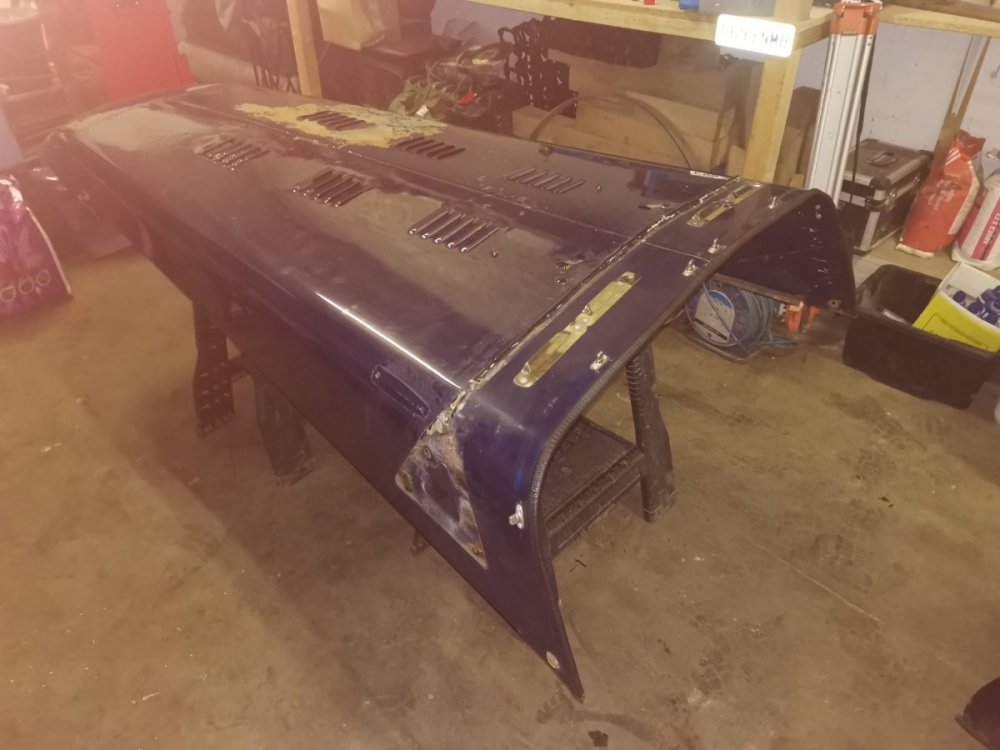

I've also started stripping back all the body work so that I can get it ready to wrap
  • 4 weeks later...

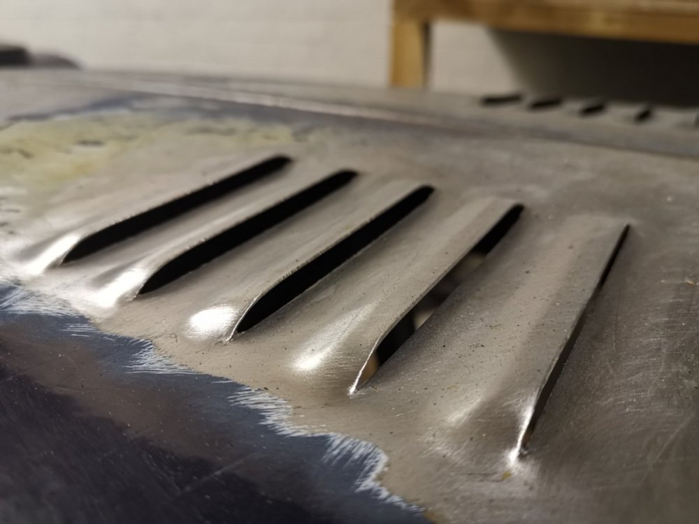

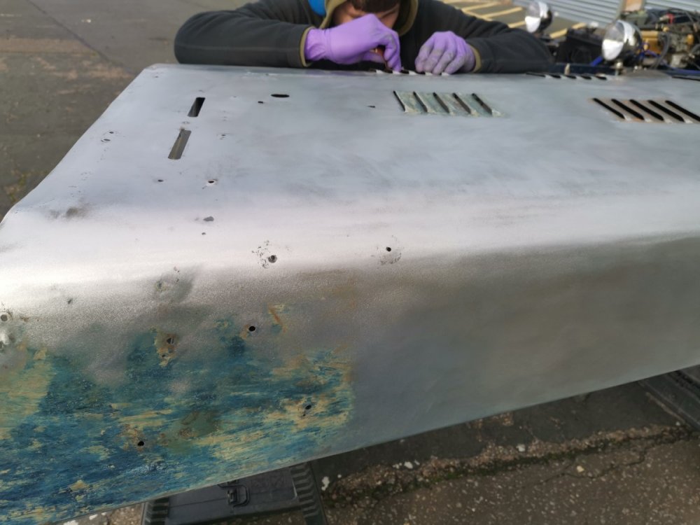

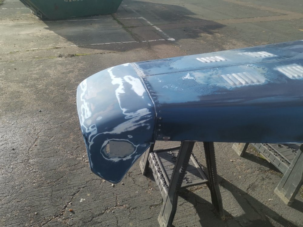

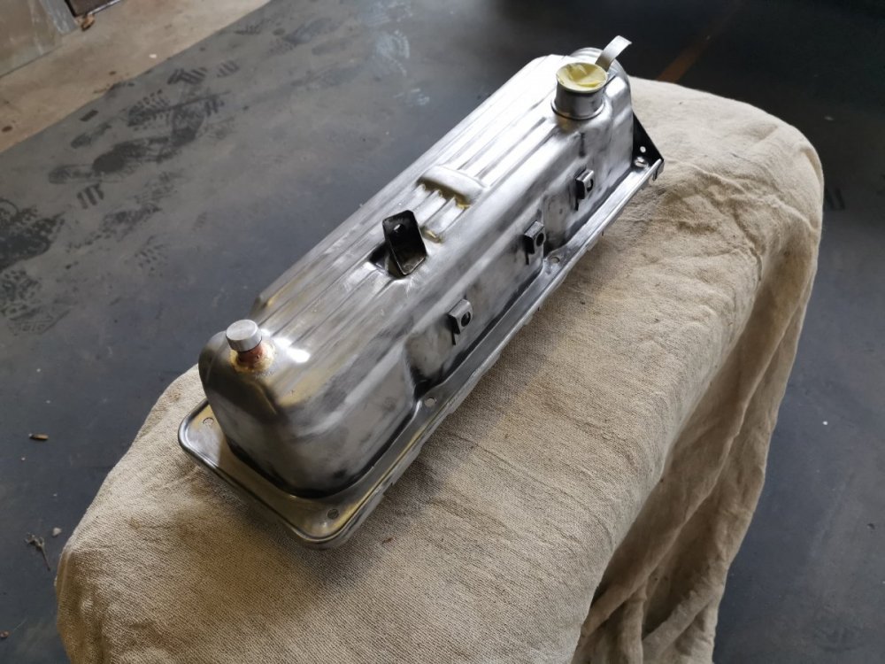

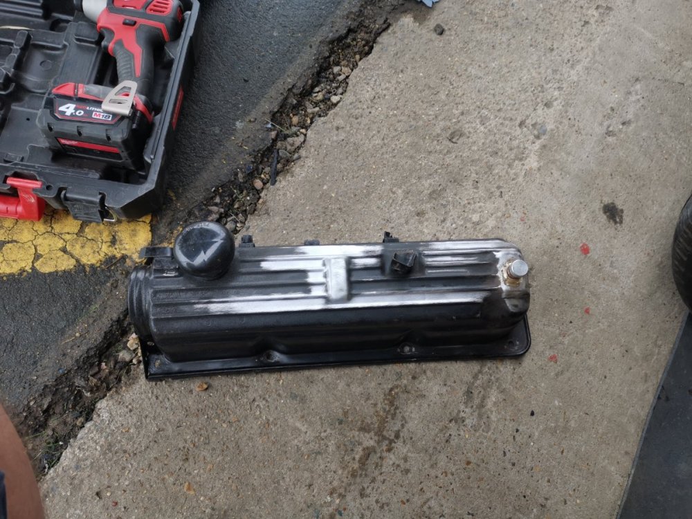

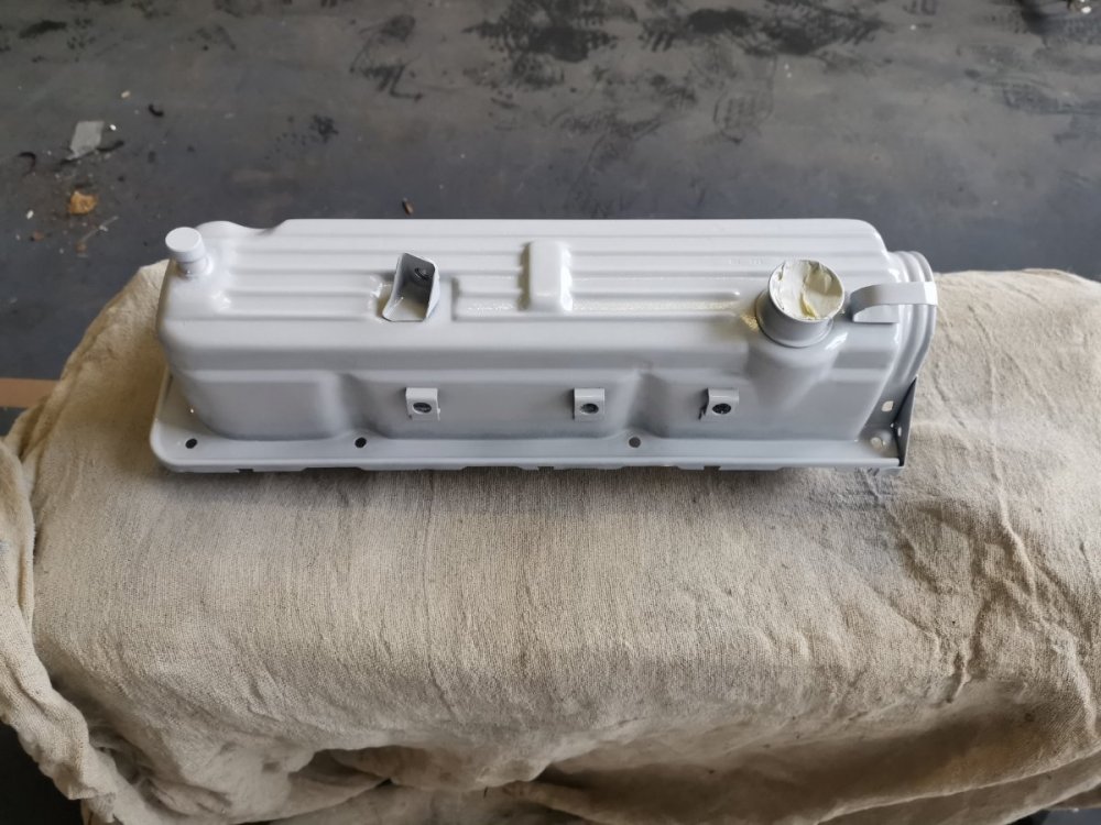

Small tarting up of the rocker cover completed, managed to get thriugh all the layers on the bonnet and primed, rest of the car finished within the week ready for its new look.

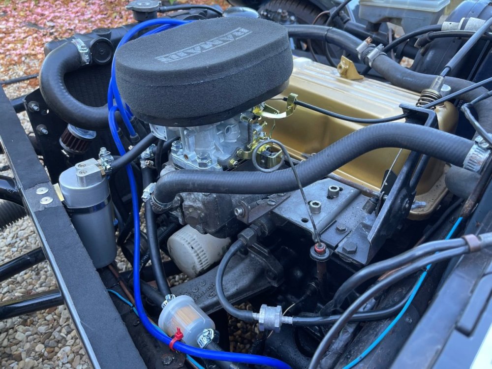

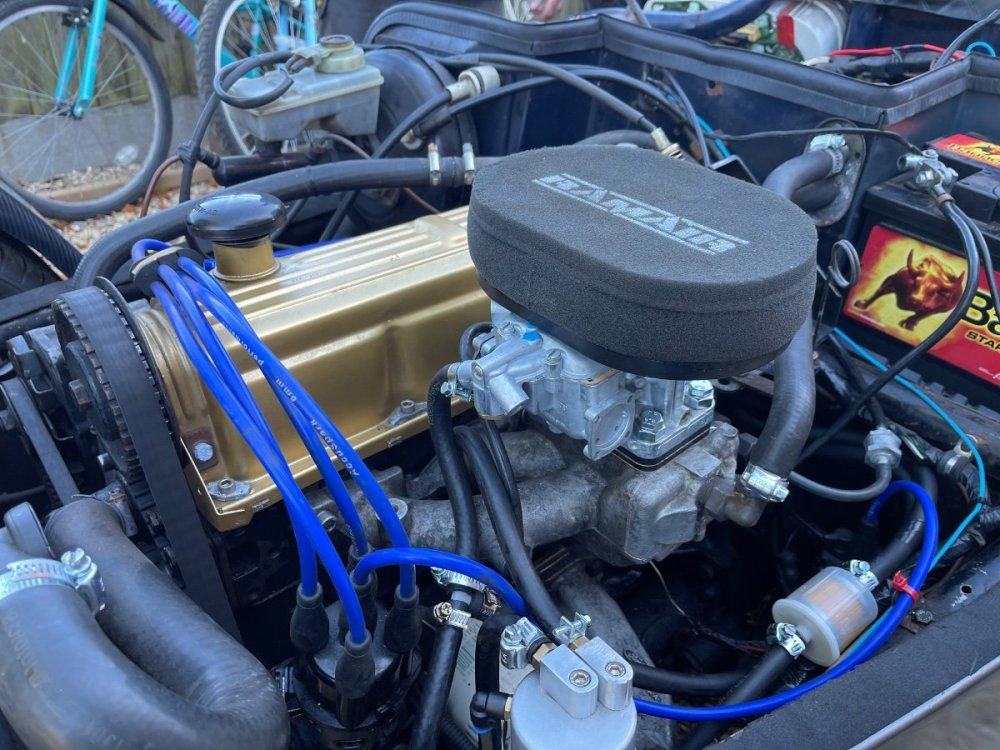

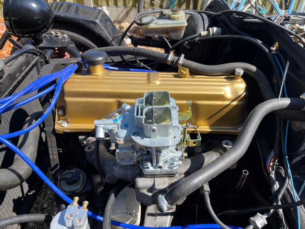

Putting a new carb on that the fuel return pipe is not needed, can this be blanked off safely with stop end and jubilee or is it best to be stripped and then capped off at tank?
Re fuel pipe I have just blanked it off on the thought that it may be required again one day. Mind you that was about 15yrs ago!
I personally would cap it off at the tank if you can. You don't want a leak from an old pipe where you can't see it, if it's terminated at the tank it's one more variable removed from the equation. If you did need it at a later date then you would want to start with new pipework. Can't be too careful with petrol
Thanks chaps, have blocked off and will order up a device to delete the whole pipe and cap it up👍

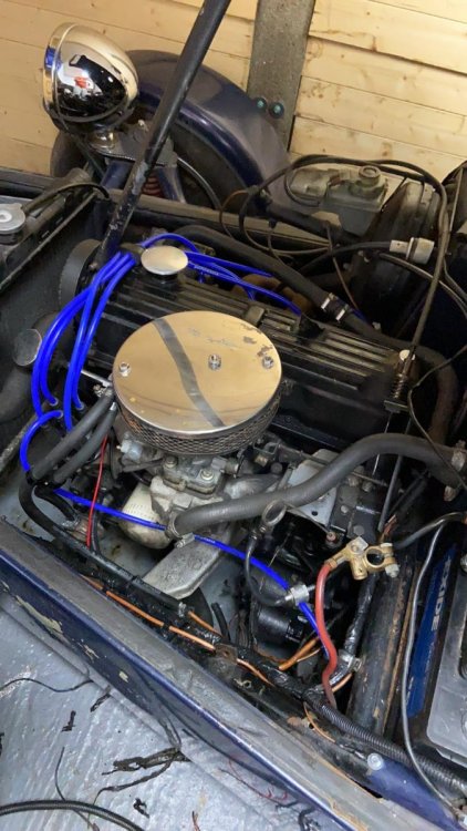

I have been fettling with the set up today and engine is running as sweet as a nut now, valve clearances were not great so all adjusted and is incredibly quiet especially with such a high lift cam.

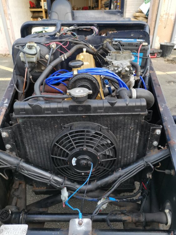

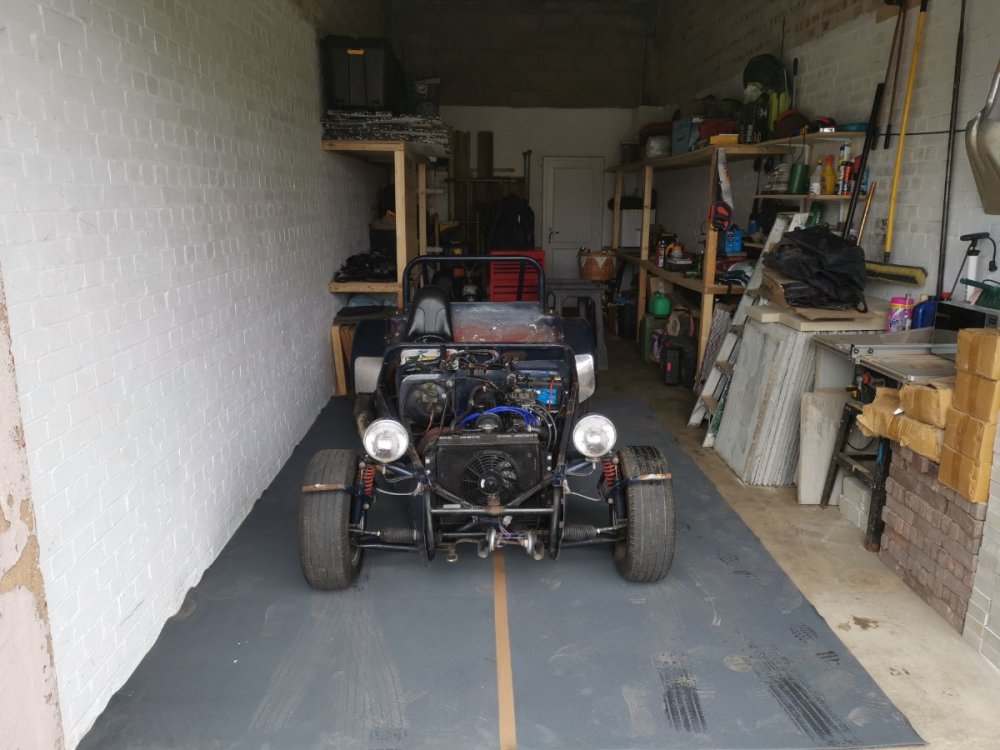

The electric fan that was added is a suck and fitted on the front of the radiator... Which I believe is close to useless?? Especially whilst in motion... So I have temporarily reversed polarity so for set up and checking it's working OK, can anyone confirm that's OK?

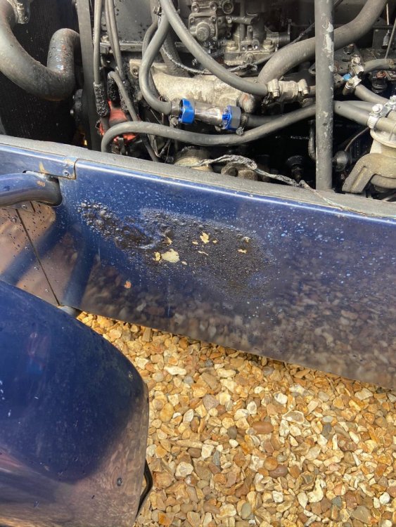

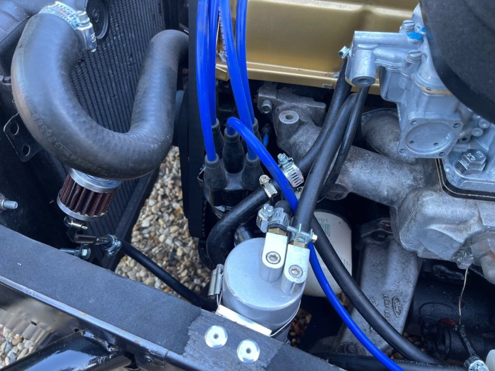

On a test run it was spitting out oil from the crankcase breather filter,the engine oil is at half measurement so the most common cause would be gunked up as I believe its not too full of oil, So replace and will be OK? Or could there be another issue that could cause this?
Fan shouldn't be suck while on the front of the rad. If it is, just reverse the wires so it blows. Mine is like that and works fine. On the move, above 30mph or so, no fan is any use - they're just for when stationery/slow speed when there isn't enough airflow.
