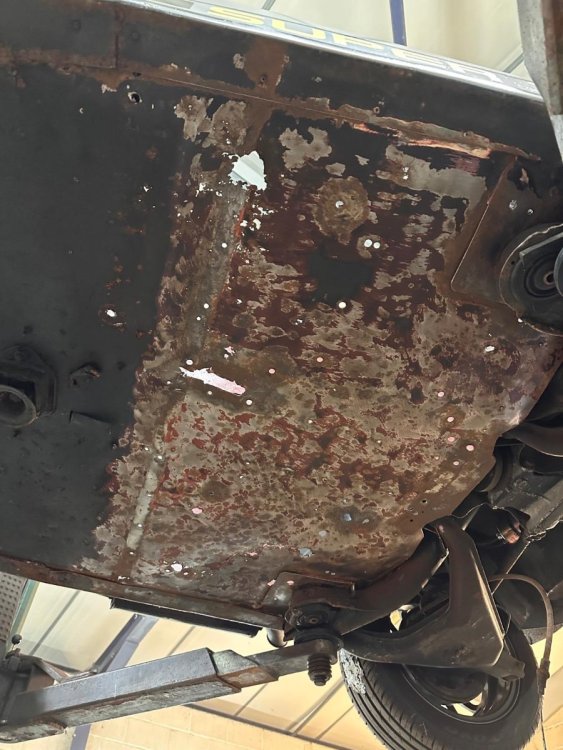

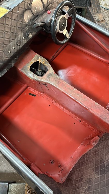

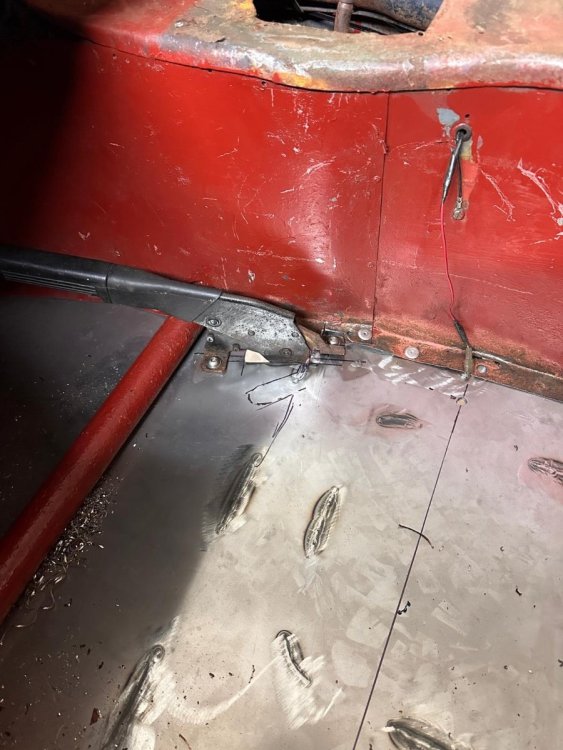

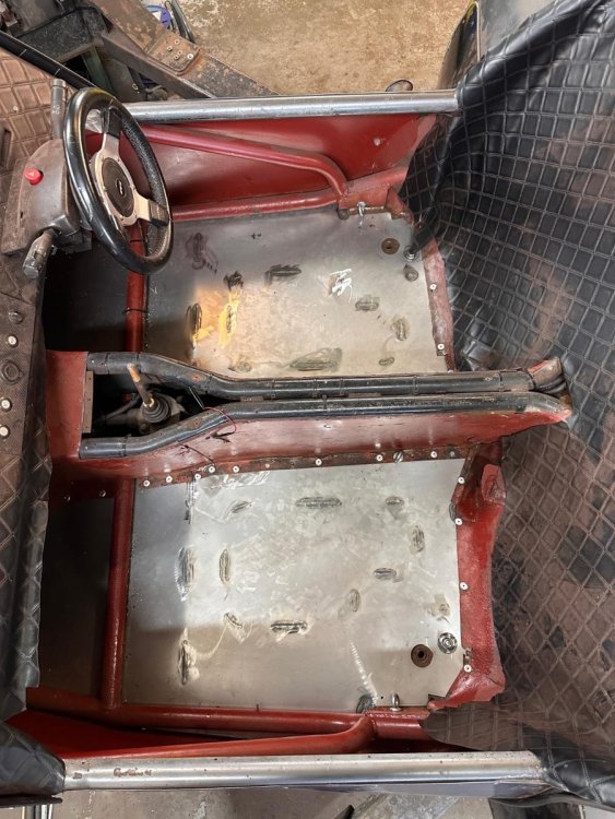

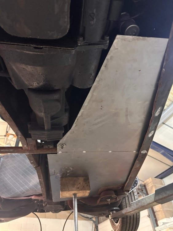

So a complete mare with the seat mounting in the car, a complete “opening a can of worms” situation, albeit needed….

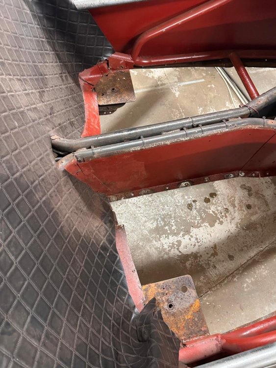

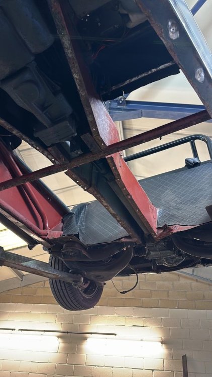

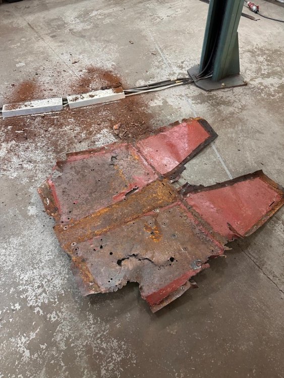

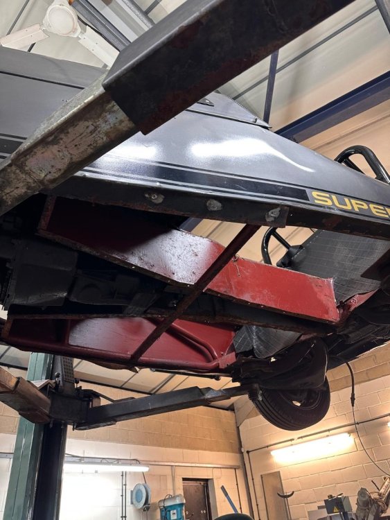

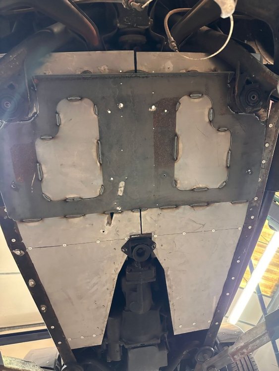

So the seats I wanted to have both on runners, which needed some new holes. However upon cleaning back what started as sheet metal with a few holes in the floor, turned quickly into holes with a few bits of metal in it.

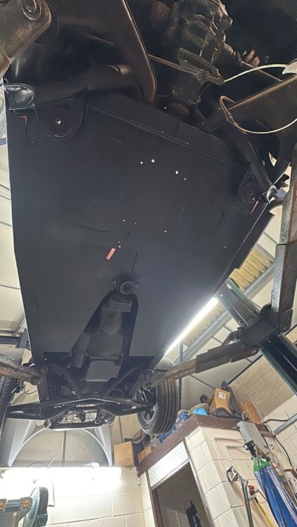

So I had to go down the route of taking the whole floor out
Purchased a complete floor from gbs but had to cut it up to fit and so that I didn’t have to take the sides off, we cut it and slid under sides and re fixed it all up nice, I also added the strengthening plate whilst there so that it’s nice a sturdy and hopefully will really improve the chassis

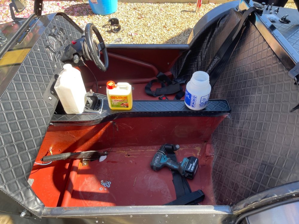

Sealed it all and now seats and harnesses going in back tomorrow ready to go for mot shortly after finding a new fuel sender

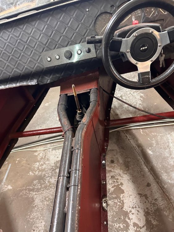

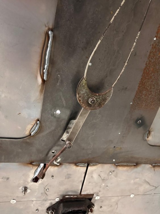

Due to the larger seats I’ve moved the handbrake further forward and added an extension plate in

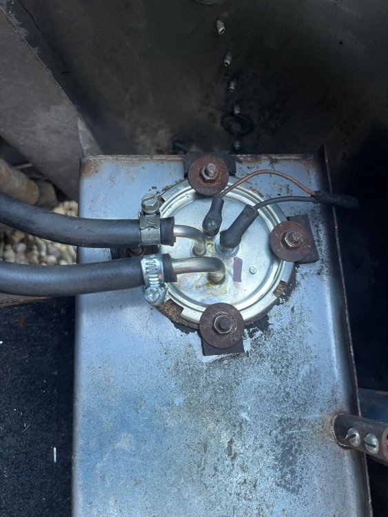

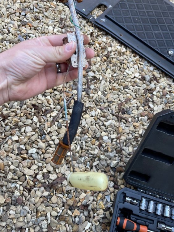

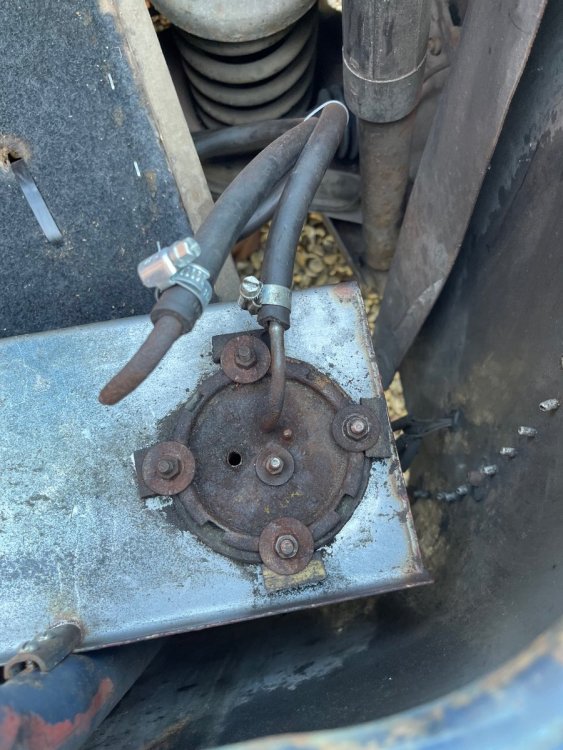

Fuel tank was full of sludge, so removed and flushed through, new fuel pipes fitted as the originals have started to perish, bearings changed and boots are new……and i think it’s now ready for the MOT, other than a fuel sender replacement

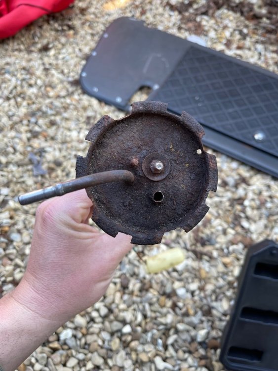

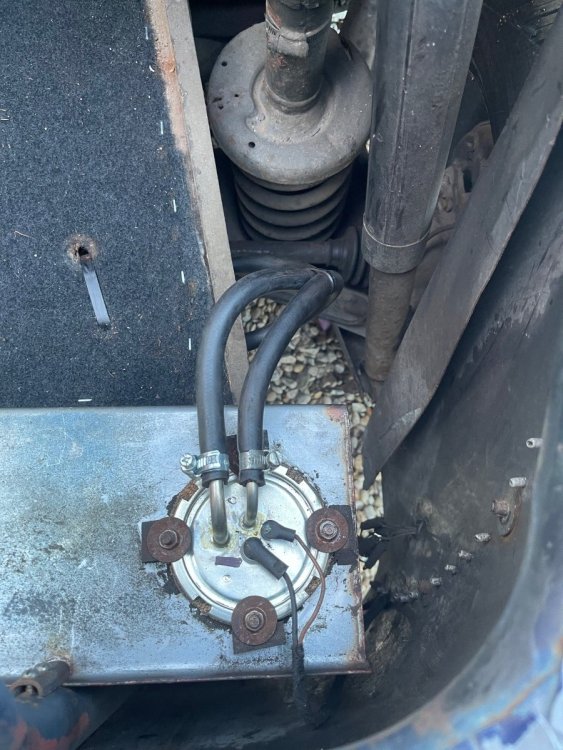

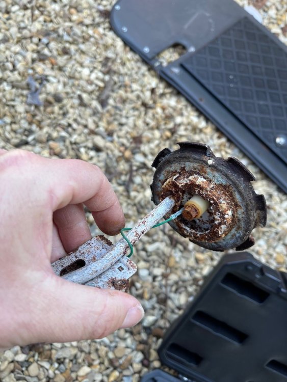

Fuel Sender fully knackered, pipe fell off on a slight breeze, new one now on the way, then it’s off for first MOT in 12 years, here’s hoping I can bring this fully back to life
  • 5 weeks later...

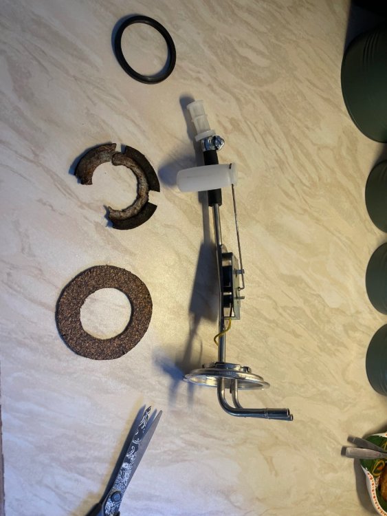

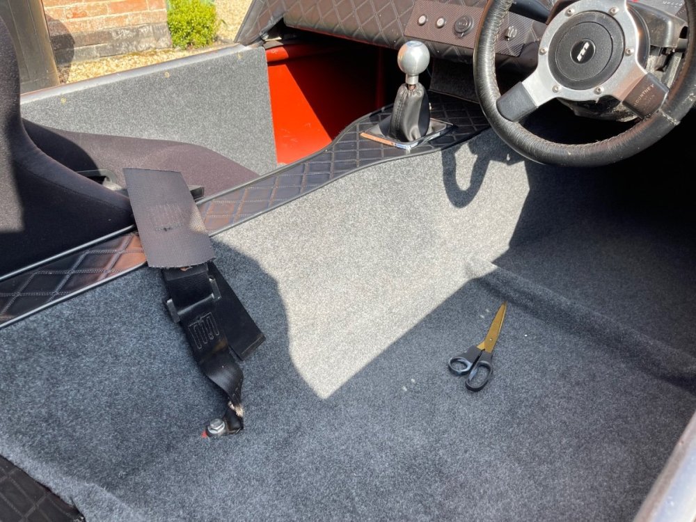

New sender arrived and after some adjustments with the rotation to fit it it was ready to go in, new sender filter from a 2cv, new gasket then ordered and cut to size, with some Hylomar blue for good measure it all went back in and fuel gauge is working lovely. Re fitting all the boot back together and carpeting interior

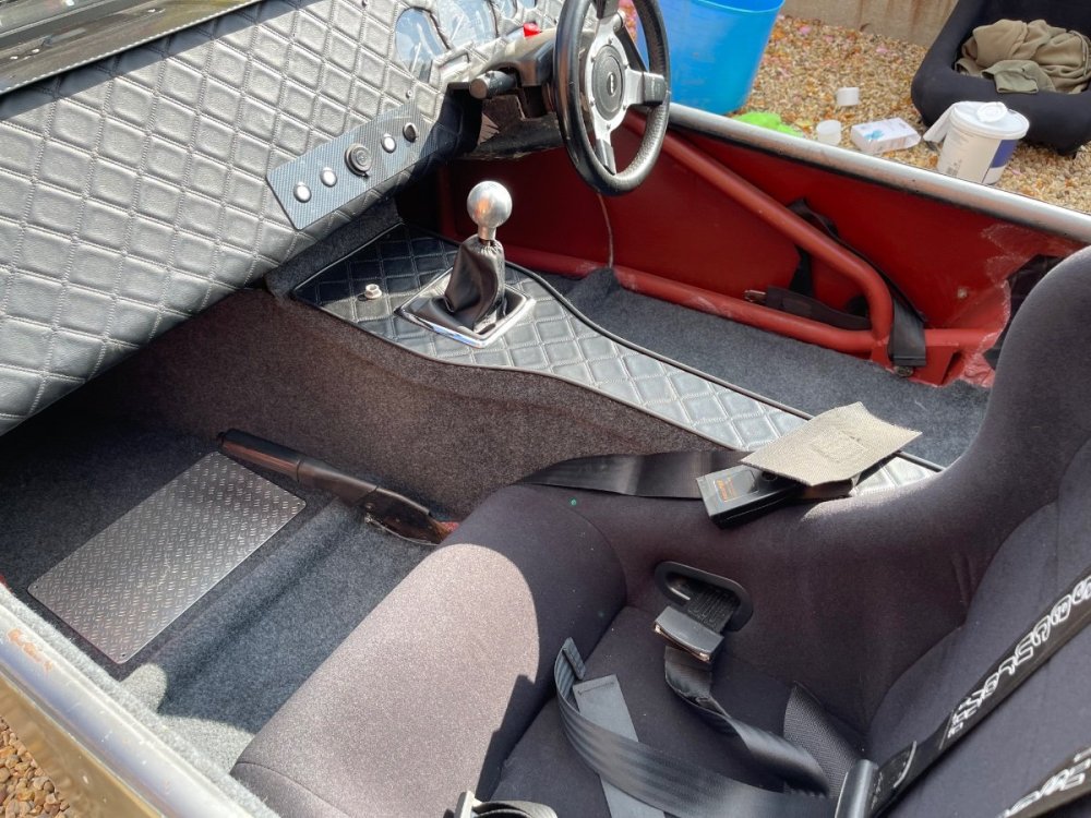

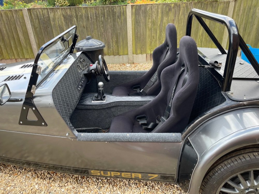

Interior is near complete, arm rests and some edging and bits left is all.
had a run through for MOT and realised a few bits would be a straight no, reverse lights washer jets and full beams
absolute mare trying to sort washer jets out, troubleshooted the wrong way as found out it’s a fused earth switch set up, could not trace back the earth for the life of me, so have bypassed and now adding a temp toggle push switch as a workaround, also re wired up the fan switch nicely.
All is now complete…..minus a few creature comforts being sorted which is not MOT crucial
  • 4 weeks later...

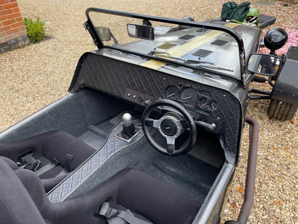

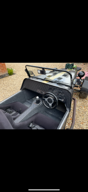

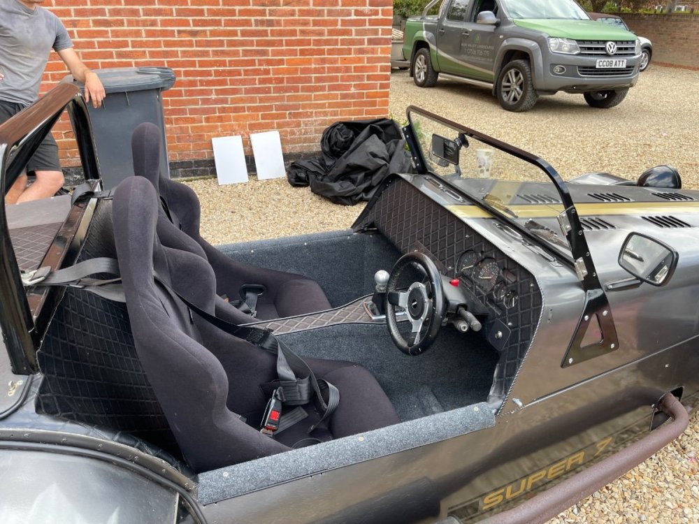

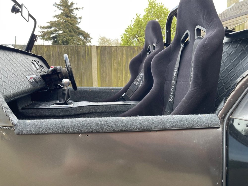

Finished off interior ( bar a redo of the dash once I’ve got it on road) fashioned up some pipe works to create arm rests and fitted seats in

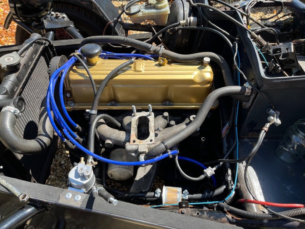

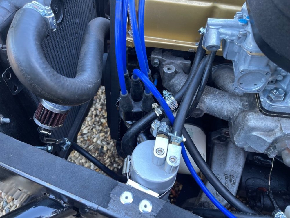

Big day today as couldn’t get it idling well,  and extreme emissions test, so, carb off and inlet manifold to replace gasket, cleaned up and fitted all back on, purchased a brand new 32/36 Weber carb from Eurocarbs with fitting kit at a great priceIMG_9182.thumb.jpeg.9859534a5f80b85a35174923d24dd072.jpeg, T’d in the fuel return pipe as no union outlet for that and re worked fuel pipes.
re worked the oil catch can pipe to have a vent.
Changed to a manual choke so plumbed that in and new hole in dashboard
The end of the day had ended in victory beers as it started up lovely on base settings, bit of play with idle and mix and it’s running very nicely…. So finally it will be getting in for MOT next week after 6 years in the restoration process!
