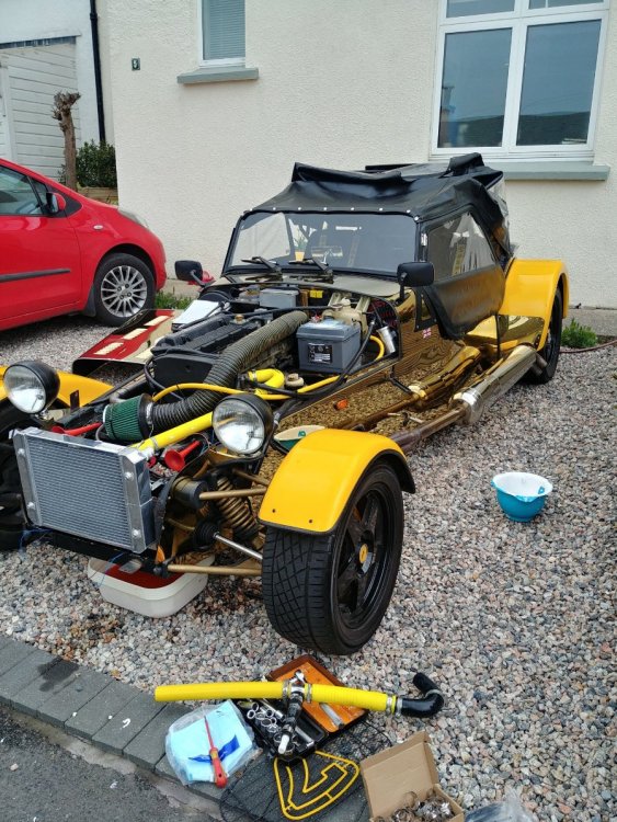

October 29, 20206 yr Mine is between the frame rails and is the original rad from the donor sierra....Not very sexy, but happily cools a 2 litre zetec

October 30, 20206 yr This is an old piccie ... .I inherited this set up..... It's not sexy but it gives you an idea . I am going to change it at some point
