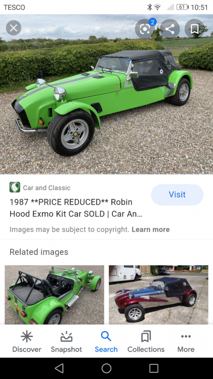

Just pulled this pic off Google. I think it shows the correct way round of doors. There are a few pics of doors at jaunty angles so obviously a few people have had issues too.
Quote
think it's a bit misleading when people say you have door on the wrong side.  What they mean is that it is back to front, i.e. the 70 deg slope end goes to the front and you have it at the back.
