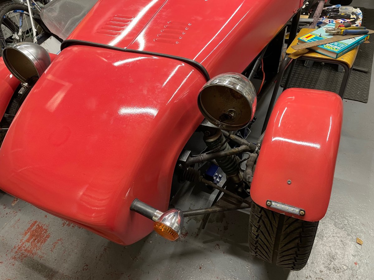

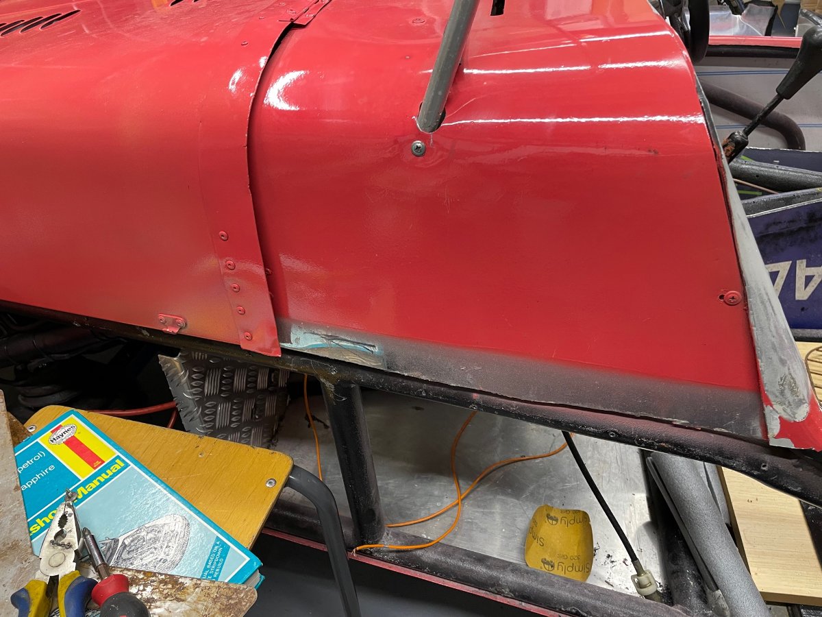

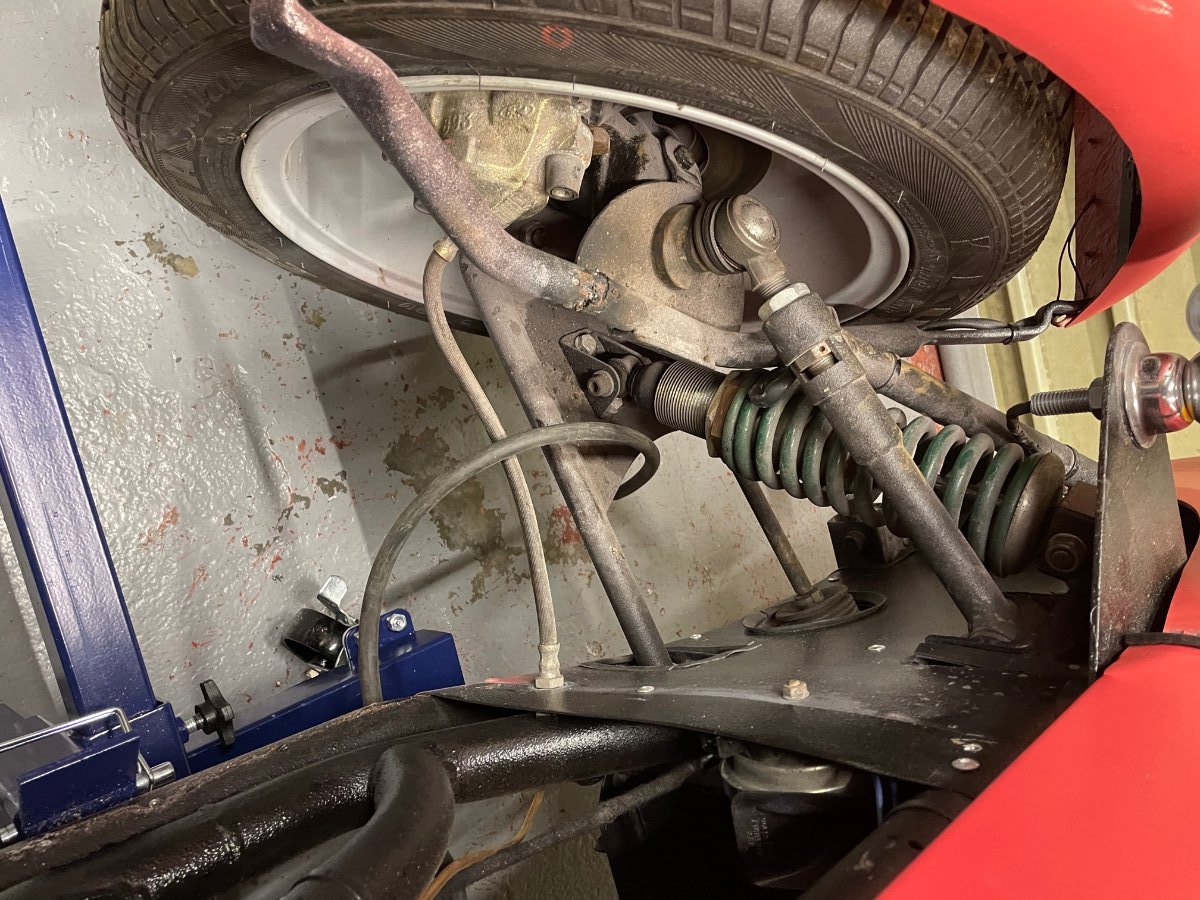

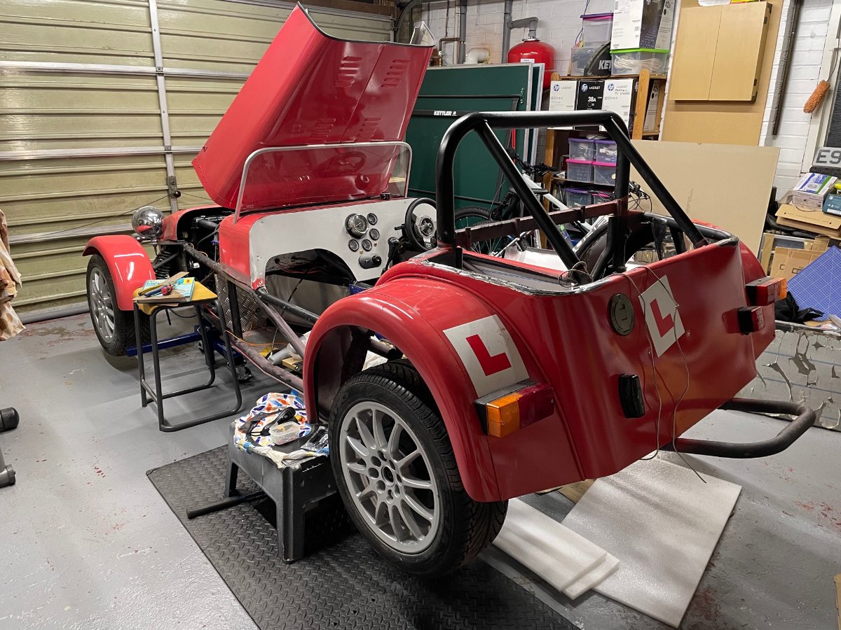

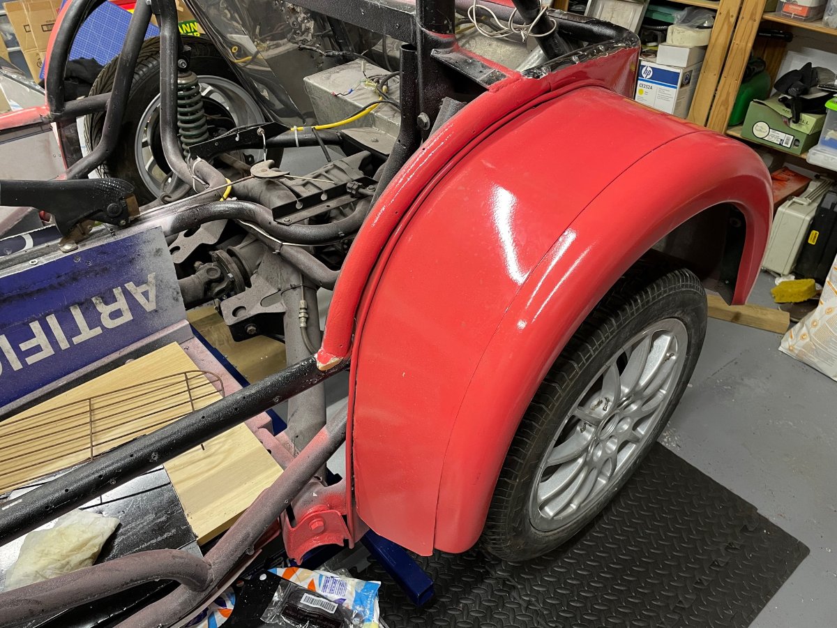

I have attached some pictures of the car.
Yes it looks like someone used advertising hoarding for the insides :)
If that windscreen frame is ali I would not think that it is strong enough to take the load at speed without folding.
There is a reason for the steel mount and support we have for cars fitted with a screen.
