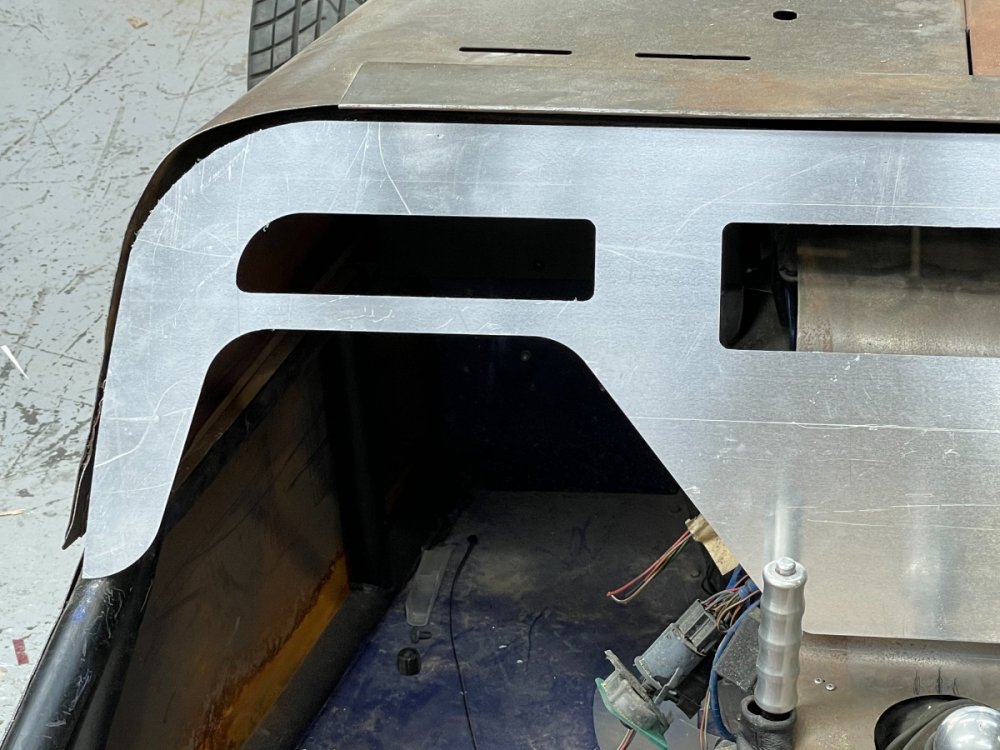

Must admit I am puzzled by this 19mm radius aswell. does the iva say that it as to be a full half circle(38mm dia) on underside. whats wrong with it just being matched to the thickness of the dash panel you are using as you can make any panel have a 19mm radius over what ever thickness panel, or am i being dumb and missing something.

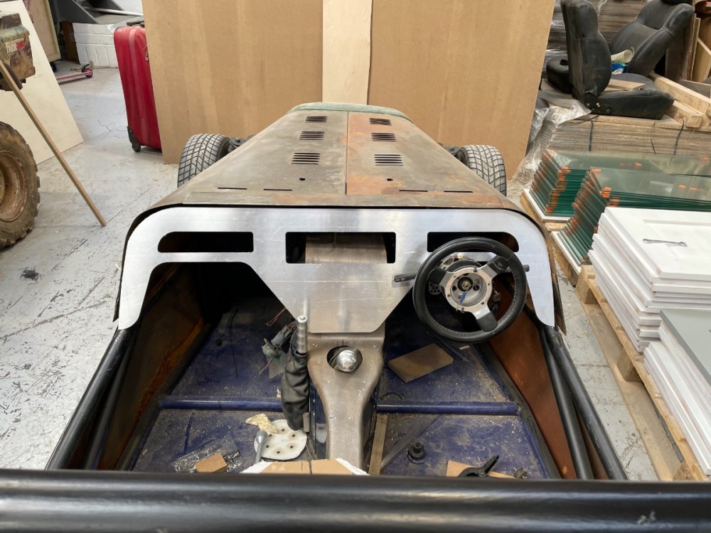

  • The bonnet is not meant to fit to the tube behind the dash, you need to fit the dash to fill the gap. Once everything is fitted in place it is fairly rigid.  Nick
