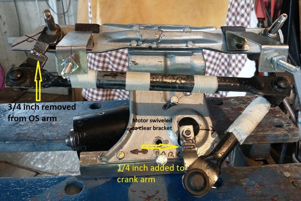

After a lot of trial and error ( I think it's called an heuristic approach) I have modified the Sierra wiper mechanism to give a better sweep of the blades, the drivers side now has just over 130 degrees and the passenger side (which was never a problem) has around 100 degrees. The photo below shows the hacked end product. Adding length to the crank arm only gives a marginal gain in sweep because it soon fouls the bracket and also means changing the length of the attached arm to a point where the mechanism becomes "unstable" and can easily lock up as the joint flexes in the wrong direction from the nearly straight position, a bit like your knee suddenly bending the wrong way when you try to kneel. Now I can move on and try to get a decent weather seal around the turning shafts that are coming through the scuttle.
