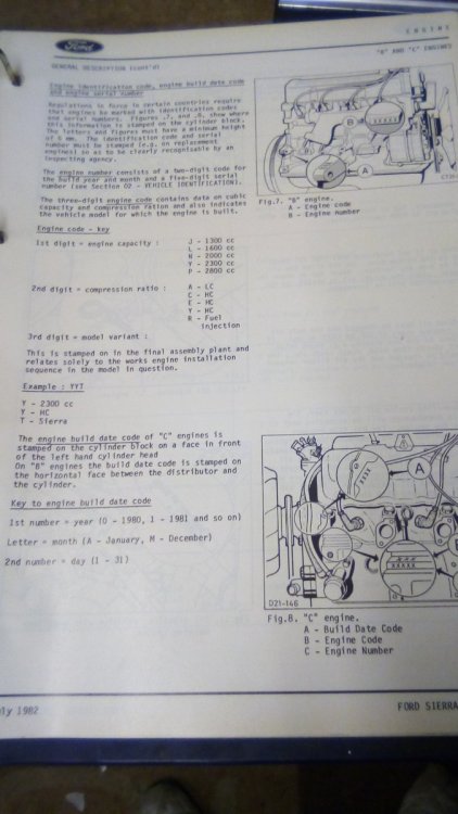

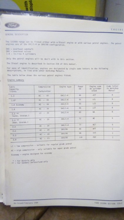

Late response from me but all Pinto blocks have 16, 18, 20, 202. 205 or 200 cast in both sides of the block.
this is the easiest way of identifying the block size
Thanks. The trouble is that I need a definitive statement from someone who the DVLA will accept, e.g. Ford - local garages say they don't have records for that long ago, a garage/mechanic - they don't seem to want to put their name to a document unless they can also find something definitive online, which confirms block numbers to CCs or maybe a car club statement on headed paper would do - I don't know who to ask in the RHOCaR.
Basically I don't want to open a can of worms with the DVLA, by which I mean if I tell them correctly that it is a 2 litre but cannot back that up if they ask questions, then I don't know what action they may choose to take (if any), e.g. insist on a report that I can't yet get.
What you have to realise about the DVLA is that they are bureaucrats - they know NOTHING about cars. They're just ticking boxes on a screen - tell them it's a 2 litre, send a picture of the engine number, tell them that means its a 2 litre and I'd be surprised if they ask for more.
That might help. I will check it out and report back. Than, you.
