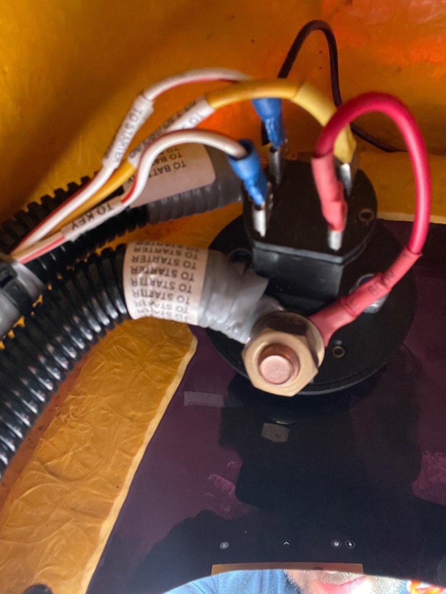

this is how the switch has been wired up.
any ideas???

Does the yellow wire go to the resistor?
Is the other side of the resistor connected to a decent earth?
Did you disconnect the wires from terminals 1 and 2 and bell out the contacts to verify which are open and which are closed with the switch on and off?

The yellow cable indeed goes to the included 3.3Ω resistor that was included in the kit and goes to a descent ground on the engine/clutch cover.
I have also bench tested the isolator before installing it and it checked out.
this seems to be happening when the alternator is producing power so phaeton, you are right, the coil must be getting power from somewhere but I am not sure from where…

I think I have some wires mixed up…
based on the diagram below, on slot two it should be interrupting the COIL line that comes from the ignition switch and goes to the coil +
My connectivity, slot two interrupts circuit 50 from the ignition switch to starter as shown in the diagram below
Hello all, I managed to solve this and the switch was wired wrong and instead of switching the coil, it was switching the starter motor! 🤦‍♂️
