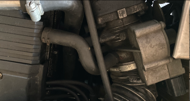

I have swapped over a new throttle body and it almost started a couple of times but I think the plugs need a clean as they're well flooded before it starts.
What's interesting though is the new throttle body does not have this copper pipe which the old one had - it connected to the engine near the injectors. It must have been some kind of vent but I wonder if others have this same connection or not?
Yes, I have one.  As you can see it goes into one of the canshaft covers.   The Haynes manual actually mentions 2 hoses and describes them as breathers so I don't know how important they are.
And I would think with clean plugs and a fully charged battery (plus a booster if you get one) she should start OK and hopefully the working TPS should stop them fouling up.
