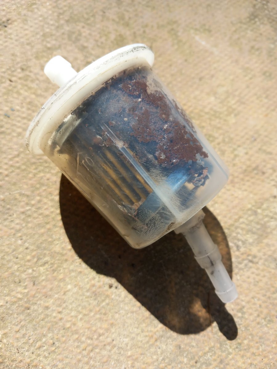

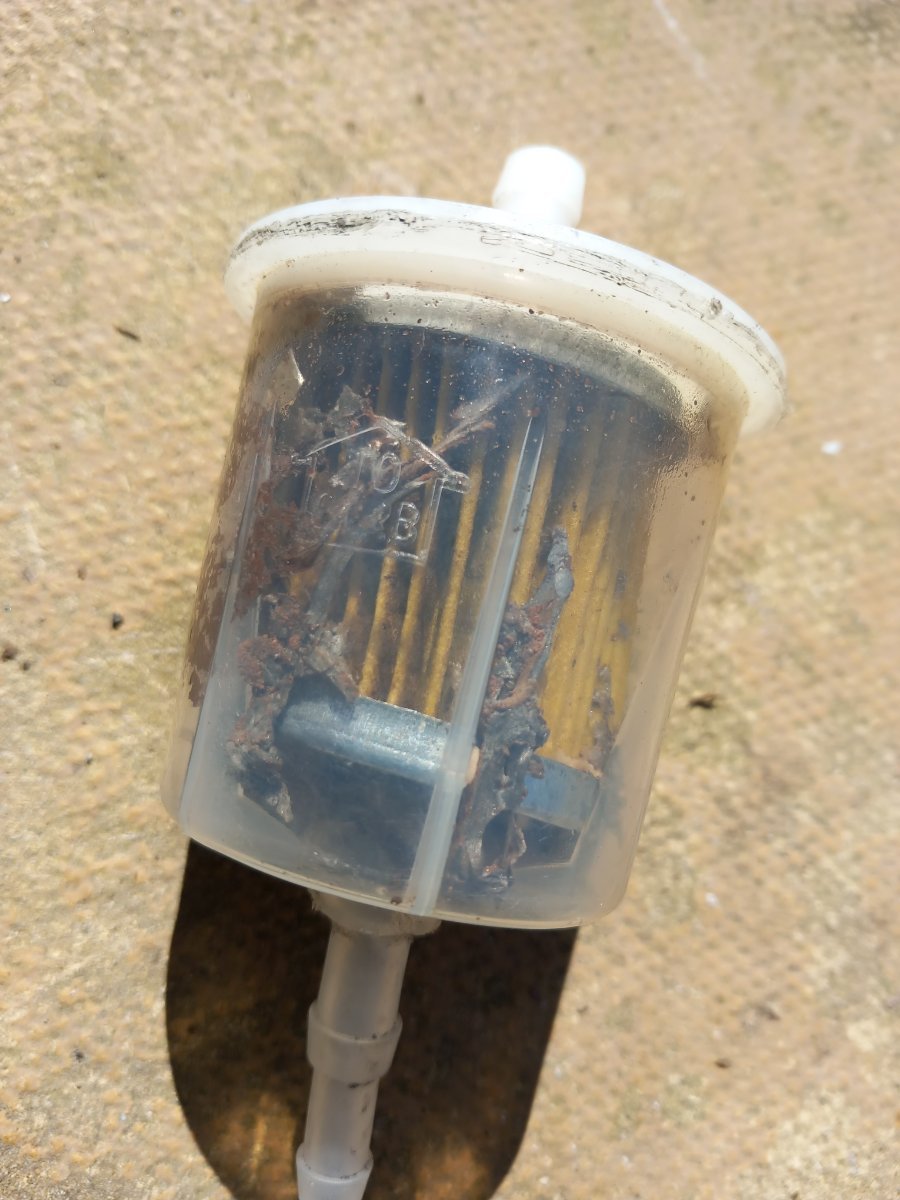

Update. This is what I found in the fuel filter - do other people find this an issue? The car was used last year no problem, the fuel was last year's, and it has a stainless steel tank. I have yet to prove that this is the problem causing no fuel to be drawn through, I suppose it must be, but I could blow through the filter and back in to the tank. I'll test it after the replacement filter and non-return valve have arrived, which should have been today.

Just to finish this off. My car is started and running well. Although the gunge in the fuel filter would not have helped, the main problem turned out to be the battery - which I had some doubts about! - it no longer had enough oomph to turn the engine enough, to get the mechanical pump to drag the fuel through. I have also fitted a none return valve, but too soon to tell if this made any difference yet.
