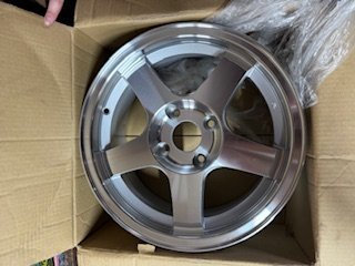

6.5J 185 to 205mm if you want to push you could go for 215mm, I would probably go for 205mm rear 195mm front,
2 hours ago, jimmyybob said:
What would be the profile size?
That would depend on what the donor car ran as ideally you need to try to keep the rolling circumference the same, you don't advise if you are pre or post IVA which means if pre you need to ensure your speedo reads correctly
Hi, and welcome to the club.
I'm assuming you've got Sierra based donor parts and so the original tyres size would probably have been 165R13 which would be roughly the same diameter as 205/50 R 15.
From your other post I see you are starting from scratch so it will depend on what speedo you decide to go with.  You will soon discover that there is no standard way of doing things on a 2B and it is very much up to the builder. You can build it to suit yourself as long as you comply with all the IVA rules and requirements, and you'll have a car that's unique to you.
Good luck, there's loads of members on here who'll be willing to help a fellow member.
