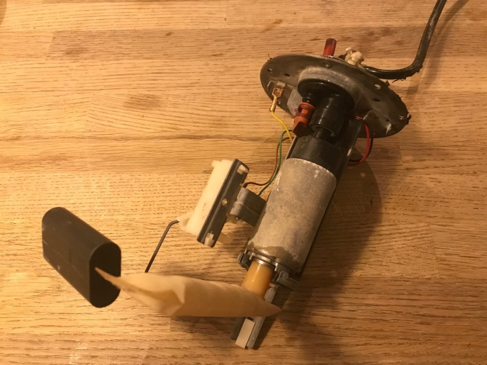

Unfortunately the fuel pump blows the 10 amp fuse when it is energised and does nothing else.  The question is, can the pump be removed from the sender unit or is a whole new sender and fuel pump required?
Thanks,
Jon
Yes, easy enough to remove the fuel pump from the unit. It simply clicks in/out and is held in by the 2 tubes.   But be careful getting the replacement as there are subtle differences between models, mainly the shape of the plastic base that fits into a similarly shaped plastic base.   Having said that I managed quite easily to fit the wrong pump with a bit of bodging/bending/forcing and it still worked.   You might also have to a bit of rewiring, but it’s very straightforward, there are only 4 wires (2 for sender, 2 for pump.
