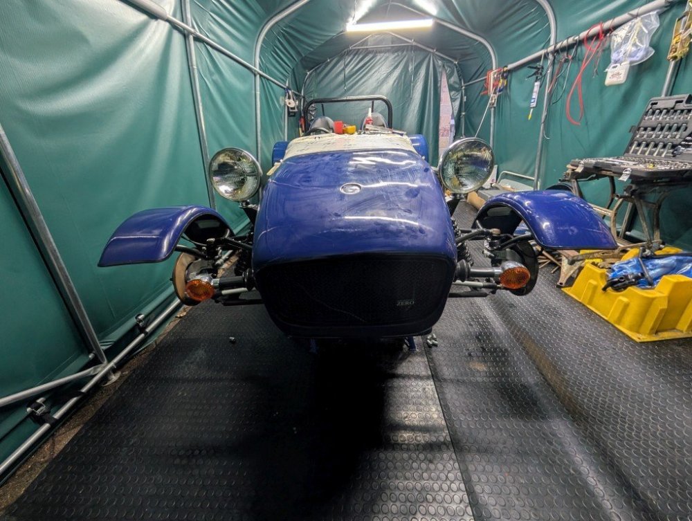

Quick visit to the store this morning to do some checking and measuring.
Most important job was to remove plugs, squirt some 3in1 into the cylinders and turns the engine.  Had been losing some sleep on this, but no worries and turned sweet as a nut.
Checked I had brought the correct stacking relay mounts - check ✔️

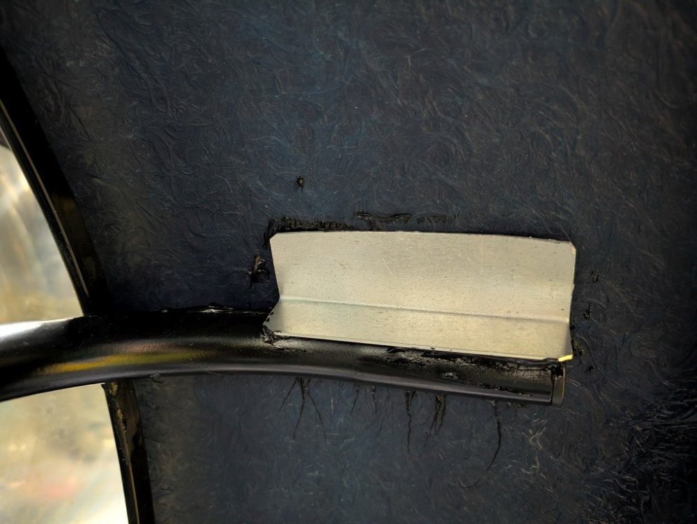

Did a test to remove some of the parted sikaflex seal - nice and easy with a Stanley knife.  New sikaflex 552 and aktivator-205 on order ✔️
Removed stalk switches to check p/ns and age for correct wiring diagrams - sierra 1990 ✔️
Garage tent arriving on Tuesday, so hopefully will be bringing it home next weekend.
