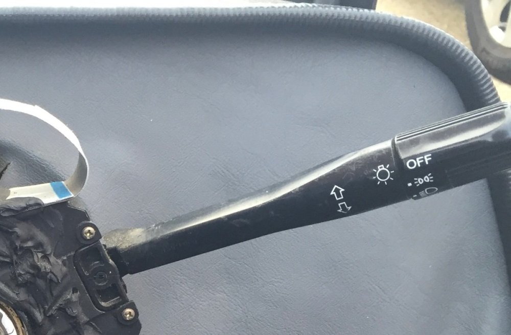

It’s on the column but not sure if original as I have a spare column set in a box that may have been the real original. Looks like a rover one though
This is the RH supplied Rover column light switch if it matches yours? When you’ve checked all the fuses for the lights are ok, then check the wiring at this switch. No loom connector was supplied so you had to use small female connectors to wire directly to the exposed pins on the switch base. Mine were not very secure and on occasions came off or moved and touched each other. There are 2 groups of pins. On my car they were wired as follows:
3 pins for 12v power from flasher relay, to left & right indicators
6 pins for lights:
1: 12v for sides
2: to main beam
3: to sidelights
4 & 6: 12v for headlights
5: to dip beam
Check yours are all intact.
