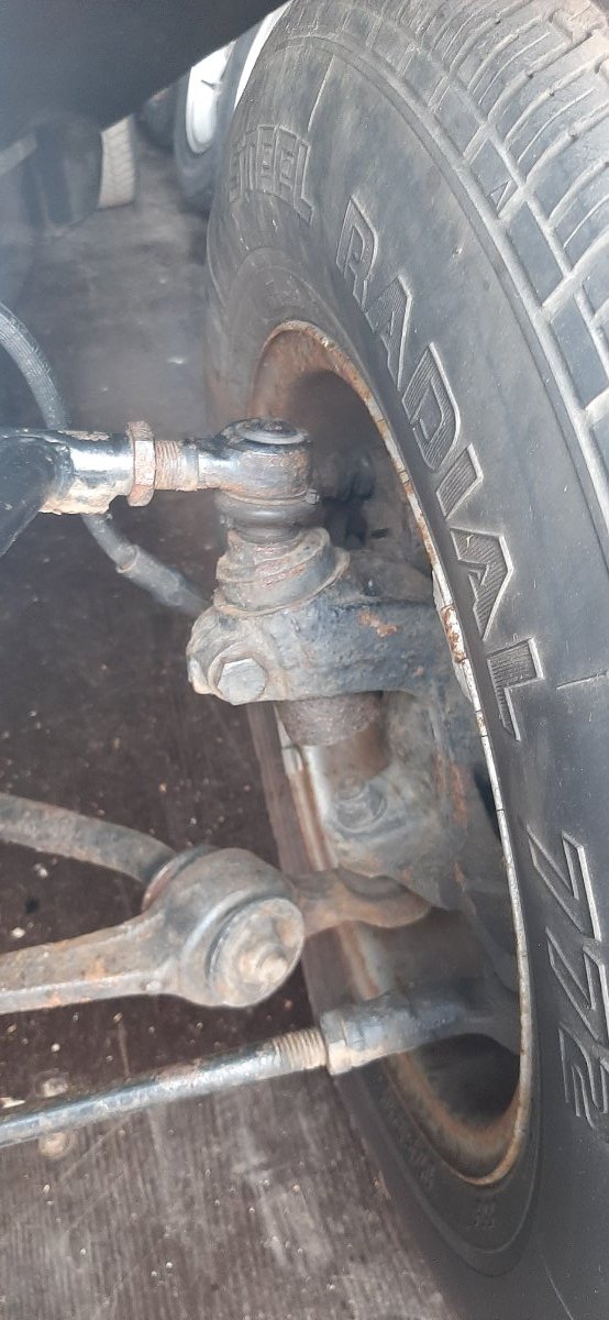

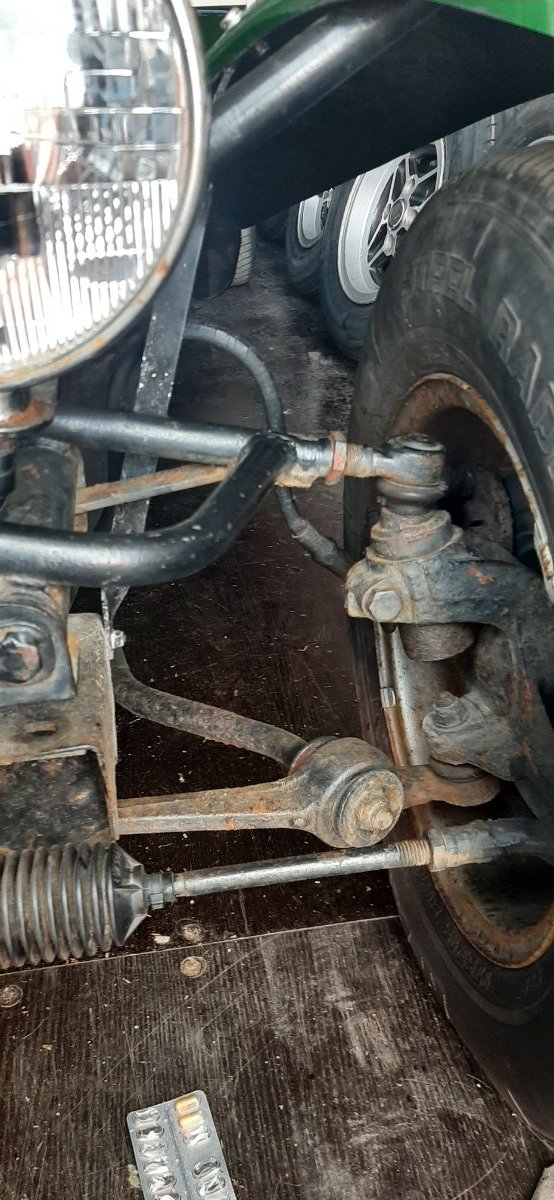

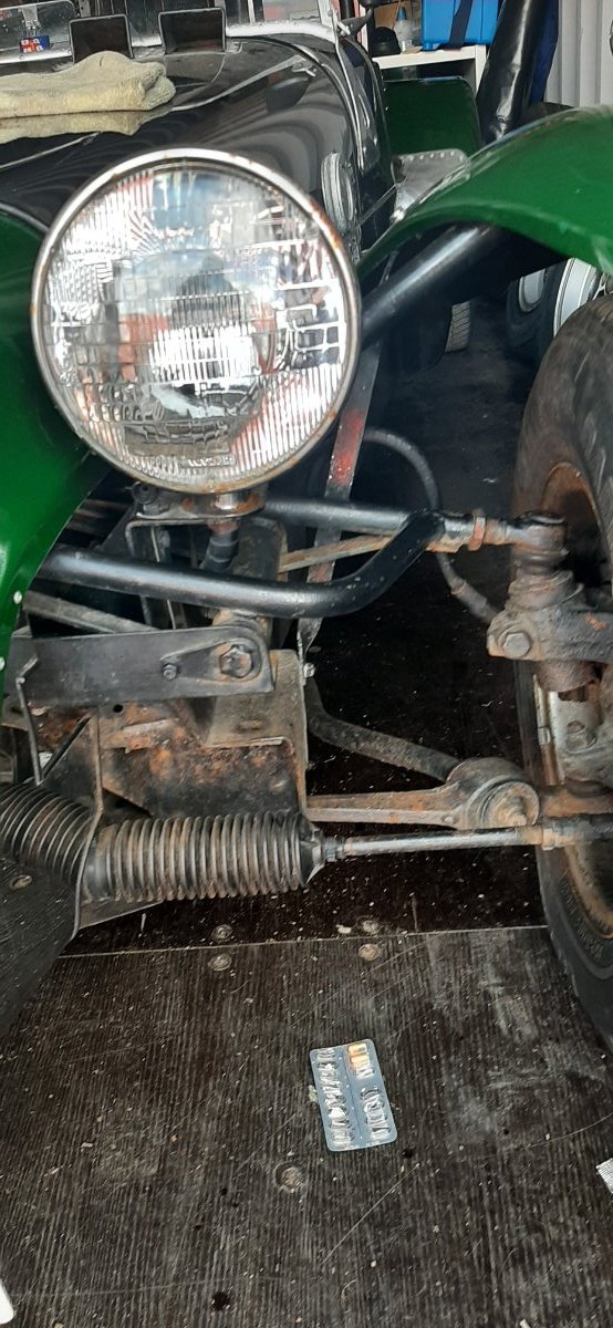

Hi all,looking for info please,I have a robin hood 2b,I am.looking to change from the Morgan type wings to to short over the wheel type,,,also hoping to add 15 inch wheels,,,,now,do I decide what wheels I'm.fitting then decide on wings? Or is it wings 1st,I've spoke to 2 different guys n I'm getting conflicting advice,1 guy says I need full wishbone replacement kit,other says just pop onto ball joint,,,,as I'm new to this,,,,its confusing,hopefully someone can simplify this for me,thanks,20250827_173138.thumb.jpg.59a6fcd1277f8011640b237d2ad7d4b6.jpg
You need a variation of these. these are for a sierra hub, it looks like you may have cortina hubs?

That looks like sierra front end to me.
