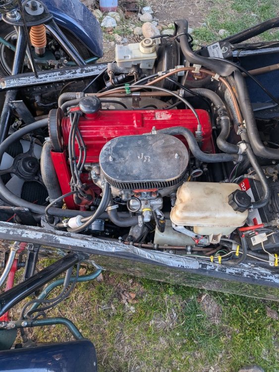

I have a 2.0L pinto. Unfortunately when I've acquired, the car the carburettor was not working fine, the father of my mechanic cleaned it but didn't touch anything else as he's quite old and didn't know much about them and no one else worked on carburettor. After the cleaning it got better, at this point I will disassemble it and check the components against your list to see what I've on it and work from there.
It can be tricky to get a degas (from a v6) working correctly on a pinto, it was a long time ago when I set mine up, apart from the main jets being a bit big there are a couple of the little brass air jets (pressed into the casting) which need changing and possibly pump jet a big big. I assume it’s not a standard engine?
A 32/36 dgav is easier, and and the choke size of the smaller side is only 1mm smaller than the degas.
The Dgas feels more powerful as both chokes open at once instead of progressively, but ultimately power is pretty much the same.
From the looks of it i think it's a pretty standard 2L Pinto, i don't think it's modified in any way, i bought it here without much information and the previous owner bought it from a friends without any particular documentation.

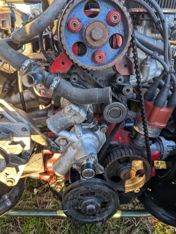

Here a couple of photos of it
Looks like an adjustable cam pulley so it may not be a std cam at least. But personally I would try and get a 32/36 with standard settings to get it running. Where are you?
Next time you take the cam cover off use a mirror to look at the end of the cam it may have a number on it.
