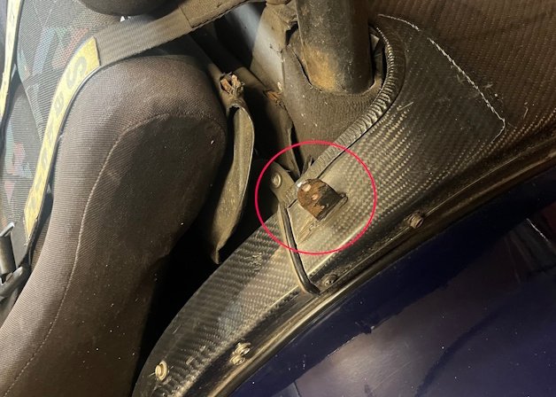

This the mounting bracket.  If you don't have it already you will have to remove the plastic cover to fabricate and fit it.  I have never done that so have no idea how it is mounted to the chassis.

This next picture shows the mount in more detail, you can see the long hoop is mounted to the bracket and then the smaller hoop is mounted to the large hoop above the bracket.
