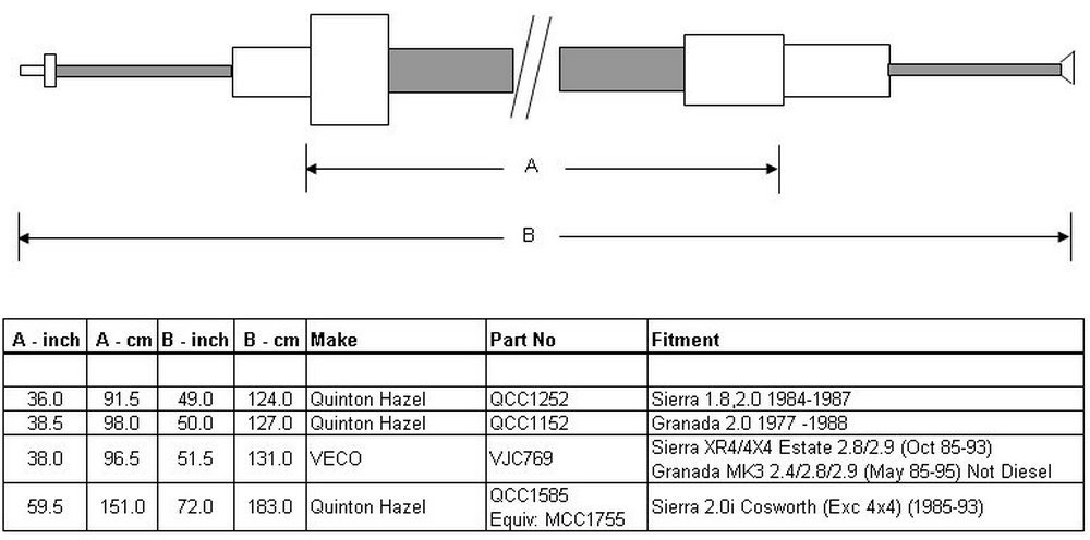

Unfortunately there are that many possible combinations for the accelerator cable that you'll have to take the old one off and try to figure out a suitable replacement. If you put a picture of the 2 ends and the length on here someone will probably be able to identify it for you.

If you have the Sierra pedal box and a type 9 gearbox the standard Sierra clutch cable fits, however, it is better to fit a longer one such as the Quinton Hazel part number;  QCC 1585, which can then be run round away from the exhaust & manifold.

I'd really like to get a spare clutch cable, but I expect it would be the same advice, i.e. get it off and measure it?
I have used the clutch cable off a 2WD Cosworth sierra as it is a bit longer than the standard sierra cable and thus is easier to pass round the exhaust.
When I get the kit out tomorrow I will look at the part number provided my age brain remembers.
I'm pretty sure the QCC1585 is the cossy cable but it would be good if you could confirm.
