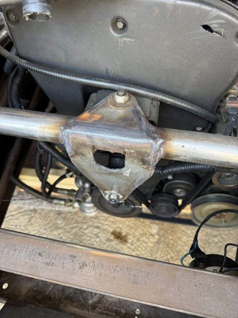

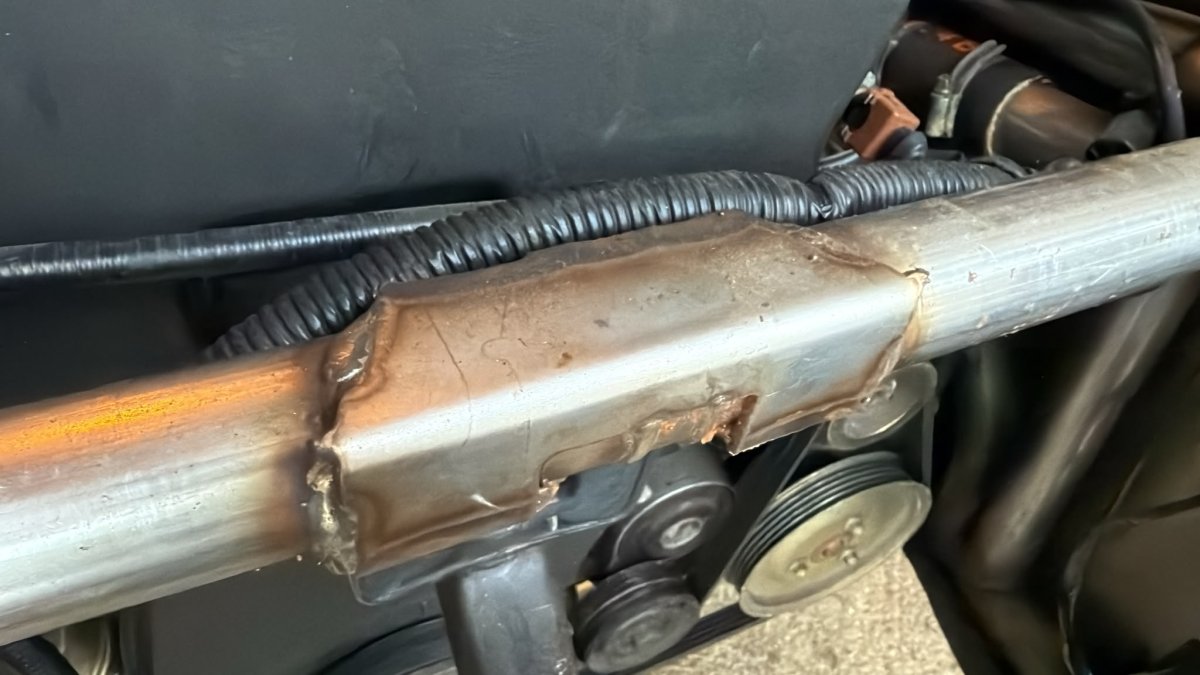

  3. A nice man called Adam came round today, welded back on the broken pieces and then fabricated new parts to strengthen the whole assembly. So problem solved.

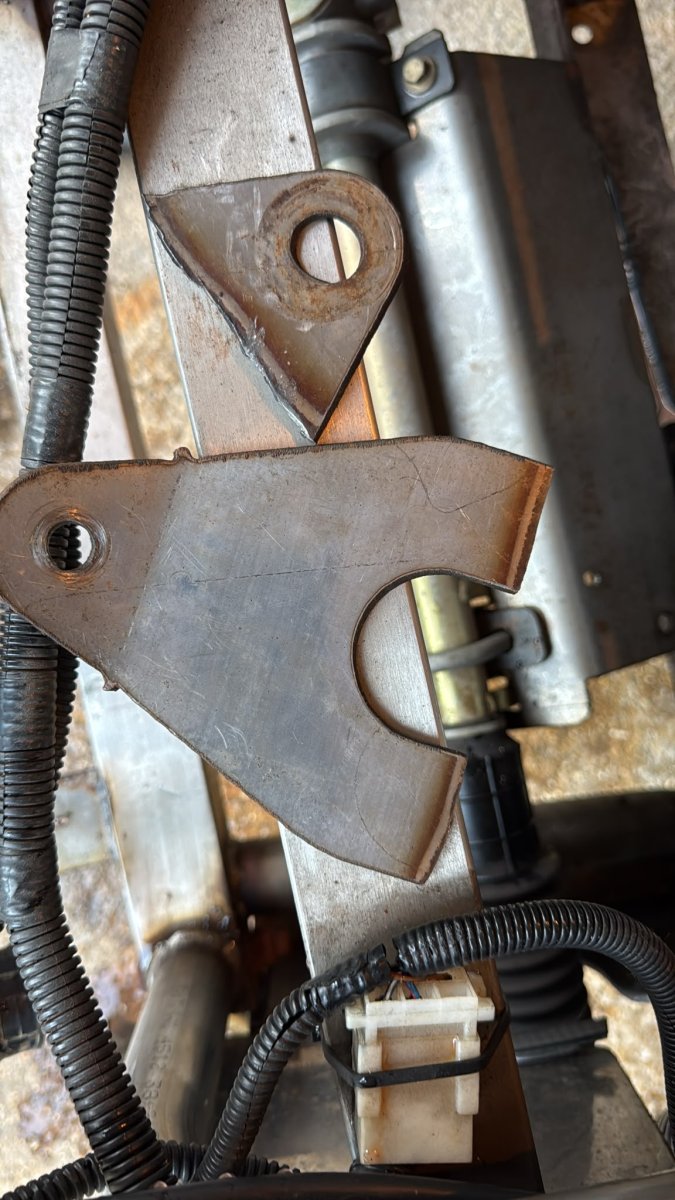

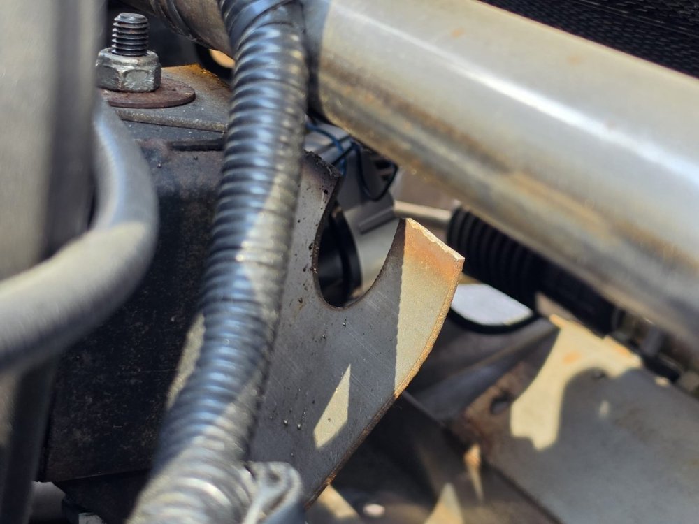

  4. Thanks Andy. Pulled the rad out tonight and this is what I have. Now I have to decide if I want to get a whole new mount fabricated or get the exiting bits put back together and strengthened.
  5. Thank Andy. Looks like stripping down the front end is the first job to see what remains of the old mount and then work from there.
