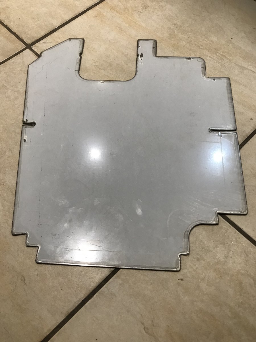

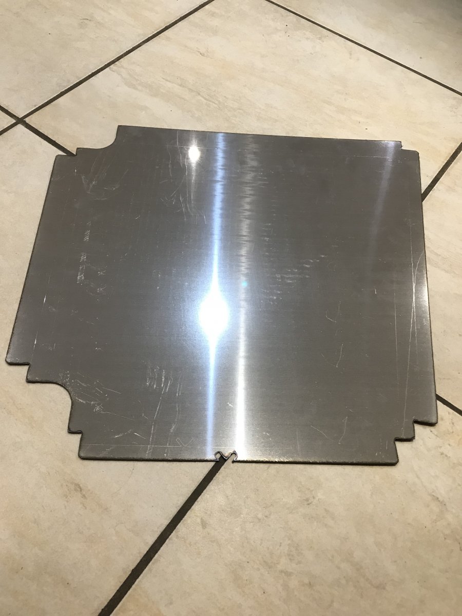

Can anyone tell me if these are foot well front panels? Does anyone have any photos of them being fitted or any advice on fitting them in place please???
I’ve just found my kit car buried in the garage after many years, any help/info/tips would be much appreciated!!

Correct the one with the cut out is the drivers side the other the passenger side. The corners that are radiused go around the tubed chassis. If you search YouTube there are the build videos albeit rubbish they will show you where to place the folds.
