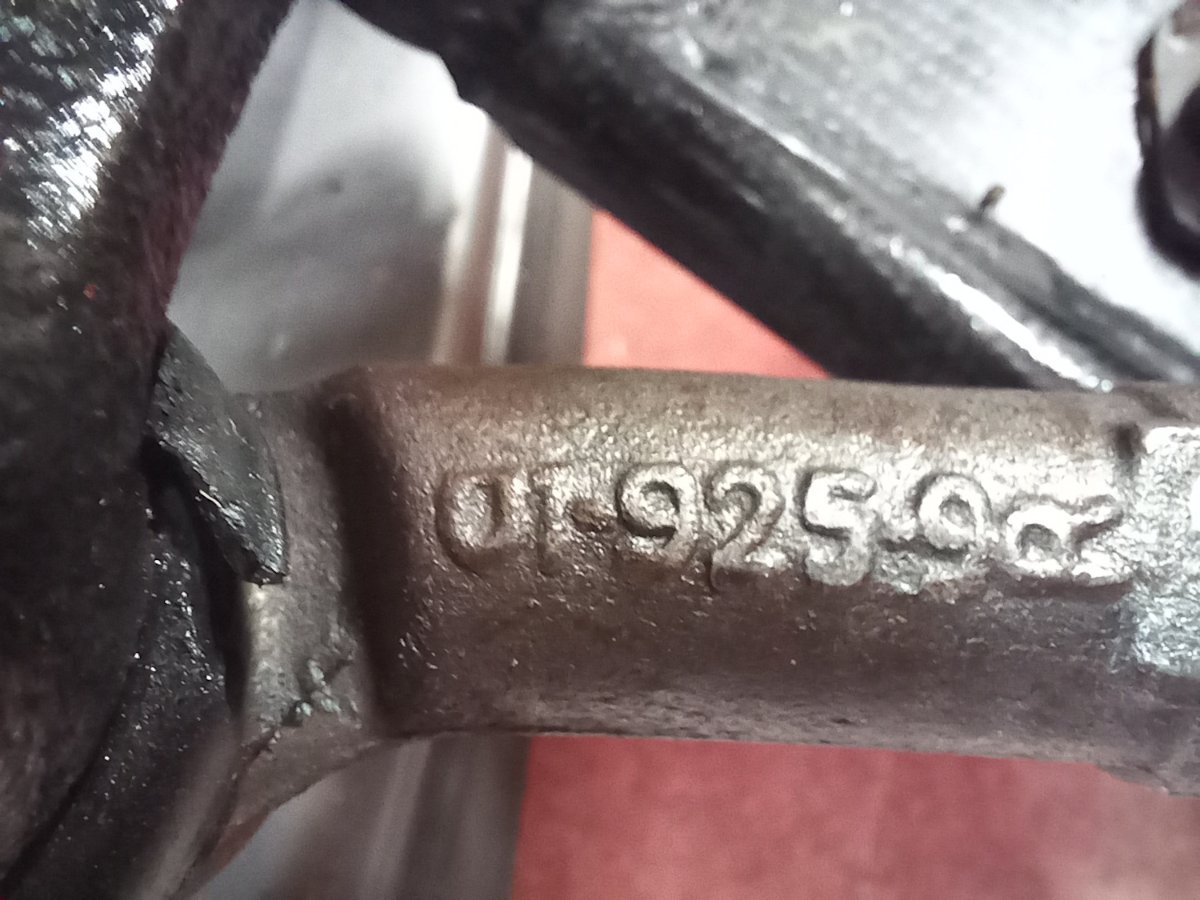

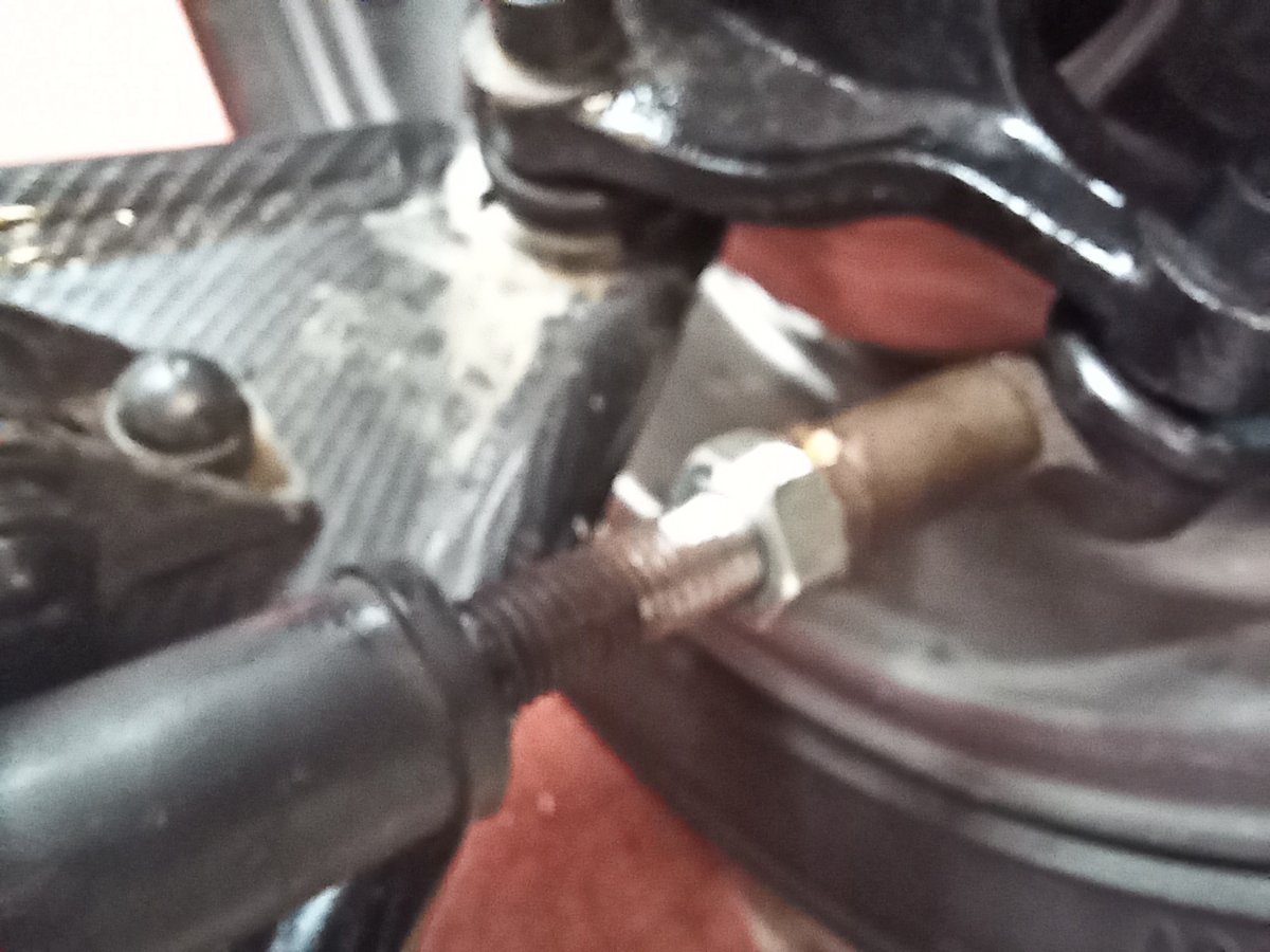

Just to finish this one off. I ordered one track rod end for an Escort - definitely wrong as it had no offset - there are loads like that. Found some offset ones that look right, but most have no measurements, some are much longer and I don't think these would fit. Found some Sierra ones, that are indeed offset but they don't look like the ones on my car as they have a have triangle on front of each - I have a sneaking suspicion that these would fit, so I was holding these as a reserve. Found one described as for any Sierra based kit car and looked perfect, but the wrong side, so I rang them and asked of they had the other side, they pointed me to another which looked completely different. I pointed that out and they said the picture was wrong on the one that looked right . . . . damn! Found others that look the same, but although listed for various Fords are not listed as for a Sierra - I have a sneaking suspicion that these would fit too. By this time I had followed Foz's advice (above) and ordered some Sierra replacement rubbers and have fitted one. I think it would have been better if it had been a slightly tighter fit, but I think that it's done the job and I will just monitor it periodically. Tracking tomorrow, just got to decide how much toe in to ask for. Then MOT Monday.
Just Googled the rubbers, loads around. I wish I had measured it while it was off the car!
Thanks for the info I am thinking Sierra too now, but there seem to be several versions so I still need to be careful when ordering. Very few show the joint from above which would really help! I wasn't aware that you could just get the rubber, that is all I need really - it has split might have been me getting it apart to replace the steering gaiters, not sure. Any ideas where I could just get the rubber from?
I need a pair, or at least, an offside track rod end. My understanding is that the rack on my car is a Ford Escort, not Sierra - maybe they all were? Certainly the steering rack gaiters were ordered for an Escort and they matched and fitted. My existing tie road ends are sided - see photos of the o/side - the nearside is a mirror image. I ordered a pair of Quinton Hazel items for an Escort (or at least I thought I did as there were 2 in every picture!). Only one has arrived and clearly it intended to fit either side and doesn't look like to would my car any way. I Googled the number on the item, but didn't get any hits. Can anyone advise on a part number or source or the car it would have come from? Could it be that the track rod ends are Sierra fitted on to an Escort rack? Looking at images on line perhaps I should add that mine have a tapered end that fits into the hub carrier. Some of those I have seen on line don't appear have that.
