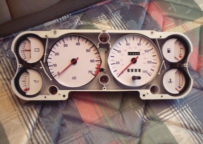

Hi Col, I made my own white faces for the clocks, came out very well (even if I do say so myself) I printed them onto normal semi-matt photo paper, then used spray glue to fix them over the old faces. Once they're firmly fixed cutting out the number slots etc is quite easy.
I will try and remember to take a photo tomorrow.

This is the finished article. If you want a copy of the graphic, just send me an e-mail direct, so I can send you a better resolution pic. bob.rowell69@tiscali.co.uk

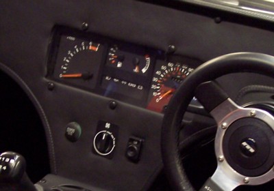

Hi Col,
Is your dash like the att pic? if so, I am intending to make a white face set in the New Year. Just send me a reminder.

Hi Bob,
Yes, spot on... let me know as and when.
