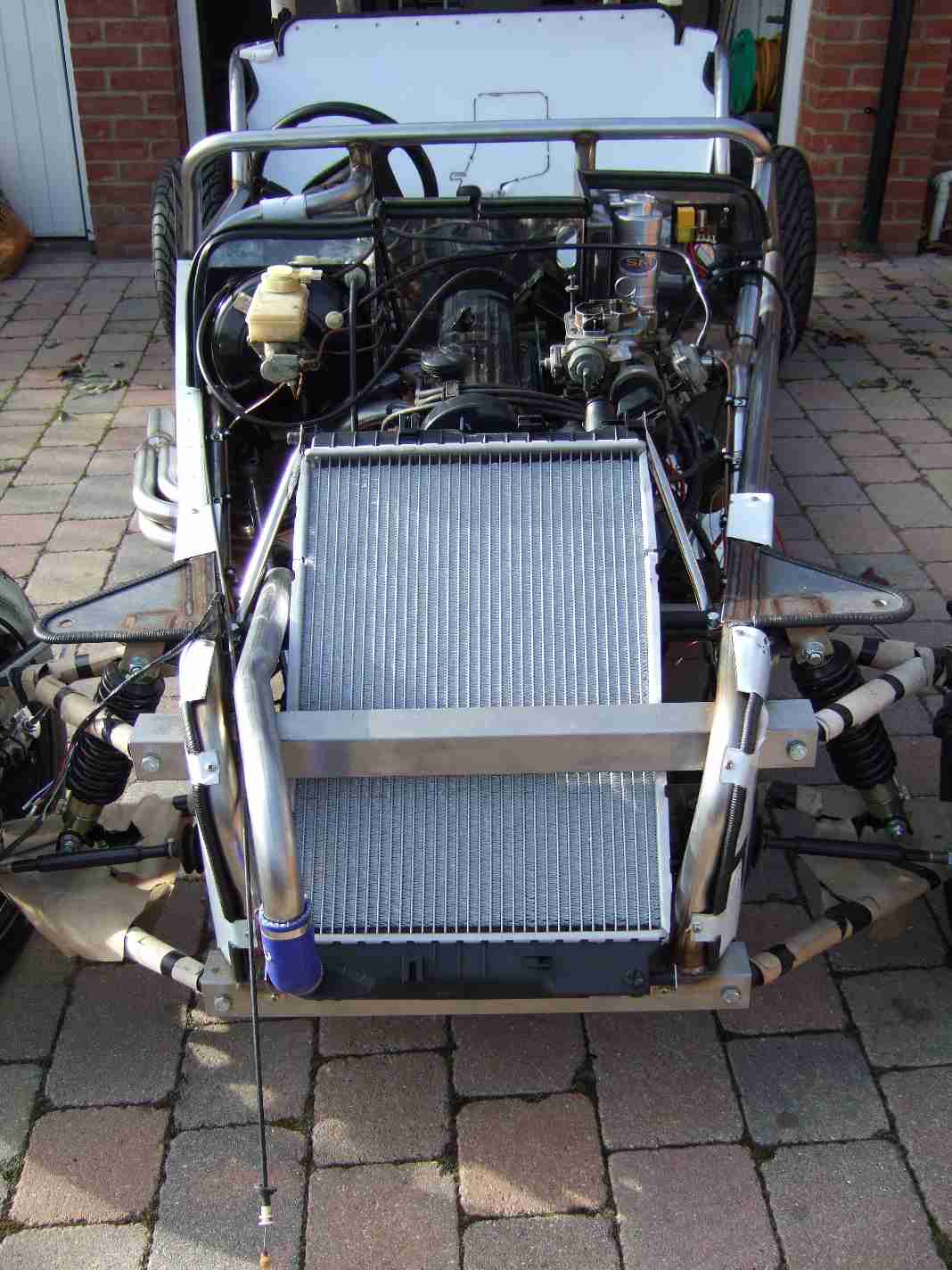

I've got one of the coolman rads too. mounted the same as terry barry. I still have the viscous fan behind and an electric fan in front too. I don't think the electric one has ever come on! I've cowled my rad to get as much airflow over it as possible. Pics below, in my garage.
Robin

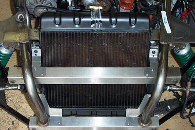

I have the radiator as supplied installed as per photo. Here's hoping size really does matter...post-1992-1181340775_thumb.jpg
