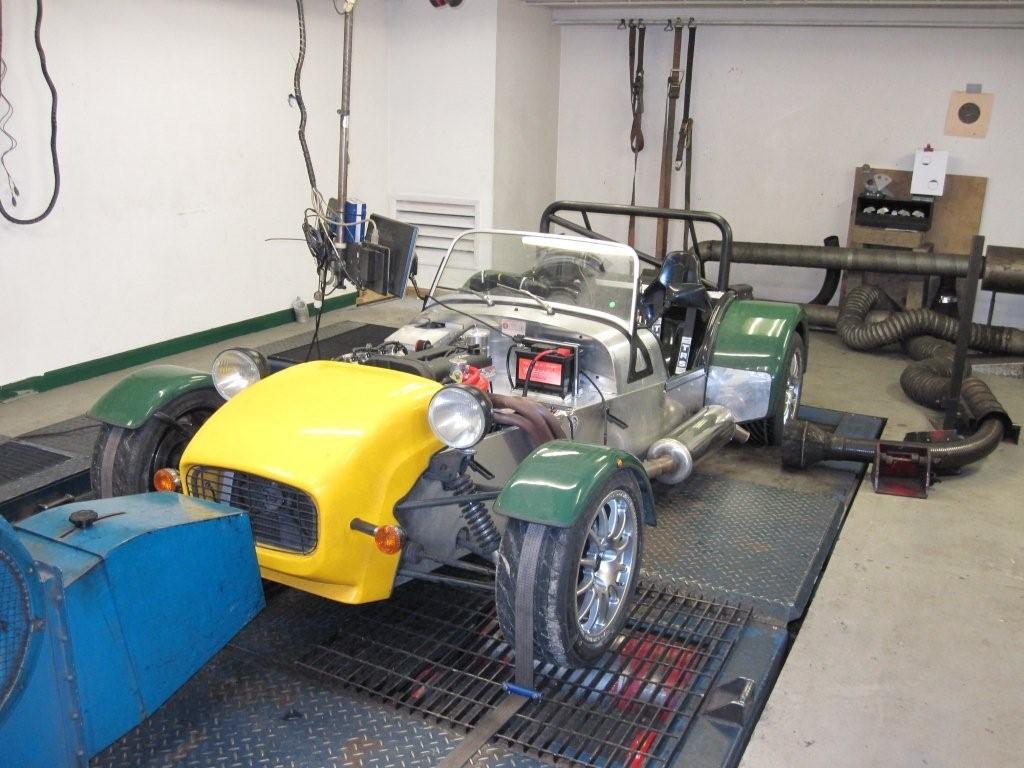

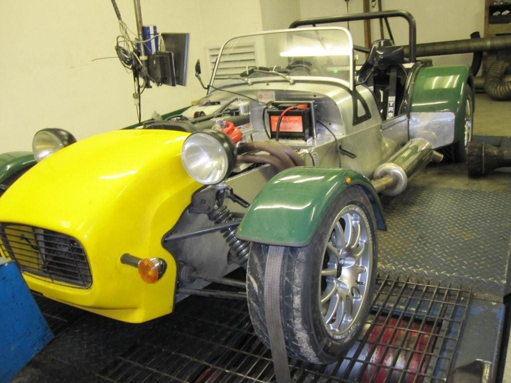

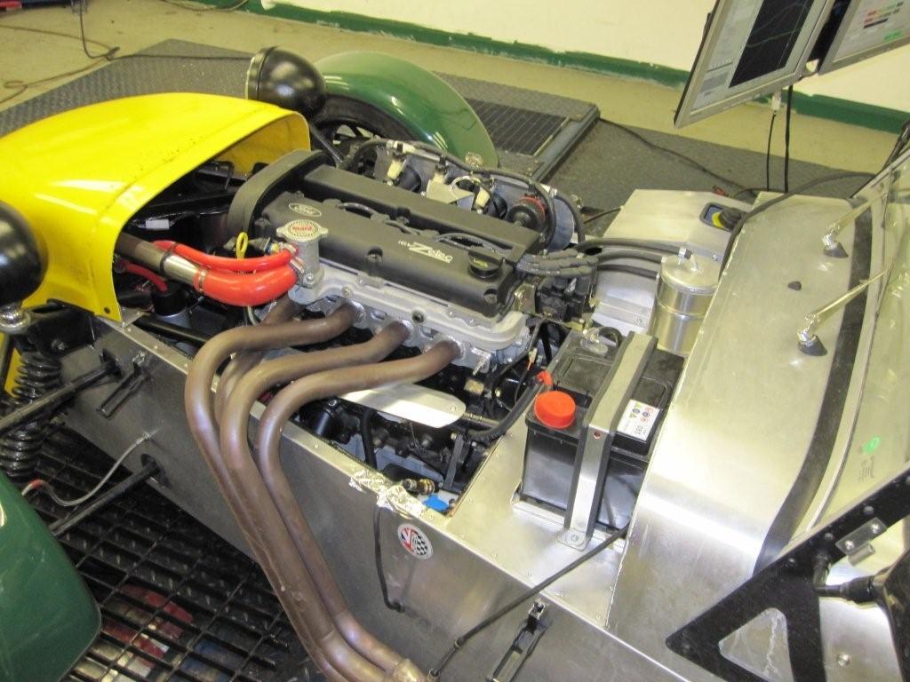

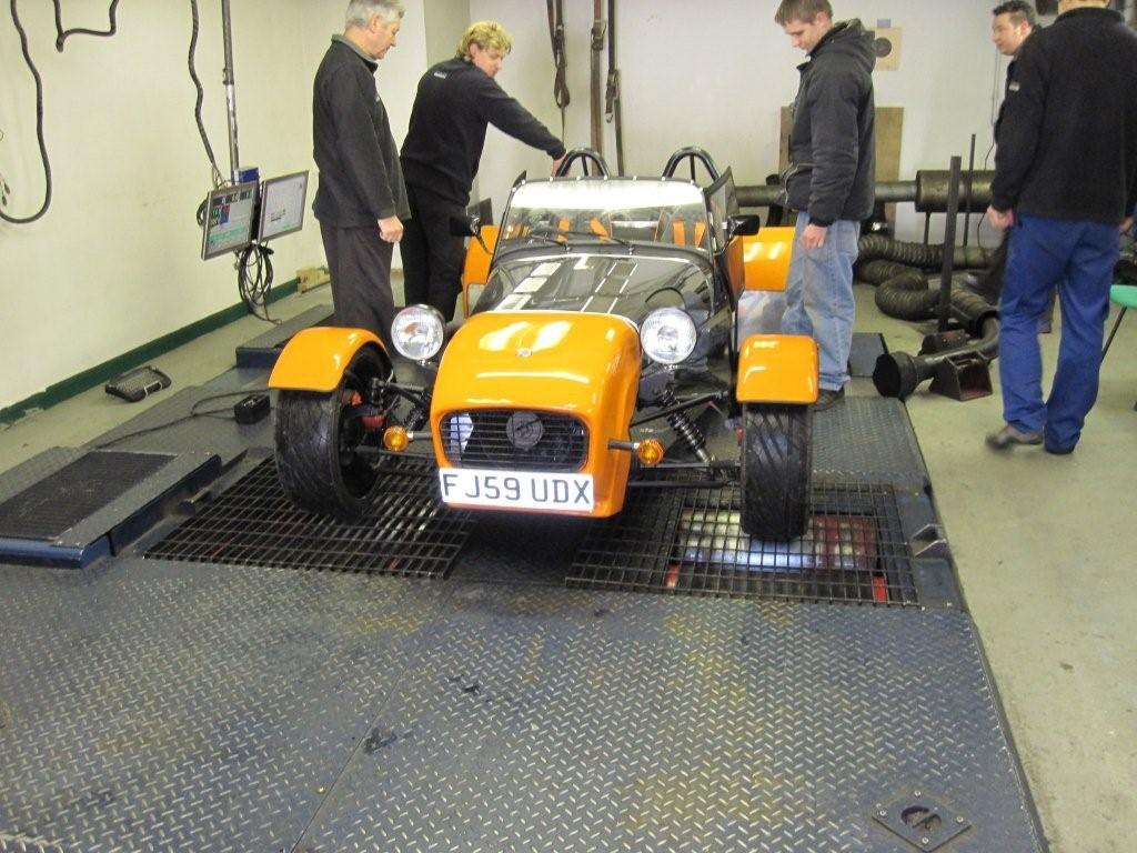

Thought this might be interesting, I took two Zeros down to Emareld to be mapped one with a 2ltr zetec on 45mm jenveys and the other a duratec on 45mm jenveys they both had the same exhaust manifold design but the duratec had a high flow Cat before the silencer.
Zetec made 175bhp and 152lbf
Duratec 185bhp and 159lbf
If any one wants a copy of the maps i have them.
