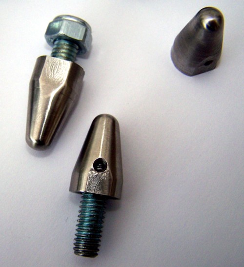

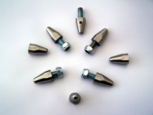

Here are some Stainless Steel bonnet guides I knocked up out 1/2" stainles threaded rod. They are 6mm thread x 10mm AF X 22 mm long.
They only took a couple of hours the knock up 8. The biggest problem was finding all the tools after not using the workshop for six months.
Any ideas for inprovement welcome.

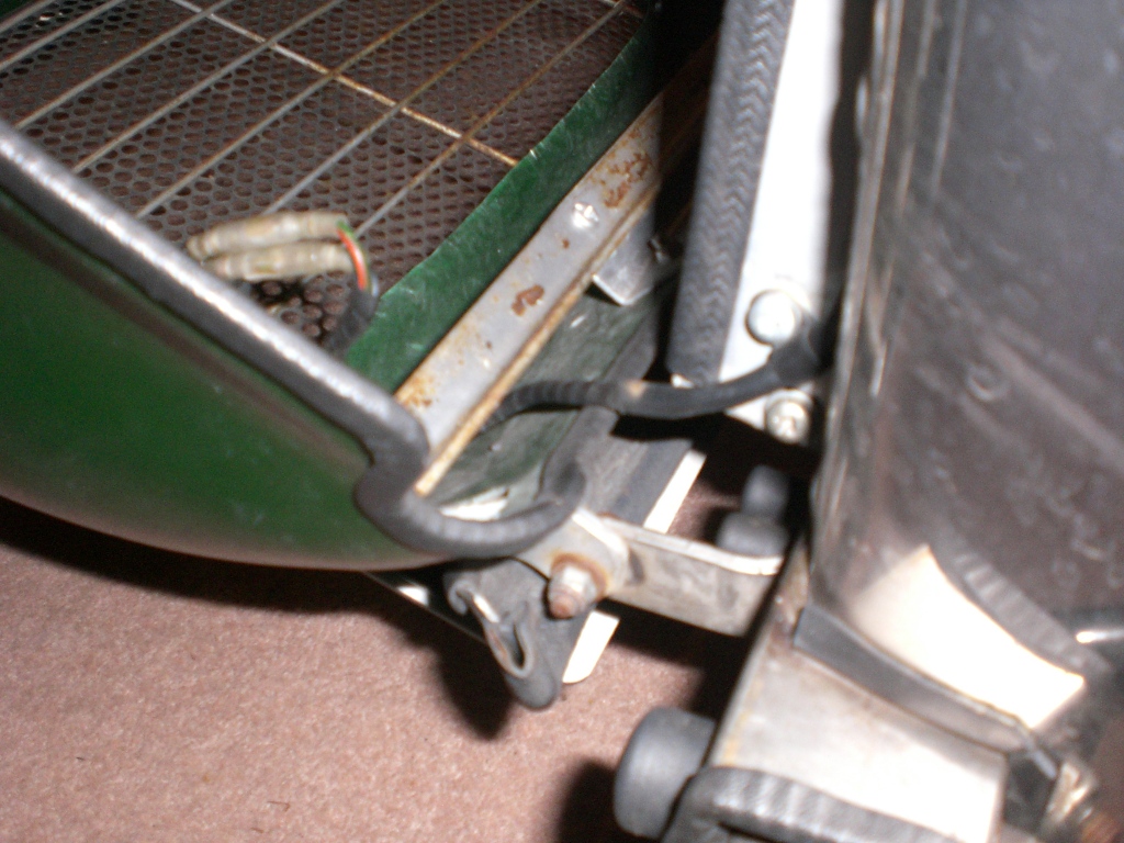

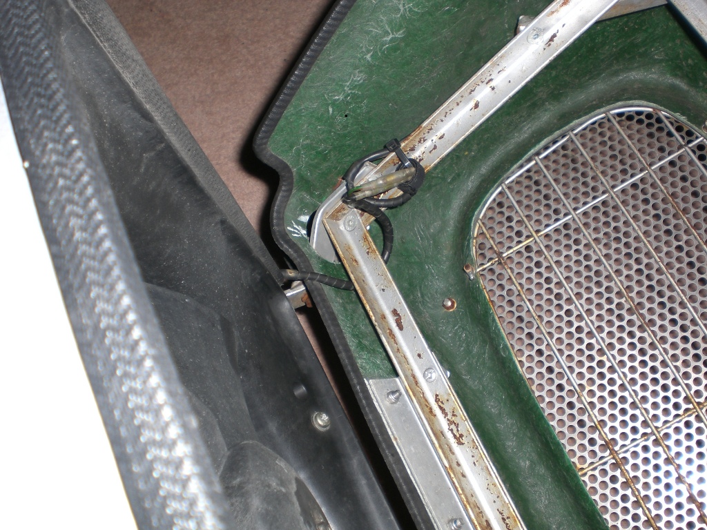

Yes, I cut a hole for the framework on each side to reach each hinge using a hole saw on the underside of the nosecone, but it's not noticeable.
I'll post a pic or two tomorrow.
... Darn it!
Very sorry - Forgot to take pics.
Won't have time tonight, but WILL post some tomorrow evening.
OK. Here's some pics which should hopefully show the hinge arrangement on my set up.
All pics are of the nearside hinge.
This is from the underside with the bonnet closed, showing how the framework goes through the drilled part of the nosecone.
