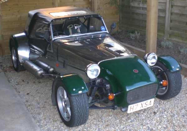

  10. Hi All, This is parked up at work. Lovely, but just can't quite put my finger on what's spoiling it somewhat?

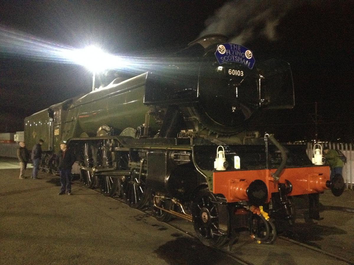

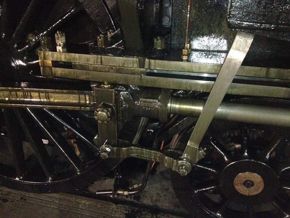

  19. I went to see her 'Up Close & Personal' at the NRM a week last Thursday evening. It was the day of her run to York from London. Still under light steam and still warm. I'd include a couple of photos, but that doesn't seem to be possible these days - or is it just me? Sort of alive and it was a great sight as you don't normally get to see these machines like this under these conditions. Running gear was 'Total Loss' according to the Fella on the footplate. So, hot, steamy & covered in oil - Ooooer!
