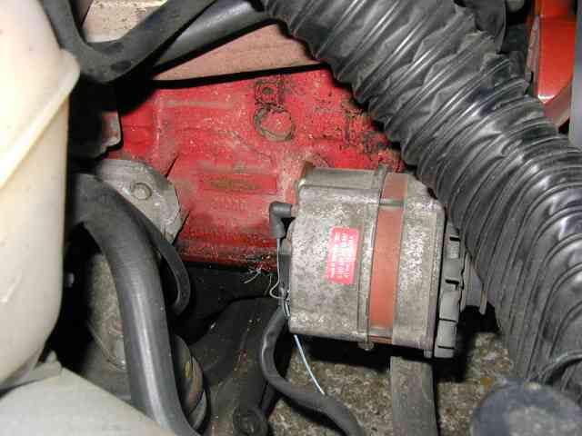

Ok, I just went to have a look and see if I could match the engine number to that on the V5! Well, attached should be a picture showing where I am looking! Is this (the flat plate raised from the surface) the correct place? If so then I think I may be in for some fun as there doesn't appear to be much there! The engine apparently had a rebuild, but I am wondering whether they just swapped it out. Any help would be greatly appreciated!

Does it have any numbers on at all (it is difficult to make out in the picture)? Mine was a real bu**er to read I couldn't really make it out until the engine was out and I had wire brushed it clean.

I'll bet it's there, it's just been painted over. Wire brush the paint off the raised bit (use a drill one) and I'll bet you find it.
I am going to take a bit of cleaner to it tonight and try and wire brush it off a bit... I can't see anything at all on the little bit I have scraped off, but I will keep trying! I think someone has put neat antifreeze in the system in the past cus the paint is coming off and all the coolant pipes are new! The other side of the engine has pristine paint, but as you can see this side isn't in very good nick!
Yes that flat rectangular area is where it should be.
I think the engine has had a paint job - I thought that they were all black on leaving the factory

They're always difficult to read (especially when they're 10+ years old). They were never stamped very deep (so don't be too fierce or you'll obliterate them yourself) and never straight (Terry - have you re-stamped yours coz Ford never got them that neat). If you are careful you may be able to remove the paint from the flat and leave it in the numbers. At the VRO the inspector rubbed some chalk on the area and then wiped it off again leaving some in the indents of the numbers.

yes that looks like the spot where they should be!! mine where there my block is black (original) to make the numbers more prominant i smeared wet tipex over them, it does the same job as the SVA chalk. ;)

I have cleaned it up as best I can with it in situ (I will be removing the engine over the next week!). There is something there, but I cannot make it out... I will try the chalk idea, but I am not too hopeful! I tried the old 'primary school' styleeee wax crayon and bit of paper, but things were no clearer! As far as I can make out the first letter is an 'f' but it should be HP68674. Ah well, I'll find out soon enough, and if not then I shall be borrowing some stamps off my mate!
