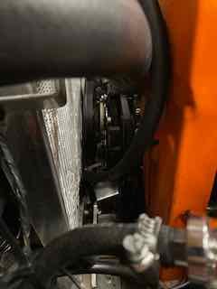

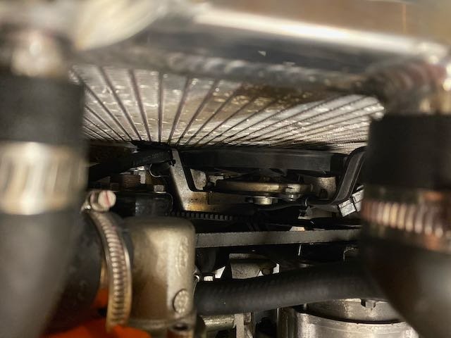

    Young black and gifted, but failing at all three.

  5. So I had a good look at the problem at the weekend and discovered the following: - That tiny fan is indeed wired up backwards and pushing against the airflow In other words - it's doing f%^$ all, badly - There are gaps around the rad so large that I expected to find a Romanian clinging on for dear life. Clearly no actual air is hitting the matrix. - Previous owner has fabbed their own thermostat housing (see pics) which is a little unorthodox, as well as having crazy pipework as pointed out already. Why on earth wouldn't you just buy a housing? - The thing is plumbed as it should be engine bottom - rad bottom - rad top - engine top. The hose is brough round the front of the rad to make space for that crazy thermostat housing monstrosity. Questions - 1: Any thoughts on how to seal the gaps 2: Any suggestions on a thermostat housing I can buy.

  10. do the pics you can see in the OP help at all? I can confirm that it definitely IS overheating - stinks, steams and splutters out the cap!
  11. Thanks - that's really useful. The current fan only covers about a 3rd of the SA of the matrix. I am worried about clearance against the crank pulley, but both Spal and Airconco look incredibly thin
