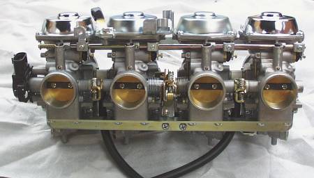

You'll have to fork out about £120-£150 for a decent set of s/h Mikunis or you could go for Keihins as an alternative.
Picture included of the ones I bought off EBay for £165.
Mick.

my carbs have just arrived (mikuni's from a zx600r) and been giving them a good look over, most things I can sus out, idle control, fuel lies, choke etc but there 2 hoses im not sure about, one muss be a vacume but dont know which and what to do with the other?? also theres a small electronic plug at the end that Im assuming is the throtle position sensor that wont need to be used??
