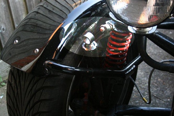

Anyway today I went out for a play and noticed when i got back both shocks were hanging off.
I suspect this is something to do with one of my above actions, but should they come off that
easy???
More to the point how do i get them back on?

I'm no expert but if you take the shock off put a bit of washing up liquid on the rubber bush it should go in quite easily.Once refitted it looks like you need a big ish washer on it to stop it happening again.
Have fun
Andy
Guest Ian & Carole
Thats right
A big washer needed.
Not too much "fary liquid" or it will keep sliding off.
