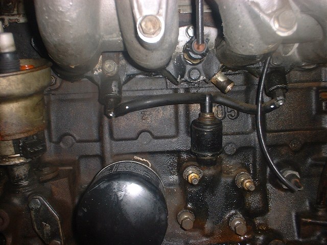

ah right ok - so from the oil seperator under the inlet manifold, where does it feed to??
Guest mattcarpenter10
found it
crankcase breather goes into the inlet of no. 1 cylinder on mine
only number one cylinder? Others have quoted going in between cyls 1&2 and 3&4.....

The hose on the Oil Filler Cap is supposed to be drawing air in from the inlet, to place fresh air inside the crankcase.
What arrangement do you have under the inlet manifold!?

Hi,
My breather comes out of the crankcase on inlet side of the engine splits in to 2 and joins on the manifold underneath on to 2 connections either side of the manifold
Dan
