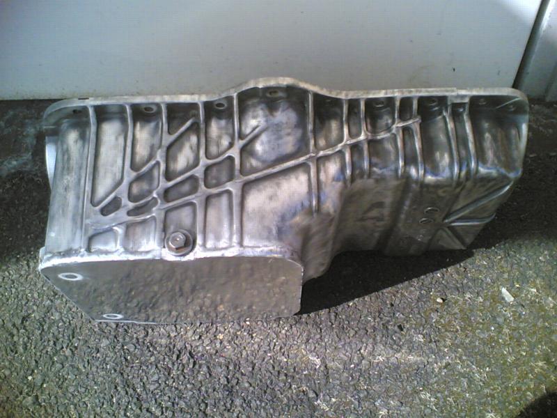

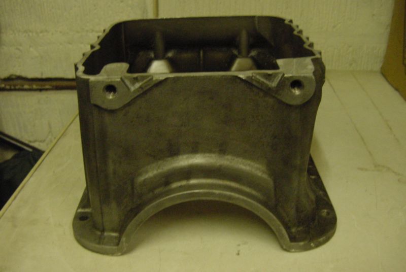

Hi Chris, Sounds great. The only fly I can think of, for your ointment is the 2.3 has balance shafts built into the sump. Not a problem as the first thing that usually gets thrown away is these shafts. And it sounds like someone has been playing with this one so that might be sorted. If you want to fit the RS2000 or the Sierra sump though the sump face is slightly different where the drive to these shafts go. Have a look at this http://www.rs2000-16v.co.uk/newsitefiles/2.3.htm. I used the RS sump as the bulge is at the front more in line with the axle. But had to modify where 2 of the bolt holes where the sump bolted to the gearbox. Also calved an 1 1/4" of the bottom of the MT75 box and one of the starter motor lugs has to go. I've also managed to get an LSD, a must for one of these. Especially if your putting 216bhp through it with a car that weighs 600KG. Sounds great, good luck.

sump and balance shafts all sorted, (thrown away by a previous owner), modified sump, no idea what, engine was in fwd Escort, the bloke I bought it from bought the car for his 17yr old son as his first car, so was putting in a 1300 and wanted the 2.3 out of the way, supposed to have been excellent in the Escort, the bulge is at the front of the sump and my car has a crossmember in the way so will have to change the sump, not sure if I can just turn it round? Done lots on the car today, just the handbrake cable to sort and the back end is finished, have to turn it around and start on the front, not bothered about it being done for the start of summer, just want it running better than the old 2ltr dohc on carb.

Ahh.... I thought you where doing a Zero. So yours is the original style Robin Hood 7. I'm doing a Zero, so no cross member. You might not have the height restrictions I have and get away with the std injection. I'm not sure if the Suzuki cam on the bodies is progressive enough, might give it a try before I panic. There's just a lot of hype out there where people who have bike TB's (not sure if that includes Suzuki ones) wishing they could afford JenVeys for the progressive throttle.
Having played with the sumps..... They only go on one way.... sorry :sorry:. Mind you if you where using the Sierra 8 valve DOHC, that sump will fit. As long as someone has made up that filler piece on the 2.3 block. I have had a std Sierra one on my RS2000 and it fitted. Just had to swap the blanking plug and dip stick around. But decided to use the original one in the end. Even the engine mounts should bolt straight on. The RS2000, Galaxy 2.3 and Sierra block are all based on the same casting.
Gary
I used the sierra DOHC 8v sump on my rs2000 engine, chopped it down to give more ground clearance and as Gary said you swap the blanking plug and dip stick around.
