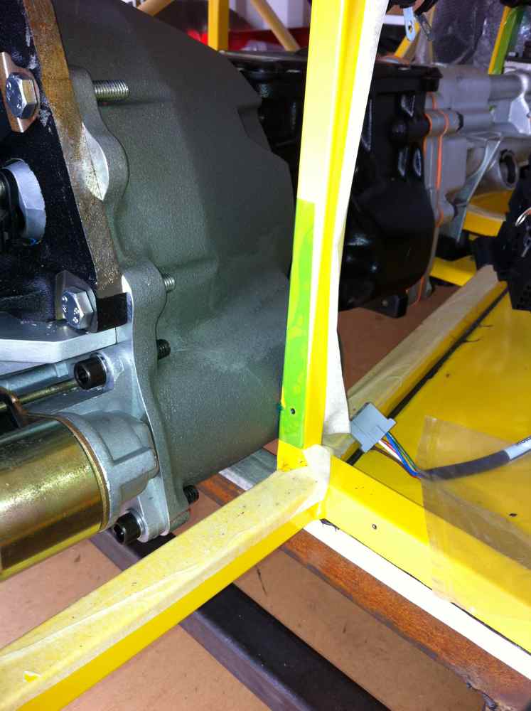

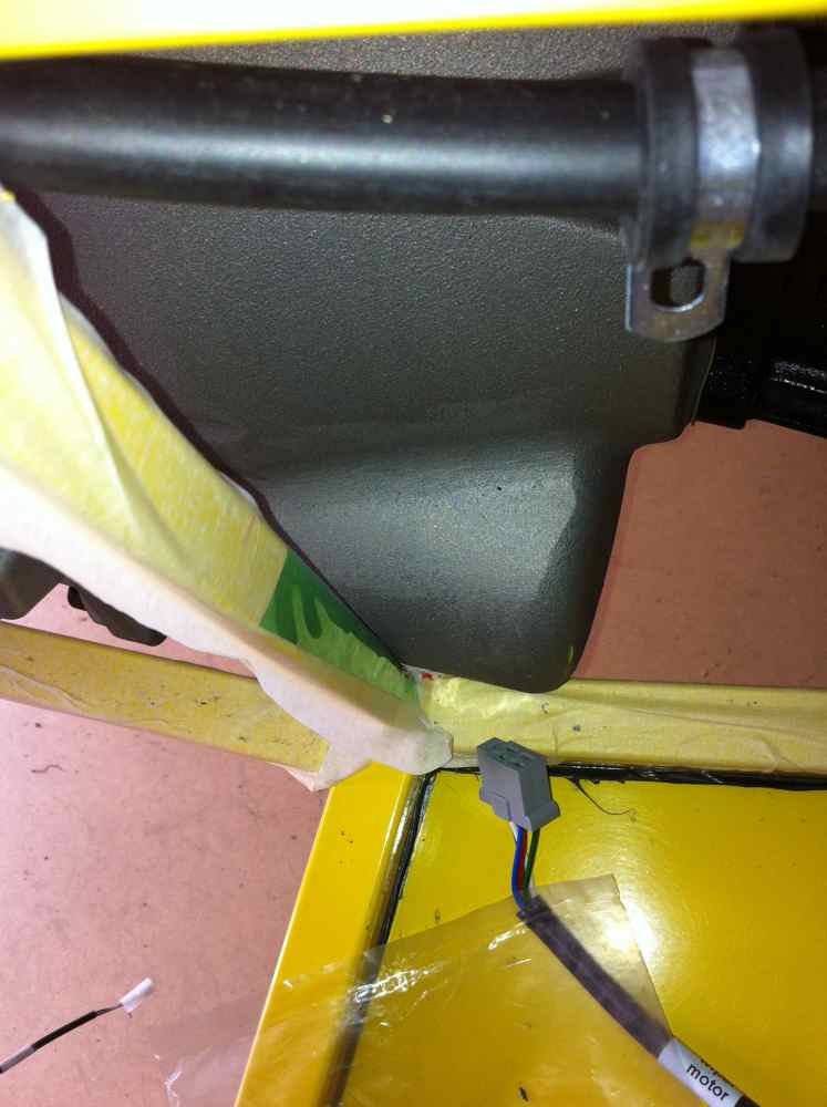

I'm fitting a type 9 gearbox to the Zetec engine in my Zero. I've done a trial fitting today and expected I may have to shave off part of the outermost lug on the exhaust side of the bell housing, as is done with the MT75.
In fact I found there was plenty of room between the lug and the frame. My problem is the huge lump that houses fresh air behind the starter motor mounting is fouling the frame (pics attached) . The net result is the front end of the engine is 15mm off centre.
Before I go slicing off a huge lump from the nice new bell housing, can I ask how others who have fitted a type 9 box have overcome this.

Hi,
That is quite a bulge on that bell housing. I compared it with the MT75 I fitted and your starter motor bulge is quite big.
If your engine mounts are equally spaced - is the engine twisted in the frame? I.e you align the geabox mounting point and the centre of the crank shaft pulley to the centre of the cross member in front of the pulley. If that is not possible because of the bulge in the bellhousing, I'm stumped for an answer I'm afraid, short of a different bellhousing or trying to modify the one you have.

I think the answer is going to be 'cut the bell housing', I can find one other blog where the builder has done just that. Just want to make certain there's nothing I've missed before doing something irreversible.
It is the only way I can see to bring the engine back onto the centreline.

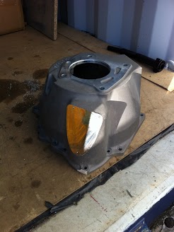

The mod to the bell housing is shown below.
For some strange reason reminds me of one of those pirate movies where someone has a head injury fixed with a metal plate screwed to the skull.
Check out my photo`s you will see a photo of me on my hands and knees cutting the bell housing, the bulge was for the old Bendix starter motor.
I bet that took some time :) ,looks like the original steel bell housing.
Ian
