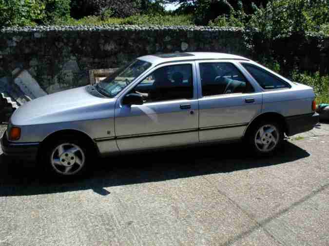

Well, I have finally found a sierra... I am now the proud owner of an E-reg (early '88) Sierra 2.0 GL. I paid the princely sum of £110 for this beast which has a set of alloys with 3 new tyres (receipt for £160 from a month ago!), half a tank of fuel, tax till september (time to get the rebate :rolleyes: ). The engine was officially rebuilt 7000 miles ago, but it needs a bit of work on it. The car also has a full set of steelies with it, so I could flog the alloys as well! It also has a towball which I reckon I might be able to sell...
By my reckoning I think I may be able to make some money on this car :D :rolleyes: :D (although I haven't decided if I am going to flog the alloys yet).
I am one happy chappy! Let the destruction begin :) !

I am going to label up the loom correctly (just in case) but I have the (and yes I know this is like a swear word on here :rolleyes: ) Vicky Green Loom coming with the kit (which I pick up in 2 weeks :D :D :D ).
It is a carb'd car... Although I am not sure whether it is one which will work with the loom you guys all hate... I am going to have to have a look at the documentation sent down about buying the car, but in the end it makes no difference, I will use what I can off this car and then scrap it. The bits I can sell off outweigh the cost of the car, plus I have a reasonable set of alloys as well!
(I am sorry about the quality of the image, but the upload size is tiny and my website is moving so I don't have a definate url for it yet!)
