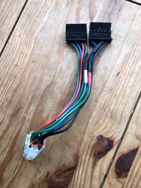

Builder

  1. Yes agreed, it’s because the multiplugs used in the back of the instrument clocks are not the correct ones for the clocks... it should be 2 X 12 pin multi plug that are sided so that they can only go in one way, what I actually have is 4 X 6 pin plugs that fit in any way.... so yes I will mark them in such a way that it can never be put in wrong again.... ideally I will try and find some original Ford multiplugs for the instrument clocks and re-wire them .... anyway I am certainly a lot more wiser with regards my RH....... BEST regards

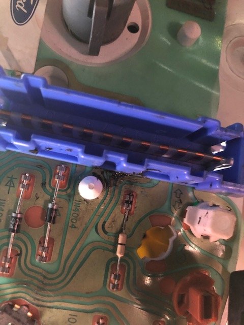

  2. Hi guys, Eureka ..... the 2nd hand clocks I ordered from eBay arrived so I took out the clocks ( which was a 2 hour nightmare) and swapped them over and the car started straight away...... I looked at the clocks in more detail and sure enough you can see where the circuit board behind has burnt out.... I have attached a picture (the break is next to the ford sticker). thankfully I was able to swap over all the clocks from the broken circuit board set and put them in the one that works so I have my original mileage back :)... thanks for all you support guys it was quite a few stressful days trying to work this out but at least I have learnt a lot of things about my car.... also the coil and fuel pump getting its power from my clocks..... who knew !!!!! i just need to secure the multi plugs in the back of the clocks a bit better than the person that installed them previously I also modified the clutch at the pedal end as per your suggestions and I have changed the short clutch cable that someone put in the car and the clutch is 100 times better.... so getting there

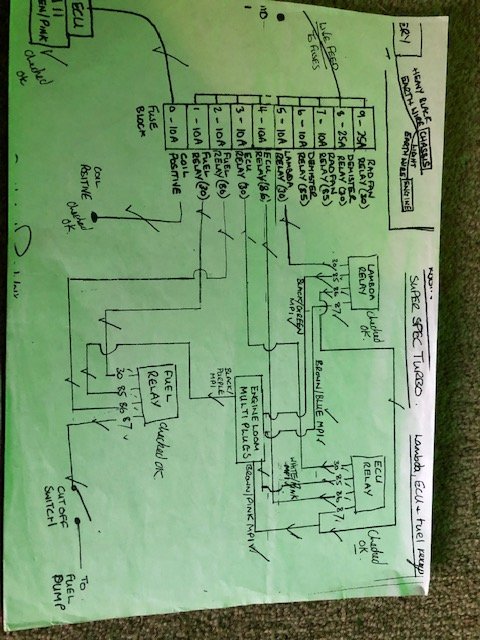

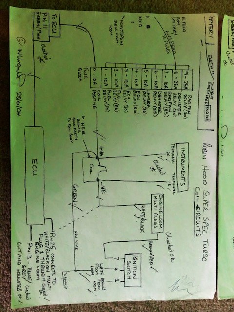

  7. Just found these wiring diagrams in amongst my paperwork, hopefully this should help me diagnose my electrical issues and why the car won’t start..
  8. Thanks guys for all your advice and for taking the time to write down the wireing .... I will check all of these tomorrow. thankyou Keith
