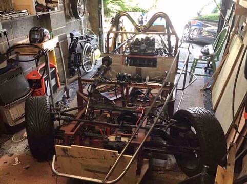

  2. This is the current state. I’m using 20mm steel tube for the body shape to be covered with 5mm ply, one or two layers of glass and a finish of body filler…..lots of sanding! Dave.
