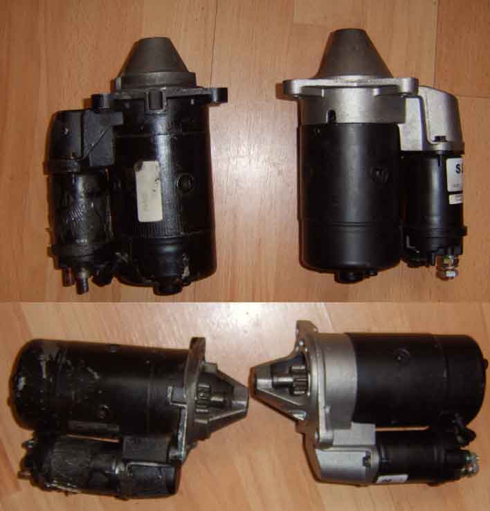

Hi have had a prob with the starter over heating when the engine is hot the exhaust is almost touching the starter motor ( it did at first so re spaced exhaust ) so had to replace the motor i contacted the firm on e bay who sold me a Denso alternator customising it with a different pulley. talked through my prob with heat and exhaust near the solenoid they suggested an item from an auto has the starter mounted on the other side of engine and if fitted would move it down out of the way. this has more amps as well prob was it was longer and would not fit So the customised one for me taking the mount from an auto and the motor and solenoid from a Mondeo which gives more amps with the same size body.
This was supplied the next day with only a £10 extra charge.
When some one is so help full and knowledgeable I can only recommend them They are called Electrostart LINK And Ray is most help full. They will call you back almost straight away after receiving an e mail.
In times of crap service this is great.
Attached photo This is for a zetec fitted to an MT 75 box but i think starter is same on all zetec conversions.

hi ,looking at your post,regarding the starter motor,ill keep the link thanks ,i did notice that you have fitted a blacktop zetec to a mt75 box,what spacer did you fit for the clutch arm to fit ?been looking around and cant find the size req,and gbs mention removing the pivot point in bell housing and replacing with a bolt to take up the differance and its adjustable.
many thanks
jeff
jeff.barlow@sky.com
  • 1 year later...
  • 1 year later...
Guest zerorace
just remove the pivot tap the hole and fit a dome head bolt works every time
